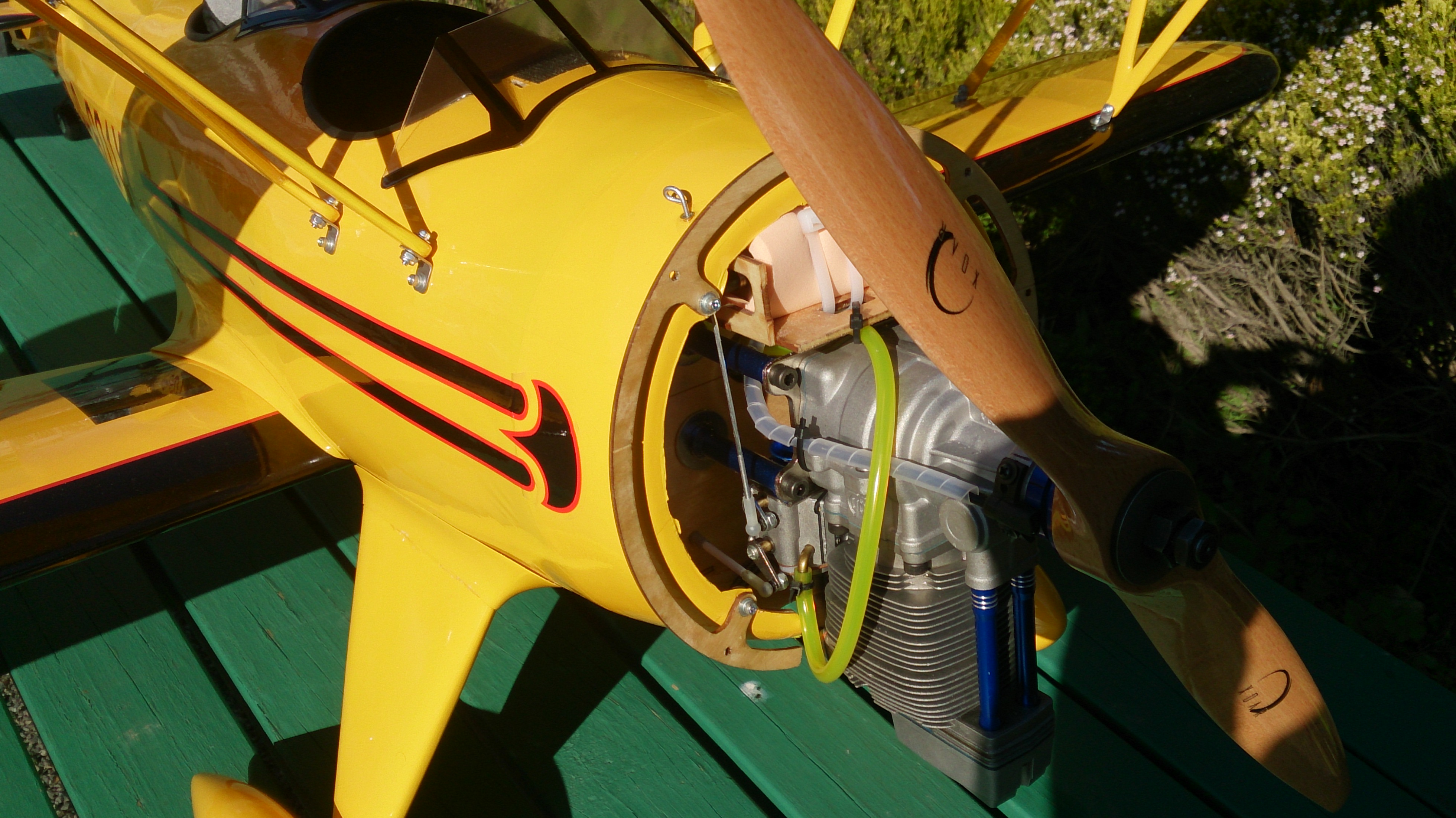

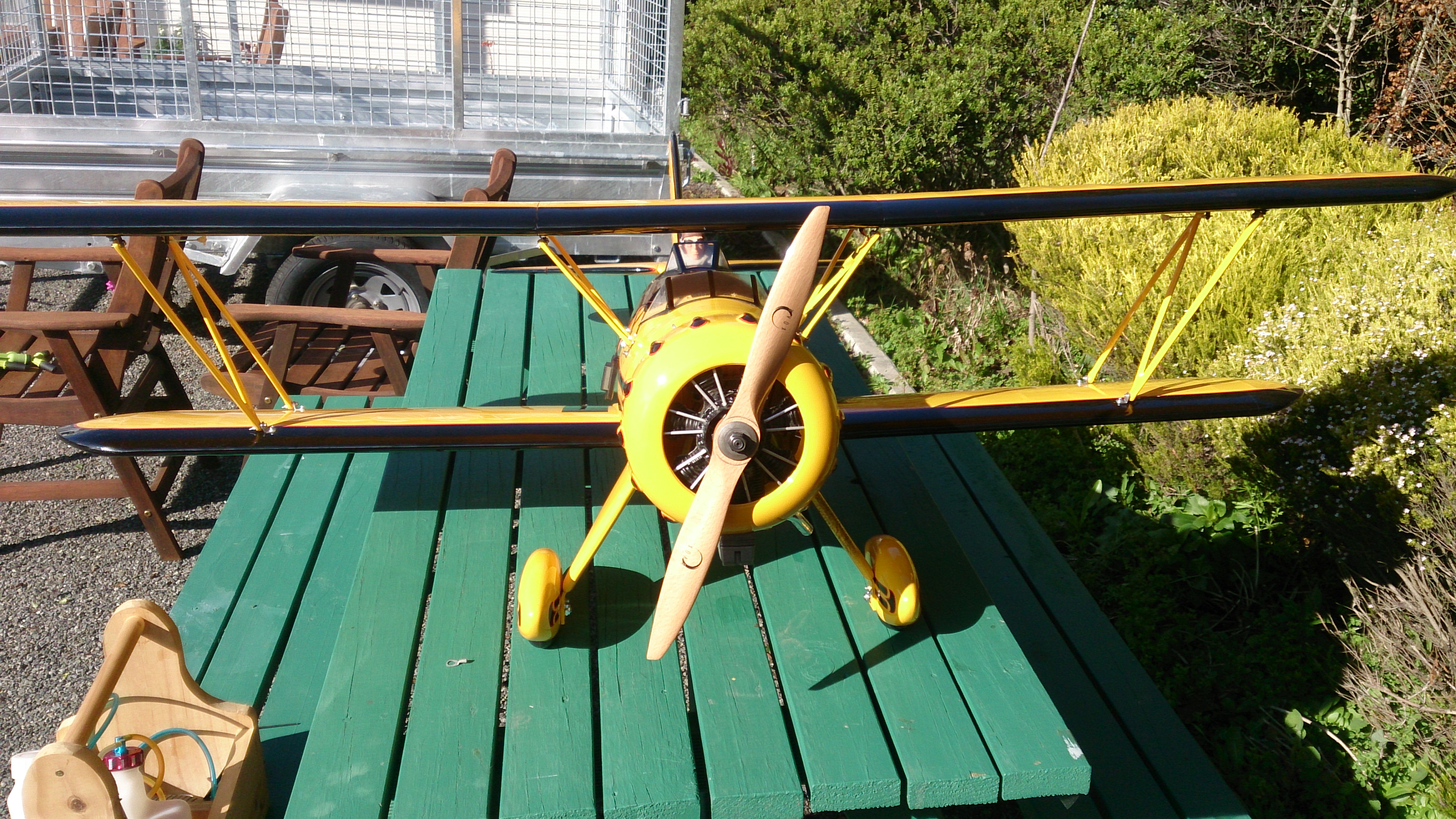

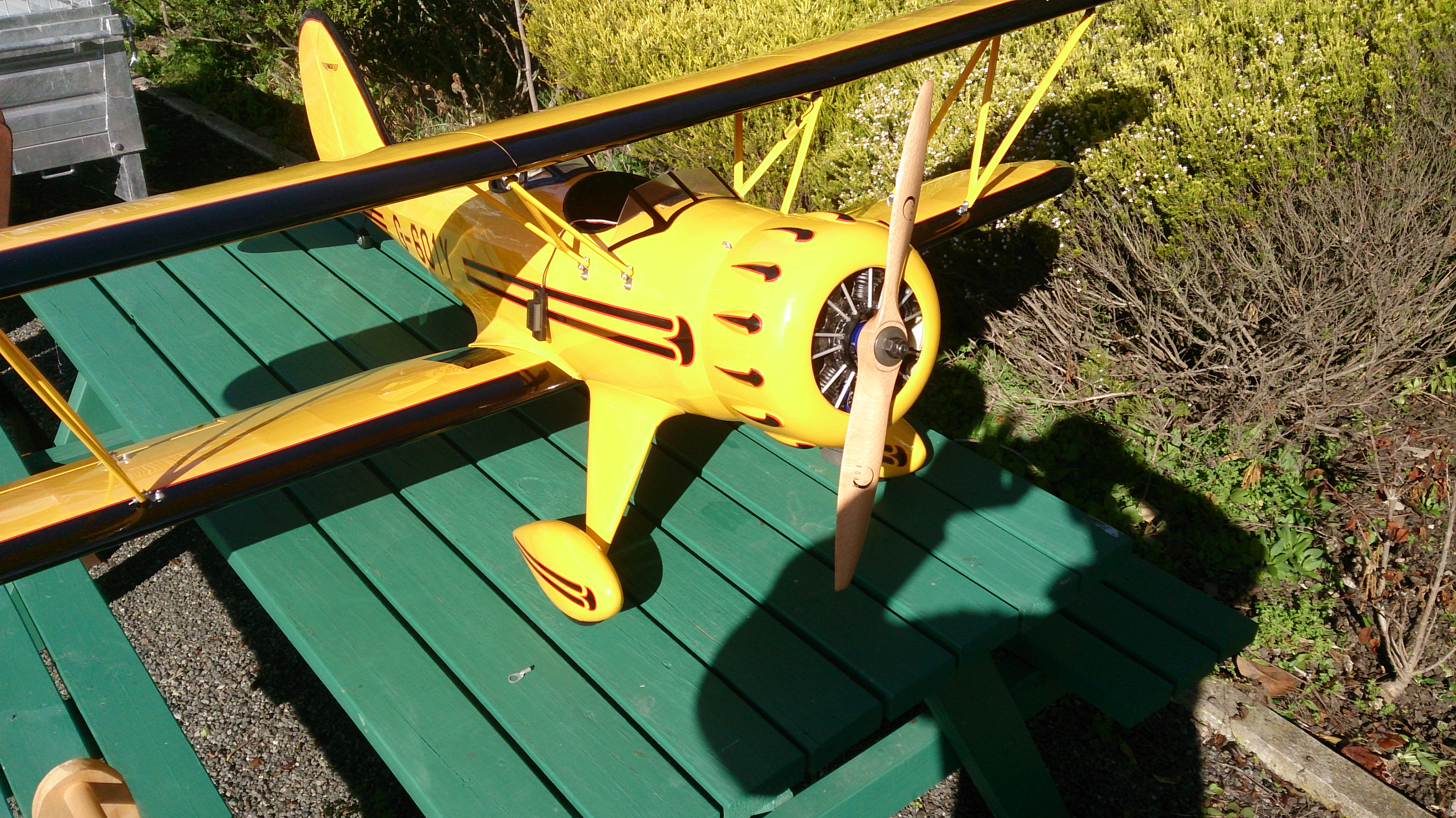

So, got to maiden my Greatplanes Waco with the NGH GF 38 engine fitted. Went really really well!! Needed some nose-up trim, but everything else was just fine. I was expecting it to be a handful on the take-off roll, but easy application of power and some use of the rudder kept it straight. Climbed out beautifully.
Elevator had plenty of authority as per the high-rate setting, have since dialed in a bit more aileron and rudder travel as I wanted more rudder for ground steering and I felt the aileron was a bit slow (but probably scale!!) at the high-rate settings.
Landing was pretty quick, tail stayed off the ground for a long time when landing and when I fed a little elevator in to sit the tail down she became airborne again!! Will watch for that in future.
Really happy with this model!! I have included a few photos of the engine set-up, codedlanguage showed an interest a few posts back. I did not add any weight anywhere, it is fairly well balanced as is. Perhaps it is a tad nose-heavy, but it climbs out fine and is trimmed out level so I think I can live with it. The 4 stroke sound is awesome!!

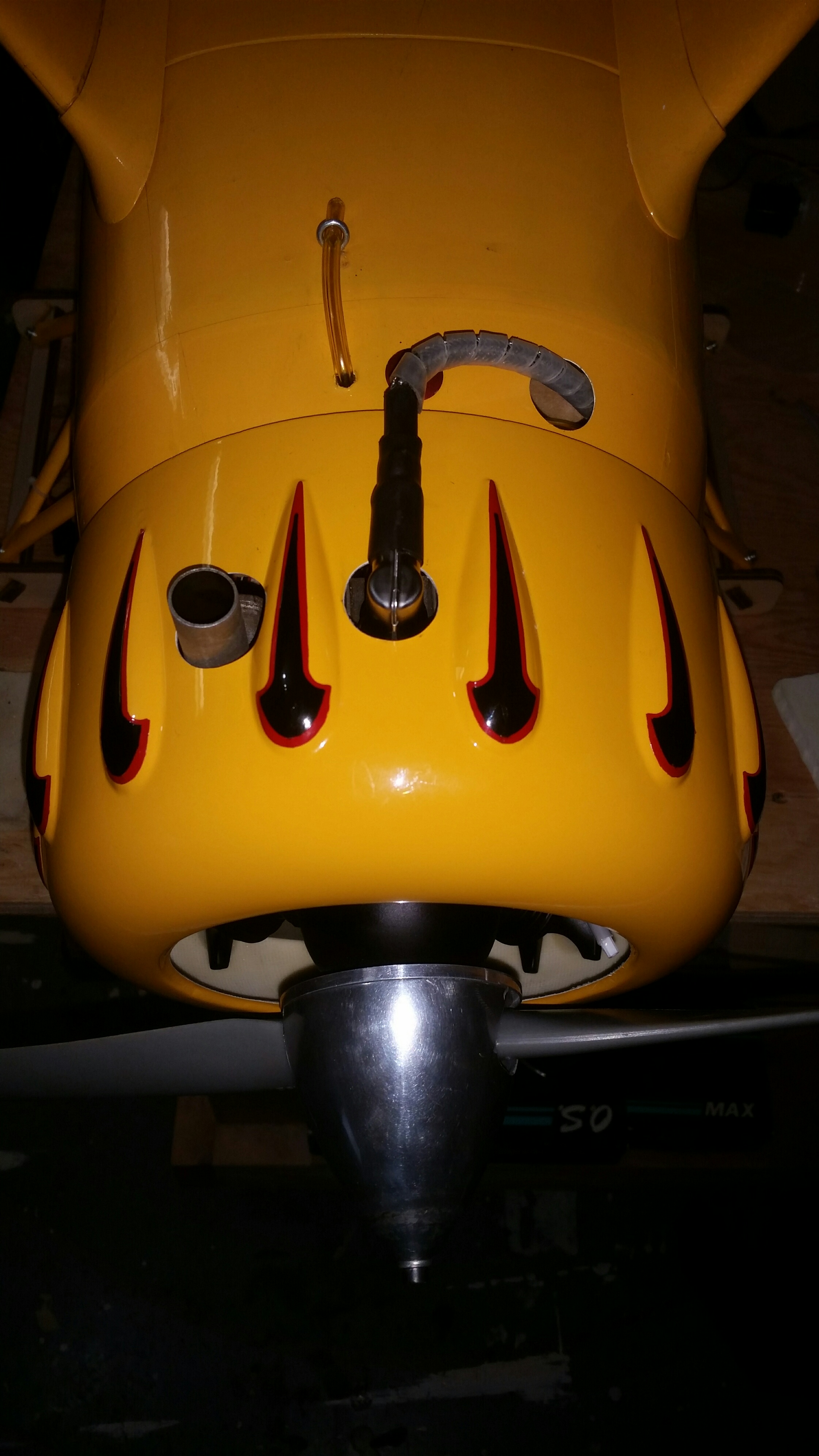

From: Bossier City, LA
I just did my maiden flight in my Waco with a DLE 20 on it swinging a 17-6 APC prop ( going to change to a falcon 17x6). On the first take off roll it went hard to the left once the tail wheel left the ground. I had to take it back and check over a few things but could not find anything wrong. On my next take off roll out I kept a little up elevator on and was prepared for the turn to the left, still happened but not as bad. I had a fair amount of expo in for my ailerons which made turning a pain. But other than that I added a few clicks of up elevator and a couple of clicks of right aileron.
Great flying bird, nice handling and good on landings. My only concern is that my DLE 20 was very warm after my second flight and I am not sure why.I have the same opening on the front as in the manual says but did not add anything at the back. I have a small hole for the muffler and another small hole for the ignition cable. Should I add more cooling on the out flow side of the motor?

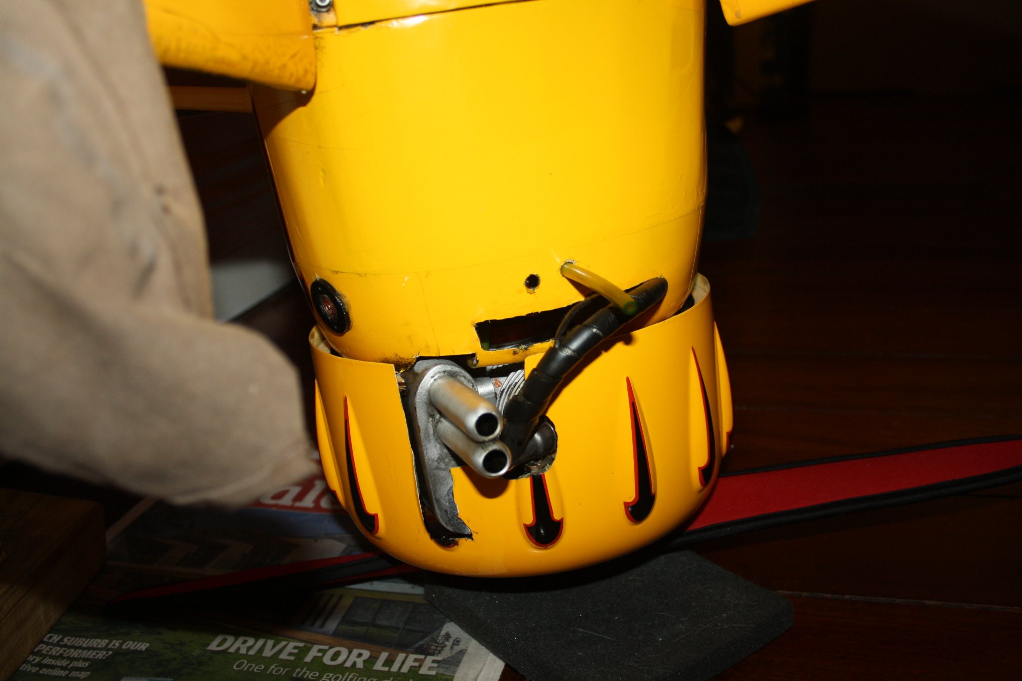

Wolflord - Congratulations for the maiden. As to the cooling, I have 30cc MVVS in my Waco. I discarded the front dummy cylinders and made additional cut behind the cowl (see photos) to allow additional air to get out, as I found the cooling "ring" to be insufficient. This small cut should be enough to resolve your cooling issues even if you keep the dummy cylinders in place (and is hardly visible).
Cheers,

ALFIEV..........I have always wanted to know how that 38 would do in the Waco. I am only flying with a G23, but I love the way she flies. erans.............I have a little more cut out for ventilation out. I also don't have the cowl ring to block the hot air out, I use DuBro cowl mounts. After breaking the ring one day (and ruining the cowl) I changed. The only thing that I have done lately is to paint it Apple Red. Just masked off all of the black trim, scuffed her up with a pad, and shot her with some paint from Walmart. Doesn't look too bad (at least from six feet).
