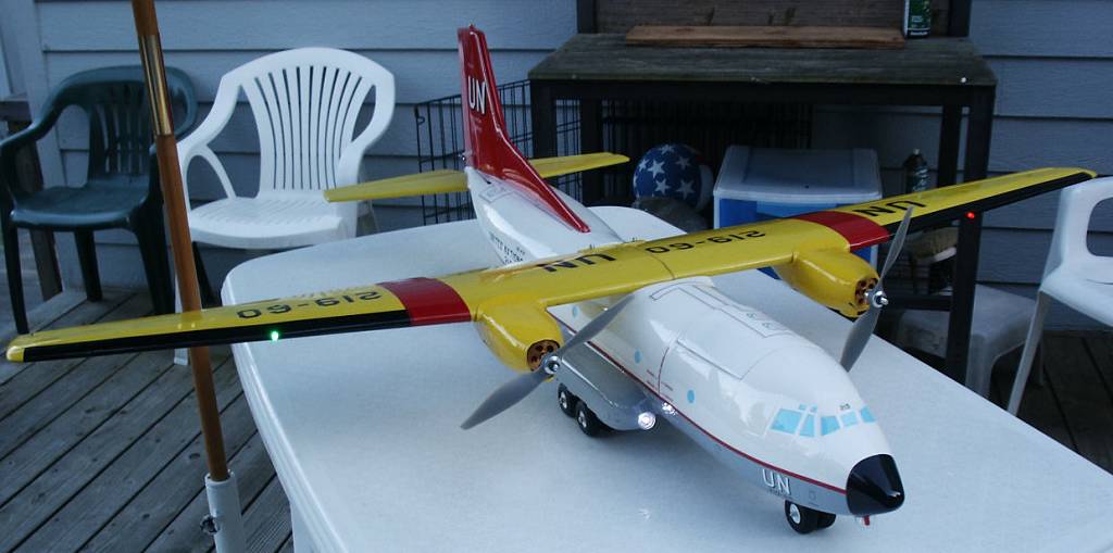

HAVE COMPLETED MY CMP C-160 CARGO CARRIER. HAVE PUT IN THE FOLLOWING
ITEMS:
2 SCORPION S 3026-12(870 KV) MOTORS
2 SCORPION 45 AMP SBEC CONTROLLERS
2 APC-E 9 X 6 THIN ELECTRIC PROPS
1 MAX AMPS 3S 5000 MAH LIPO
FULL SET OF LANDING LITES FROM RC AERODYNE WITH LIGHT
SWITCHES LOCATED ON LEFT SIDE LANDING GEAR HOUSING.
LIGHTS HAVE OWN RX AND BATTERY. BECAUSE OF THIN WING TIPS,
HAD TO MOVE WING LIGHTS IN ON LEADING EDGE OF WING SO AS TO NOT WEAKEN WING.
WEATHER HAS BEEN VERY COLD, WINDY AND WET, AND HAVE NOT FLOWN PLANE YET.
HAVE ATTACHED A FEW PICTURES. BEST, LNL
