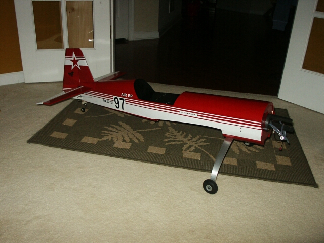

I got mine in the air 2 days ago. I'm still in the process of breaking in a new engine so it was a bit interesting to say the least. I got it fired up, still running pretty rich and just kinda running funny (its a TT .91) I've heard they run fine after getting broken in. Anyway I got it up the first flight and all went well. Just did some circles in the pattern, one roll. The plane tracked straight after some slight trimming. I was real pleased with the simple flying I was doing. The engine was acting a tad weird though, which I wrote off to being new. It sputtered if I gave it too much throttle and just kinda sputtered some throughout the flight. I made a one wheel landing after 5 or 6 passes...it just didn't want to come down! Refueled, got it back in the air and it just wasn't acting right. Maybe I just wasn't flying fast enough, it wasn't reacting the way it did on the first flight. The engine was REALLY wanting to die this time. I just wanted to get it back down before the engine died and I dead-sticked it into the field. I think I just need to get the engine worked out and the plane will fly great.
ID:	61765   Click image for larger version

Wow, looks awesome, Frag! Thanks for the pics. Very nice touch with the 3 blade. Hope you can get the TT running straight before flying.

Flew the Sukhoi today. The engine is running much better now that I've got 3/4 gallon through it....after trimming, it flew great straight and level flight. I had to put low rates at 25% for ailerons because at 35% they we kinda touchy (to me anyway). I've noticed a couple of things. Most importantly, when I give full elevator, it drops the right wing! Pretty scary when you're not expecting it! I mean go to do a loop and flop way right 1/3 of the way into it! The other thing is that the hardware supplied to attach the control horn to the surfaces tend to crush the surrounding wood from the pressure of the control surface against it. Maybe wider washers would help with that. As far as the right wing dropping when given full elevator I'm open for suggestions- Overall I still really like this plane and am looking forward to getting the bugs worked out so i can really dog it out!
