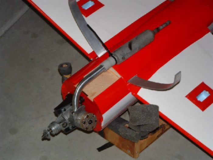

I am also building the VF Sukhoi. I am installing an ASP .91 engine with a half-wave tuned pipe(similar to a mousse can muffler). The trick is to rotate the engine so that the exhaust header is lined up between the landing gear legs. I had to buy a "long" MAC extension header to clear the bottom of the belly pan. I also used a different engine mount than what was included in the kit. I have included several pictures of the installation.

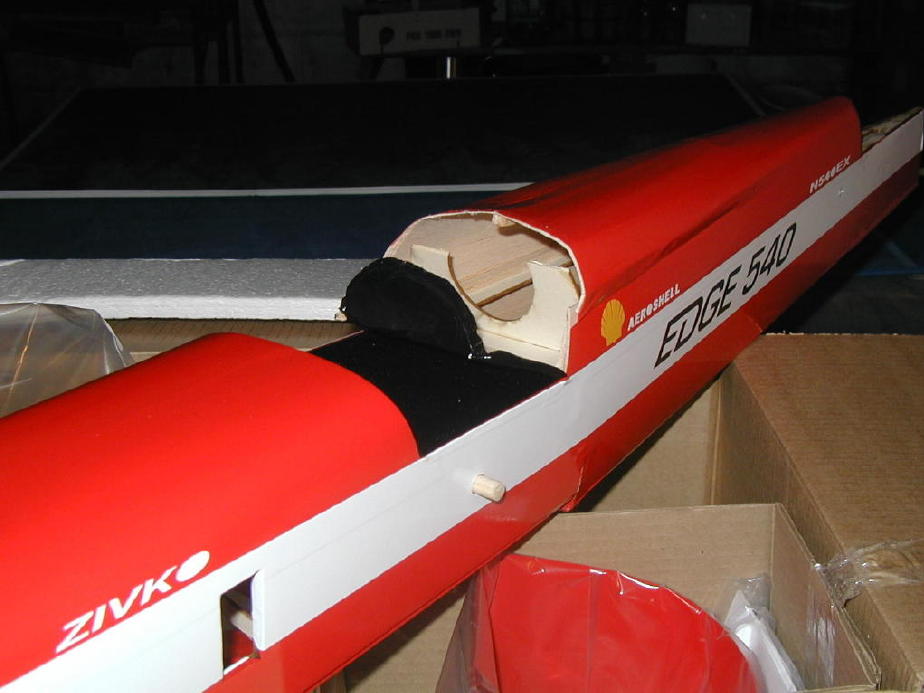

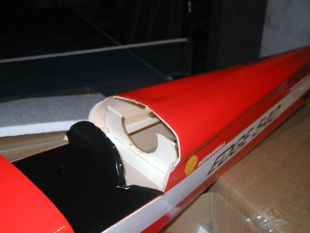

I am glad they gave you good service, I ordered a edge and they shipped it UPS and it arrived with the fuse smashed from the front to the back, It was clear UPS dropped something heavy on it. Well they said they would replace it and would ship the new fuse out monday. Well it has been over 3 weeks and still no fuse. I e-mailed them 4 day ago and got no response. If I don't hear from them I will call them and ask what gives. I can understand them being busy, but when you promise to ship the fuse right away and don't it makes me wonder what they are trying to pull. IF it was going to take 4 or 5 weeks to replace it they should have said so instead I sitting here wondering if they are really ever going to do what they said. I hope so. They also said they was going make a claim with UPS and that UPS was going to contact me as of yet UPS has not contacted me and that also makes me wonder it something isn't right. I hope so.

Sorry to hear about your exp Waco. As I said, I only emailed them once and to date have recieved 2 phone calls and 2 emails from them making sure everything was to my satisfaction. I wonder if your email is getting lost somehow?
As far as engines, I am installing a Saito 91S and used the supplied mount. Installing it in the second set of predrilled holes in position that places the muffler straight down so I wont need to modify it.
I noticed the coloring on the belly pan and servo cutouts on the above picture is red..mine are both white. Wonder what's up with that?

Hey wazted,
Regarding your color qustion, ask VF. Email them. They respond within hours.

Hey Waco, I'm trying to figure out how the fuse got crushed. I've got two planes from Vector, and they were both packed so well, it would have taken a car engine to crush the box. And to get to the fuse, just about everything else in the box would have to be destroyed too. I have noticed at work, that UPS has been a lot more sloppy with their handling of packages lately. Maybe they're getting ready to ask for a raise! Ha! If I were you, I'd be more pis_ed at UPS than Vector Flight.

540 damage
here is the damage done to the edge by UPS, The only thing in the box to keep it from crushing the fuse was a 1/2 in piece of foam board which got crushed too. Vector flight has contacted me and said they would ship me a set of wings and fuse and tail feathers since they changed the color scheme on the edge since I had gotten mine. I will be waiting for it hopefully it will show up in the next week.

540 edge damage
here is another picture that shows it better. I order two planes from them at the time, one came priority mail with no problem and this one came UPS with damage. why they decided to ship this one UPS I don't Know. Vectorflight seem to be good at responding to e-mails but slow on shipping must be overloaded with orders. IF they come through with what they promised I will be pleased even though It has been almost 3 months since I order this plane. replace the plane at no cost to me. Not bad if they come through.
