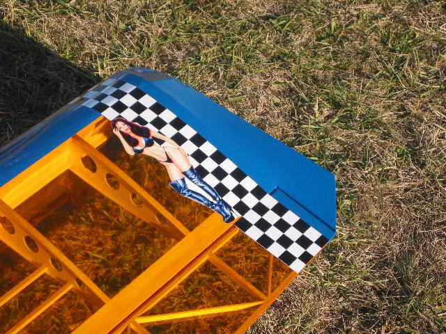

Hey Michael, Is that a new stock color or did you change it? After reading the mixed comments here, I think I might have to get one of these anyway. I have a YZ FZ.91 that is not doing anything right now. I think it would be a good choice for this bird.

Try it you will like it. No that was the color that it came in I was surprised at it to in the ad
It look yellow not orange but I have got use to it I did fancy up the wing tips a little I have a friend that make decals and this is what he did I sure I will get good and bad comments but check it out. But I don't feel you will go wrong I started flying mine on duel rate like they said
And then I just change it all to full out slamin rates with 70% differential and that works for me
If you get one let me know how you like it
