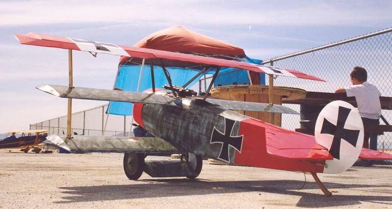

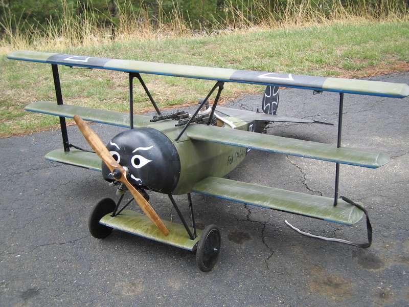

Here is my Balsa USA DR-1. Saito 180 with 20-6 prop. Flies great . Easy to take off and land. Still getting used to the weather vane characteristic. Makes it tough to keep lined up with the runway. Solortex covering, handpainted with custom mixed house paint from home depot. I have around 10 flights on her but I have to say I still get nervous asI am used to flying the smaller ones!
