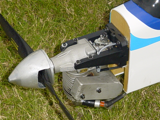

Well, im taking the step of possible new ground & puttimg a dle20 in myucando 60 & Lord willing it will be a match. Its fitting inside the cowl pretty good as a matter a fact. I have to cut a little out for the muffler & maybee a tad for the plug but it appears its going to work. I just got started tonight. Ive got all the hinge slots about ready, ive got the horizontal & vertical stabs epoxied into place. I didnt want to use the factory settup. Ive even got the pilot ready, its the diggem smacks frog!! Ill try to post pics when i can.

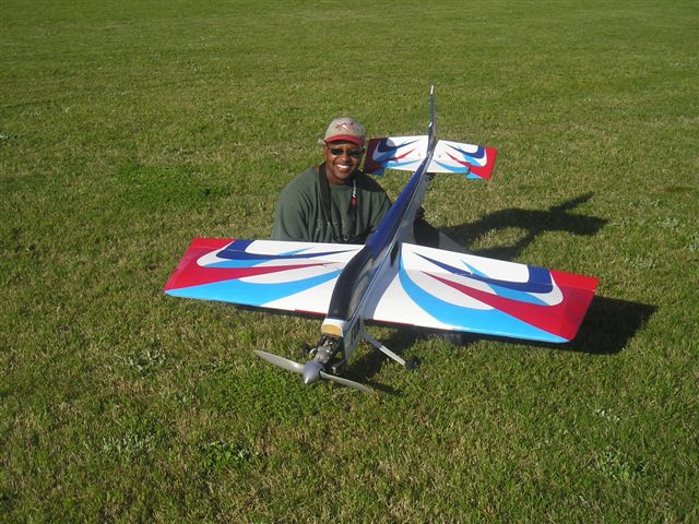

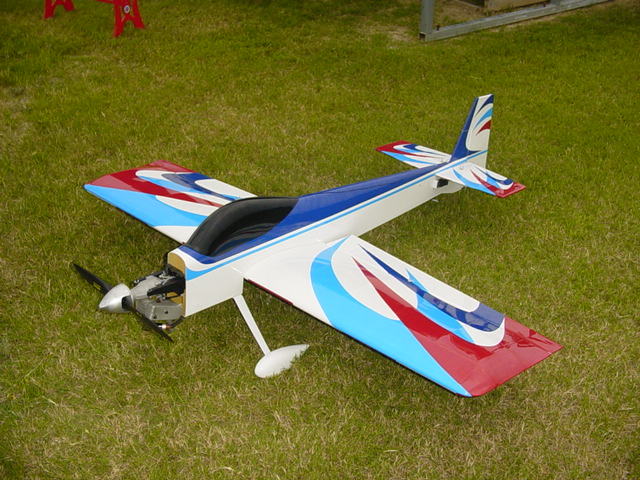

Posted some pics.

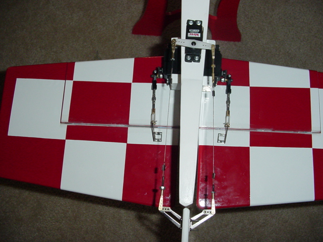

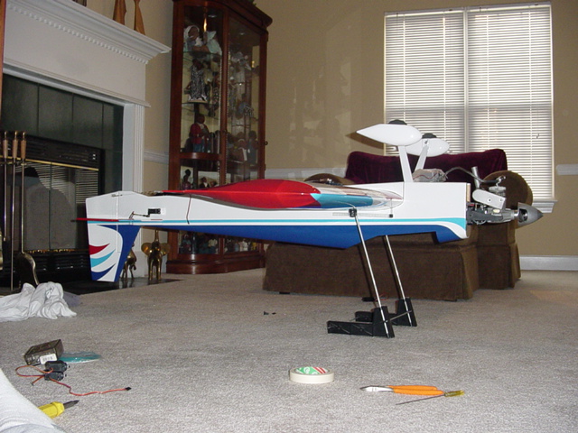

great job[8D]
looks like u r running 2 switches are u also running 2 batteries?

Yesir two batteries. Im still using nimh & nicads. Yours looks good too, or better actually.
2 1/4 oz @ tail to balance. And a very little tail heavy which i prefer on these types of planes.

Where do you have your rx & stuff?
Old 04-20-2011 | 05:37 AM
My Feedback: (31)
Posts: 7,415
From: Kannapolis, NC
Default RE: U-Can-Do 60 build, intalling a DLE20
The receiver and a nhmi where located in the rear. I cut a hatch for the battery to mount in the rear for balance reason. I no longer have mine those are just pic of the girl when she has good legs....[8D] I lost mine in a tail slide when i ran out of gas T-rolling for quite a long time. I think it just got to good to me. The U can do is a strong T-rolling plane. I think that is all i use to do with it as it did that move the best......i think mine was just less than 8 1/2 lbs with all nhmin batteries on it. I am putting together a Showtime now that has been sitting in my hanger for quite some time after the YS-120 blew. I am mounting a DLE 20 on one battery. I should have it ready to start up later on this afternoon...... I am running it on a fromeco regulator with 2 leads so that I can run one battery on the entire set-up....

I'm having difficulty mounting the engine on mine, but yours looks great in the pictures. Did you have to modify your engine mount much? I'm finding the engine just a bit too wide for the included mount, and the throttle levers are impeded by the back of the mount.
If at all possible could you snap a picture showing closer detail of your setup?
