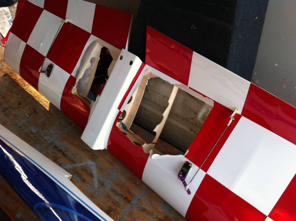

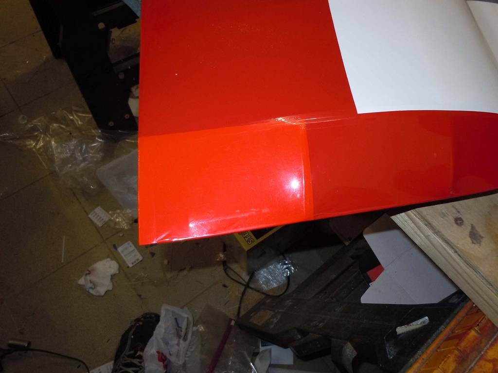

I had to do a wingtip repair from shipping too, and I know another guy who had the same problem with his. Seems the box isn't adequate to protect the plane.

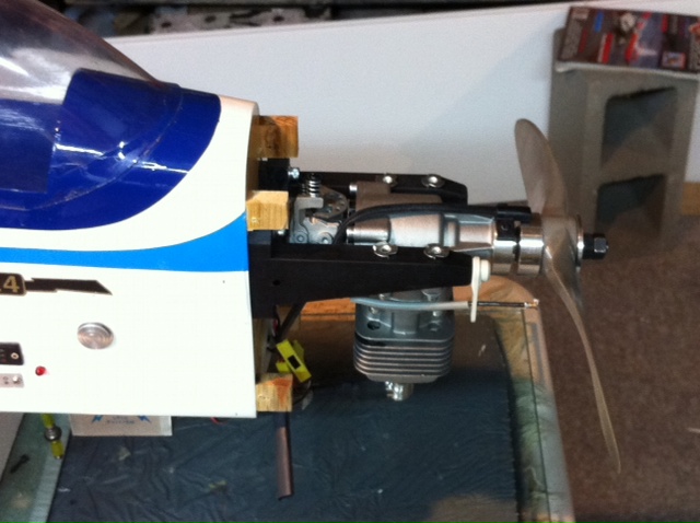

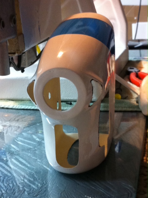

well that was all that was the problem for now , the dle 20 looks awesome in the plane i have a Zenoah 20 in a grupner ultimate but the dle looks better more bad ass.

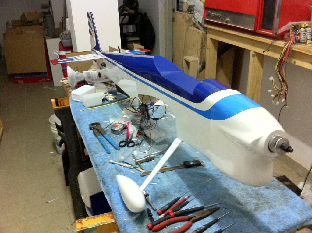

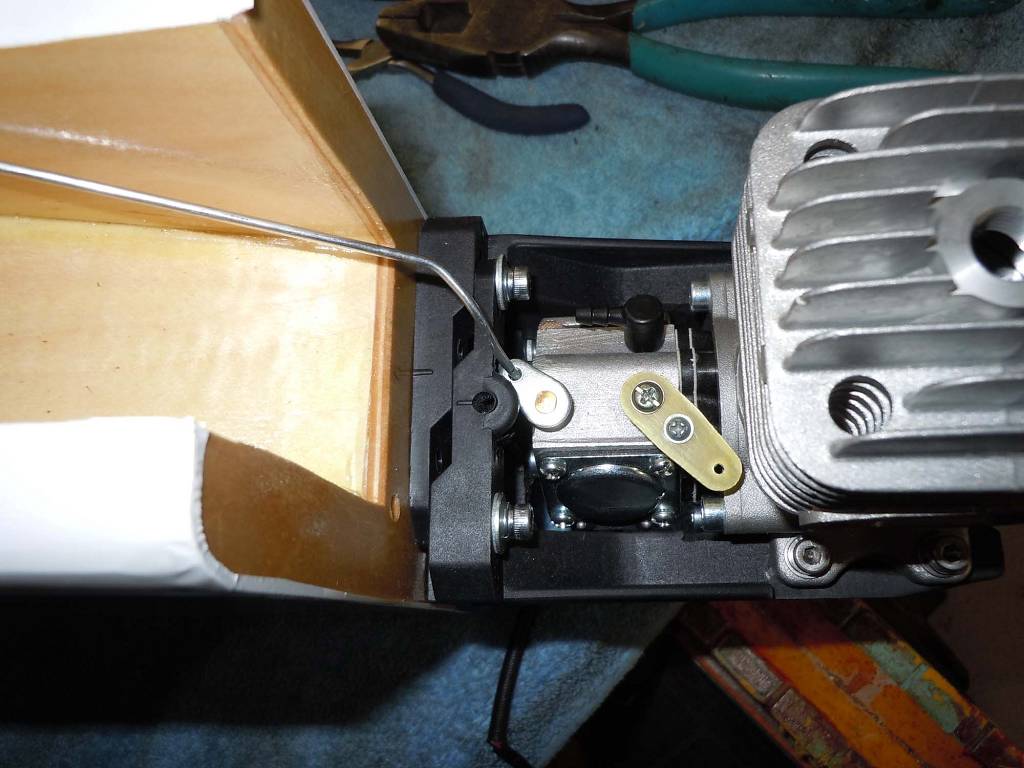

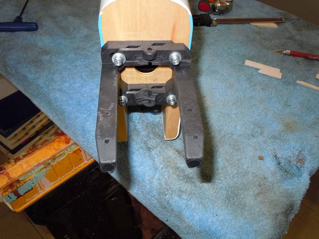

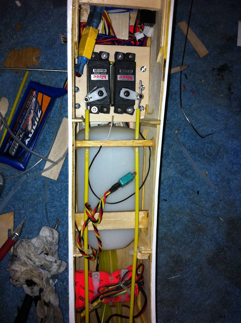

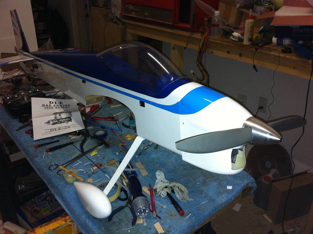

well here go the pic again

Thanks for the pics, now I can see what I have to do.
Good idea installing the choke lever toward the back.

LOL, I had to repair the same section of the wingtip. I used a little light weight cloth and resin to strengthen the broken wood, and used red econocote to cover it since that's what I had on hand. Looks exactly like yours.
Too bad the color wasn't quite right, but didn't want to wait 2 weeks for red monocote to come in the mail.

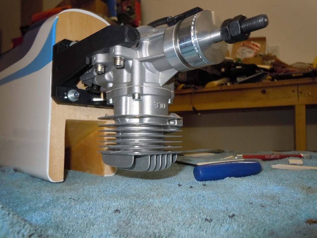

I dremeleled a little off the inside top of my mount to make the fat block fit but i think i may have used a didferent mount too but its a pill to dissassemble lol

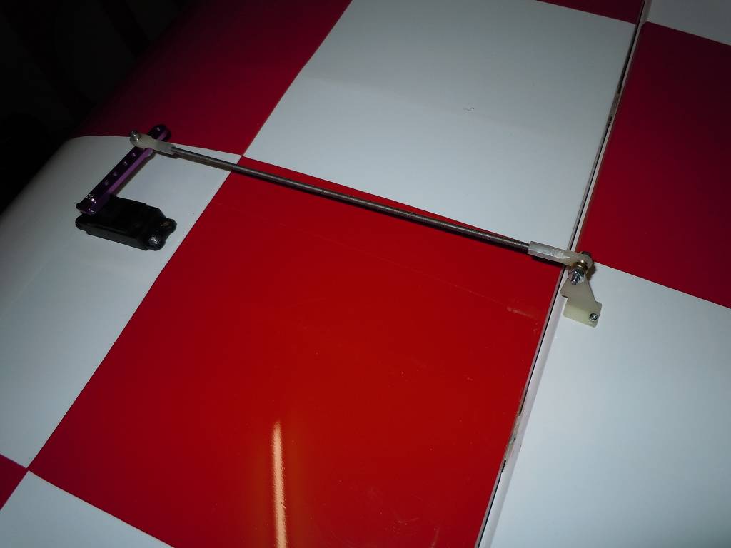

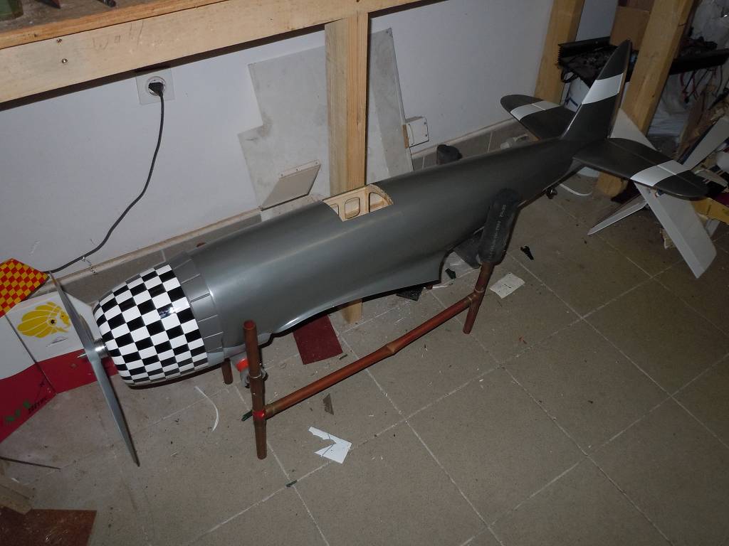

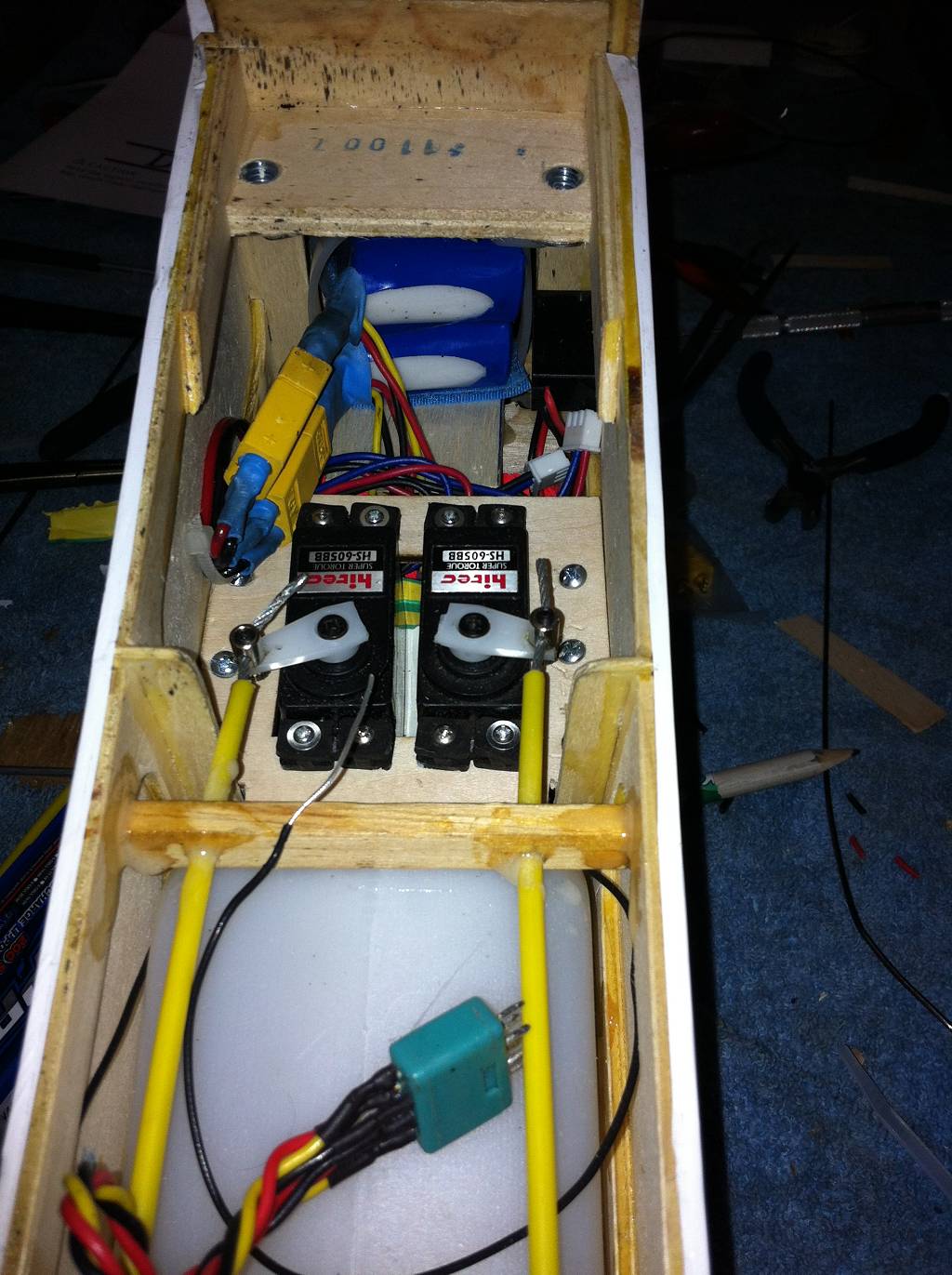

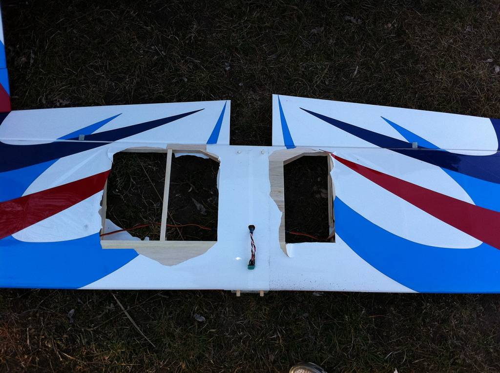

here is a pic of the aileron i did i did not like the skimpy 2-56 wire i had some threaded 3mm and dubro 4-40 ball links’ am waiting for some control horns but it takes time to get it here ,can’t think of everything ahead of time. here is pic of what I put off to finish my u can 60. I have time for the p47 for better weather.

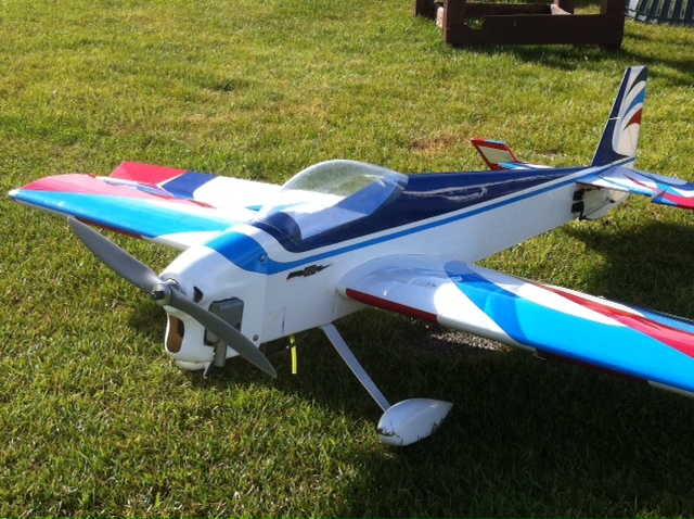

Here are some pics of UCANDU with the dle 20 with a 17/6 apc great flying plane

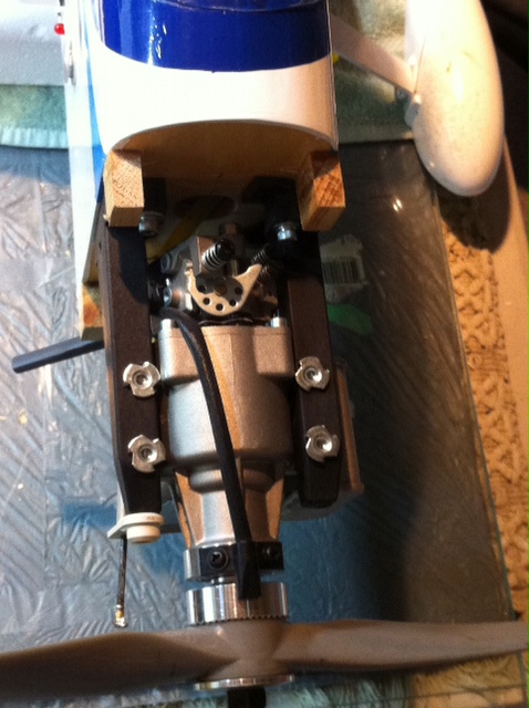

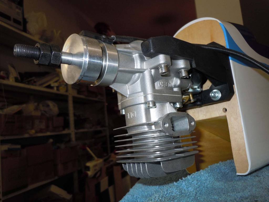

here is a larger link I had to cut the tabs out of the stock motor mount to clear the adjustment needles

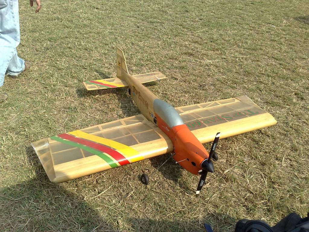

Can the UCD 60 really take a DLE20? I have a Phoenix version of that- Topstar 60 and I flew it last year with a FS91SII. I really worry regarding the vibrations, flutter and about damaging the airframe on every landing. Plus this airplane really doesnt want to land even with the FS91 so I am not sure what the DLE20 will do to it. Pic is attached

will work fine ,a perfect fit , a bit over powered , but need to do throttle management not to go to fast, motor started with a few flips and reliable idle with my new not broken in engine yet . With my u can do 46 and gms 61 always glow plug problems with not so good nitro fuel in Croatia , gas is simpler and easer and a hell of a lot cheaper here.

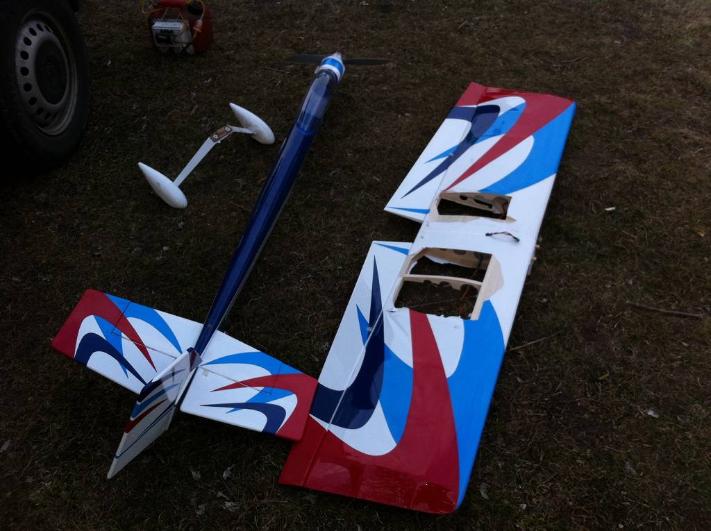

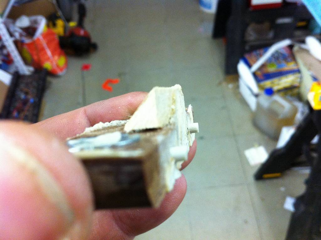

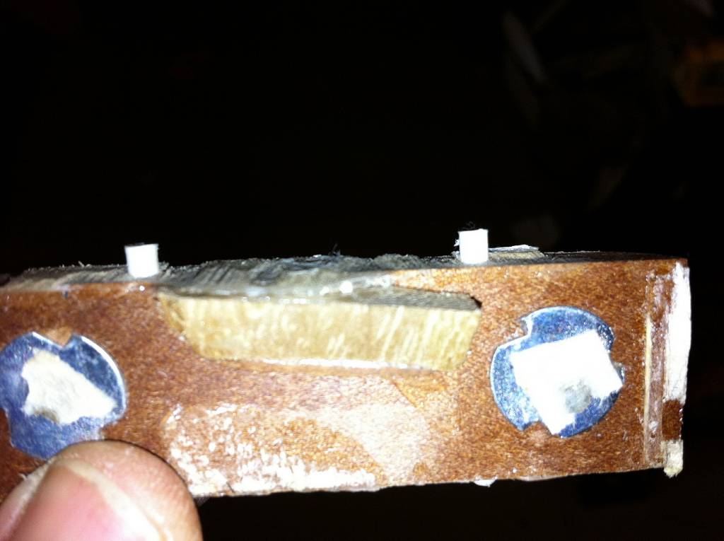

Well i maiden today , but the second flight was not so good coming for a landing i did not judge the field to good and landed a little short , a farmer shorteng one side our feild about 45 feet and i hit mound in the ground and ripped off the landing gear .i am the third person to do that after our field was shortened , i found that the triangle blocks were not glued in square above the landing gear, but now i will glass epoxy then in so now more failures , but for the most part it flew grate , I bit on not consecrating will cost a few hours of repair.

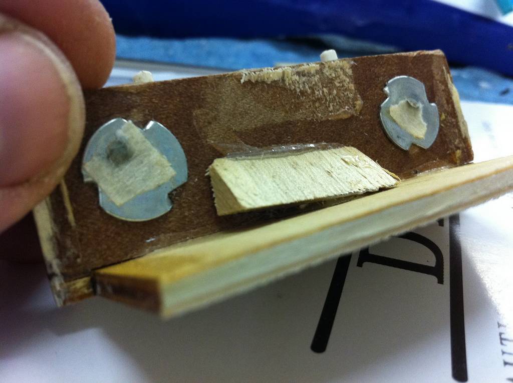

I started to work on the plane today after cooling down a few days . I know i should have reinforced the landing gear , but I did not know how bad it was. until I started to put it back tougher today , the triangle stock was not even close to being square there was a gap about 2 mm on one side so no support at all . and the ply with the two hole where the wing dowels go into did not have much glue at all to hold it to the side fuselage where you could see where glue was missing from the inside. so the side walls spread apart and then the hard wood with the landing gear just came out. so for everyone else glue the landing gear block from the inside.
