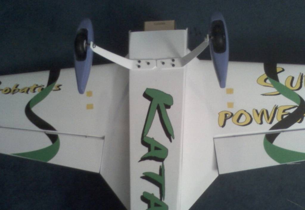

I'm not kidding. With nothing else installed I have to hang the engine out of the front of the cowl to get it to balance at the recommended range. when I start adding servos and linkages to the rear of the plane it is going to get real bad. I could move all of the servos under the cowl and add 15 more and it still wouldn't balance with the engine inside of the cowl.
ORIGINAL: Bonified Wingnut
Are your battery packs on the engine mounting block?
Don't add servos to the rear of the plane. Do as I indicated above.
Remember that 1-2oz on the tail may be the equivalent of 8-10oz+ on the noze due to the different lever moments.

I understand what you are saying, I have been building flying models for 37 years. I understand where the CG should be. I uploaded pictures to show where I am attempting to balance. Right where the plans call for.
I have not installed anything in the plane yet. So to demonstrate I put all of the electronics: batteries, servos, tank, prop, spinner, extensions, switches, bec, and everything else I intended on installing in the plane and put it in a bucket. If I put that bucket with EVERYTHING going into the plane on the cowl it will balance. There is no way that I can put everything in the cowl. there will be more weight in the tail no matter what I do. So even if I put half of everything inside the cowl I will have to make up for that and whatever additional weight gets put into the tail. The bucket weighs about 4 lbs 13 ounces total, and about 30 ounces without the engine, prop and spinner. So I need 30 ounces of weight in the nose with nothing in the tail. Whatever I could not jam into the cowl would have to be made up by lead and whatever gets put in the tail times the moment arm will also need to be added as lead. If I move the engine forward the servos go where they are supposed to and no lead gets added.
In the picture you have everything in the bucket sitting on the cowl.
With the engine installed it will actually sit a few inches forward of where it's weight is distributed via the bucket.
So it is likely you will need less actual weight to get things to balance. Maybe a few ounces less, but that may be offset by any servos in the tail, which I'd advise against.

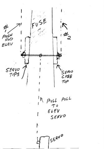

There is a simple device you can buy to have the elevators pull-pull. you will end up with no servo weight in tail. You could make you own even, if you seen one. I will try to find a photo of how the set-up looks and works. Capt,n

ORIGINAL: captinjohn
MORE...Drawing on possible do it youself pull-pull for elevator ! Look at Drawing.
That would be extra work on this plane. It has a different elevator servo mount.
What you have is perfect.
You can slightly modify the servo cover to become the pull-pull exit. Just don't feel you need to over do it.
Also remember that moving 2oz off the tail removes the requirement for 8+10oz off the nose.
The lever arm moment of that long tail has a dramatic effect on small weight offsets.
The Pull-Pull is worth doing.

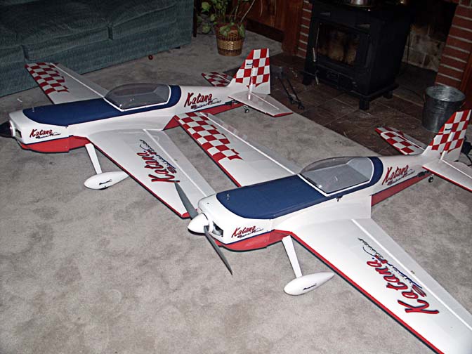

In the early days of this Katana 140 ARF there were issues with the CG but nothing as extreme as what has been posted in this thread.
I bought two of them back in 2003 and assembled them stock out the box and didn't add any weights to balance them. The three Futaba servos that I used in the tail were lighter than the heavier Hitecs that most people were using. The engines were OS 1.60's with Bisson Pitts mufflers.
If it will help, I'd like to state that my CG was located at 135mm back from the leading edge and both planes were very good aerobatic fliers.. The instruction manual specifies a CG range of 110 to 130mm at a distance of 150mm out from the wing root.

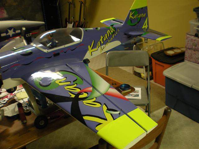

A little late, but here are the photos of the trim sheet look. It really made a huge difference in being able to see the top of this airplane, and the fl. yellow didn't look out of place with this color scheme. The 3rd photo shows the landing gear I added, quite beefy, tall and wide. The last photo is my SPE40 gasser I just tore down last night. Had to buy a gear puller today to get the old bearings out. As soon as I get some Loctite 620 bearing adhesive I'll be ready to assemble. As long as your cg is somewhere around 4-6" back from the leading edge at the indent you should be fine. Fly and adjust to the way you like it to fly. Let us know how it goes! DG
Thanks F4U for the pictures. So you added trim to the top to make it more visible. Is there any lead in that plane at all? And if your not tired of questions is the thrust angle changed any other than what is built into the motor box?

No problem with the questions. No extra lead anywhere. Mine has 3 metal gear servos in the tail, SPE40 on the front (approx. 52ozs.), 1100mAh A123 ignition battery inside the fuel tank compartment, and 2300mAh A123 rx battery between the fuel tank and wing tube supports. 13.5 lbs. with super beefy landing gear, and no fuel. No change in thrust angle, just used the fire wall as is. Yes, trim sheet added to make it more visable. It's really blends in with the sky on top, the white bottom is ok.
As you can see, your DLE 30 is about 18-20 ozs. less than the SPE 40 I'm using, so you may end up needing to add extra lead up front, or moving the tail servos as suggested by Opjose. If you haven't tried it yet, move your batteries to the sides of the motor box and see if that helps get more weight up front. Let us know how it works out for you. I hope to get mine back in the air later this week if the winds get slow down under 20mph[>:]. This is my first gasser, and I'm really impressed with the ease of starting, no oil slime all over to clean up, and the stability of this airplane in the air (low rates). It spins as fast as my delta wing on high rates. You will love it! DG
