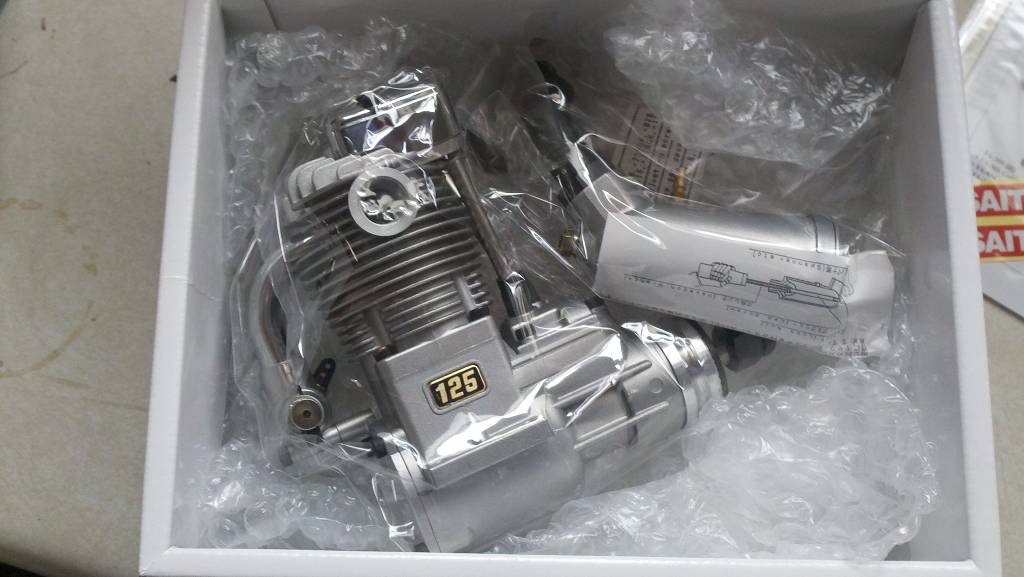

I just ordered a ucd 3d size .60 with a saito 125 fs , My rx im using is a spectrum 8000. What servos would be good for this plane?

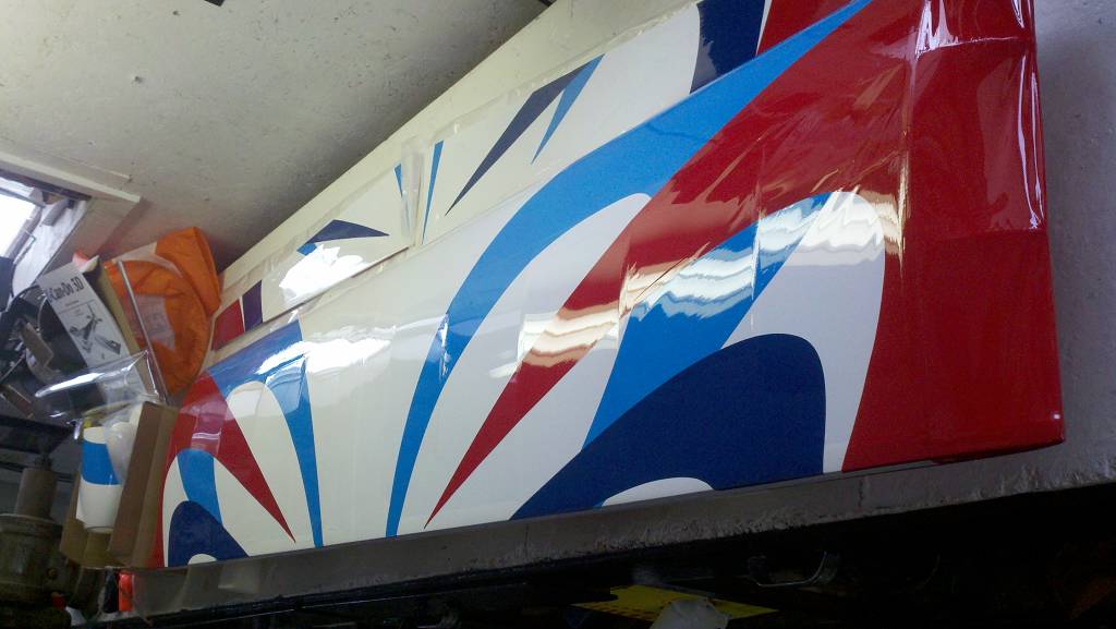

Well I just got mine delivered! I will upload some pics later. The servos and hindges will be here tomorrow. you say you installed toothpics on the firewall? how did you do that?

<font size="4">When I got some of the parts out,I found the cowl was cracked on both sides. I called Great Plains and they didnt question it at all. So they are sending me a new one.
