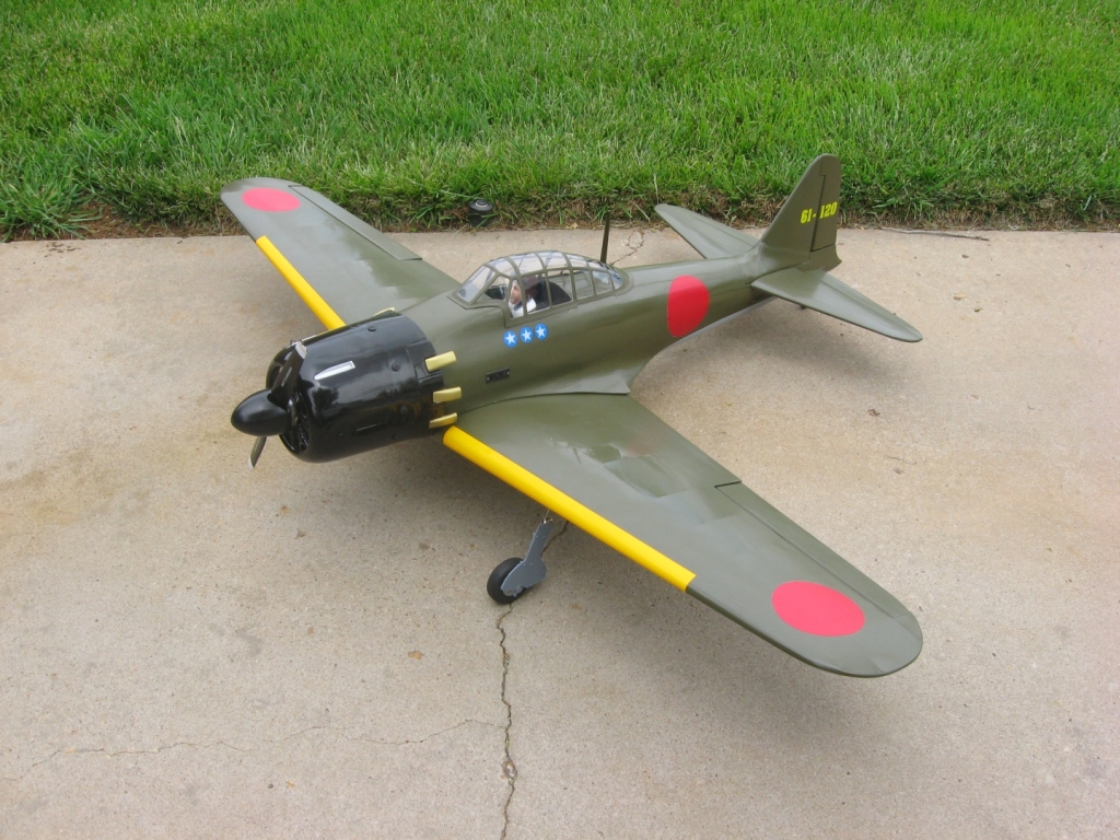

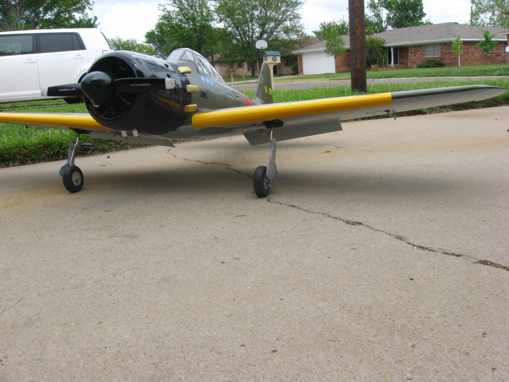

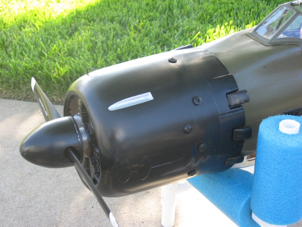

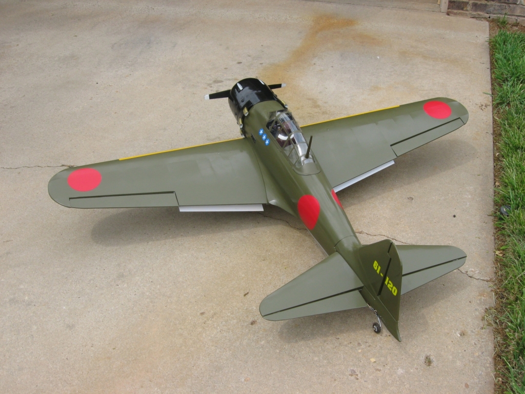

My Seagull Zero is ready for the maiden flight. Just need the weather to cooperate.
The engine is an OS 108 FSR. The plane weighs about 10.5 lbs. This includes about 6 oz of lead in the front of the cowl and another 5 oz over the motor box.
I felt this ARF needed some extra work and took about 40% more time to assemble than other warbirds of a similar size I have done in the last year or two. If it flies as nicely as reported it will more than make up for extra work.
After glueing the exhaust ports on the fuse I decided they were too big and bright (garish) as compared to the full scale. I cut off about 5/8" off each exhaust and put a coat of flat black on them. The pictures show the difference.
The full scale Zero pictured here is from the Planes of Fame Museum in Chino.
Brian

Hello Brian... is that the spinner provided in the kit?
Thanks!
Curt
Old 05-07-2015 | 04:30 AM
  #31
aghost's Avatar
My Feedback: (13)
Joined: May 2002
Posts: 1,240
From: Amarillo, TX
No. It is Skyshark's spinner for a FW 190A8. I painted it black. Close enough for me. The stock spinner is a pointed red thing. Don't know why they even bothered to include it.
Brian

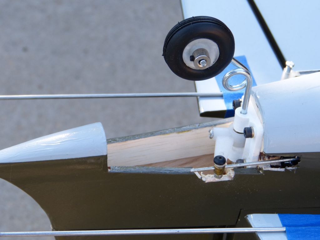

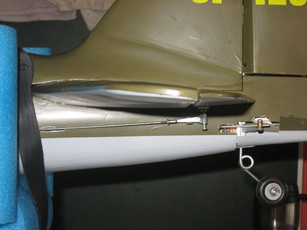

Working on the tailwheel / tail assembly today. Does another hole need to be drilled in the tail wheel control horn? It does not look like the clevis will reach/ connect to the horn. The current alignment does not look like its going to work.
I also am having to shim the tail wheel bracket as the rod going to the rudder binds when the attach screw are drawn tight.
Just curious if you all worked around these defects?
Old 11-22-2015 | 07:53 AM
  #43
aghost's Avatar
My Feedback: (13)
Joined: May 2002
Posts: 1,240
From: Amarillo, TX
I did have (and still have some) binding problems with the rudder/tailwheel. Not totally happy with my results, but it is working reasonably well. I did not have to shim the tailwheel bracket.
As I remember on left rudder, the clevis hit the tailwheel support or the fuse. On right rudder the pushrod hit the tailwheel support or the fuse.
I put in a new pushrod and ran it through a brass connector on the rudder control horn. The connector is at the end of the control horn to get the pushrod as far away from the tailwheel support as possible. Still had to cut and hack to get clearance. See the pictures.
The left rudder throw is not quite as far as the manual calls for. The right rudder is maybe half. That's the part I am not happy with.
