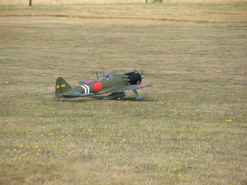

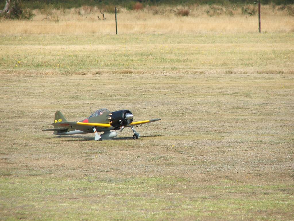

Here are some pics of mine. Its not very scale out of the box, throw away the decals, spinner and the pilot. And then start from there, also the covereing is to glossy, so a matt clear finish was applied. Mine is powered by a Saito 125a, witha 3 blade prop and a Tru turn spinner.
Ahh, the simple steps to making a good looking sport scale warbird! Yes, get rid of the pilot. What Matt clear finish did you use? Did you have to wet sand the Ultra so the matt clear finish had something to grab on?

I used a product call Lustre Coat, I got it at my local hobby shop. No surface prep is required except make sure the surface is clean, and then just spray it on. Its also fuel resistant, but after applying have to be careful ironing the covering, need to put a cloth between iron and covering or it will burn.

I like the look of this Zero except that judging from the pictures, the landing gear is raked too far forward for scale appearance. This is apparently done for obvious reasons but I wonder if it looks feasible to mount it at a more scale angle without it having too much tendency to nose over. I fly off a paved runwy so it shouldn't be as much of a problem as from grass.

I've flown this one a lot and I believe you could indeed reduce the rake angle. I built mine as per the plans and installed the blocks to induce the forward rake. Just leave them out or add just what is needed.
