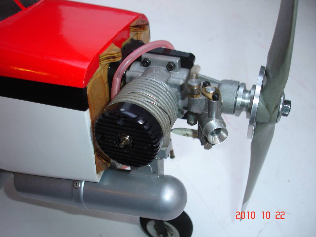

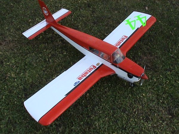

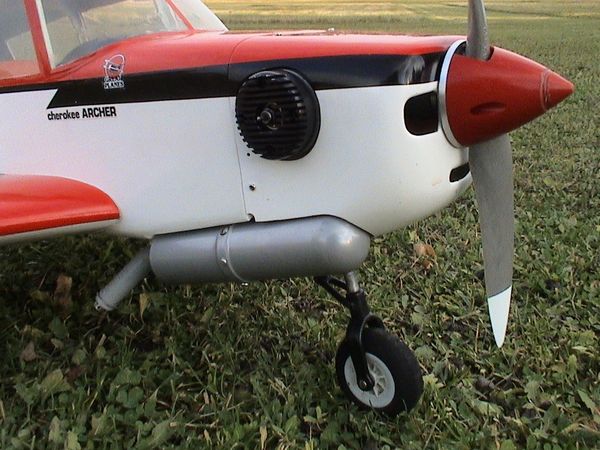

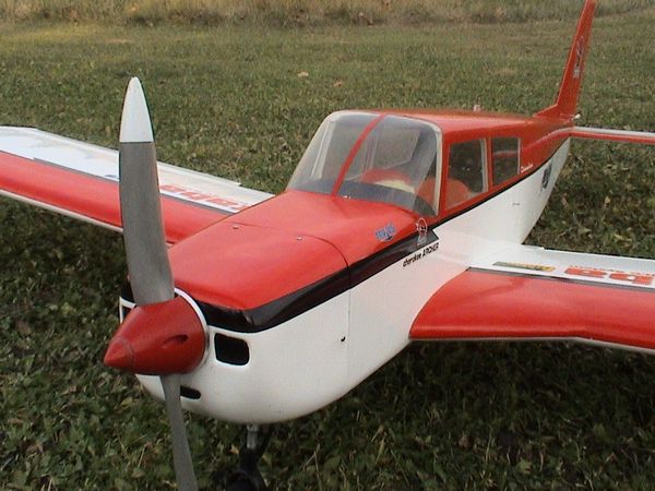

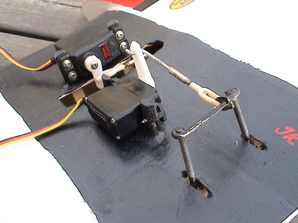

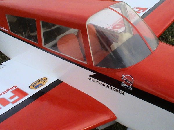

Old 04-27-2012 | 07:22 AM
Posts: 7,816
Received 10 Likes on 10 Posts
From: Upplands Vasby, SWEDEN
Default RE: Cherokee .40 size question
Hi!
This is one of our three trainers we have in our club. Great Planes Cherokee, Powered with a MVVS .40 ,swinging an APC 11x6 prop.
Good performance!

Old 05-01-2012 | 09:58 PM
Kostas1's Avatar
Joined: Dec 2005
Posts: 3,566
From: AthensAthens, GREECE
Awesome!
What is that on the 6th pic;
