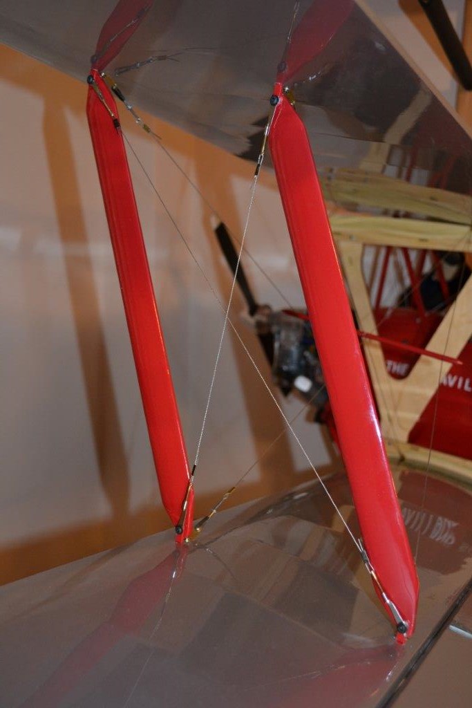

To try to re-adjust the climbing tendency of the plane, a first action was to give a bit more downthrust to the firwall, however, this may not be sufficient to give a good all-round solution - decalage modifications should also be combined; for sure, more downthrust will only cause a side-effect of ballooning on landing upon throttle cut - been there done that. The solution is to check what's going on with the decalage as well.
So, the plane was false-assembled for a quick measurement with the trusty Robart incidence gauge:
- Fuz was set at 0 degrees, using the top engine box plank as a datum (here, I assume this is parallel to the main "stringer" of the plane, which would be used as a datum line if this was a kit instead of an ARF - hope I'm right!).
- Engine was @ -2 degrees (as modified - see previous post).
- Tailplane seat was @ +1.5 degrees.
- Bottom wing was measured at +4.0 degrees.
- Top tank/wing was measured at + 5.5 to 6.0 degrees.
Now, this means that there is a positive decalage of 5.5/6.0-4.0 = 1.5 to 2.0 degrees.
If, at flying attitute, we assume the stab to fly at 0 degrees, then
- The fuz will fly at a -1.5degree nose down stance (which "sounds" about right for a TM)
- The effective downthrust will be -1.5 +(-2.0) = -3.5degrees (a generally accepted angle for lightly loaded scale planes)
- The bottom wing will fly at 4.0-1.5 = 2.5 degrees
- The top wing will fly at 6.0-1.5 = 4.5 degrees.
- Decalage is then +2.0 degrees.
(Have a look at the attached sketch).
Question now is, at what flying speed will the plane trim out with such decalage. To me, after seeing these values, the ballooning effect is a certainty - plane will climb at idle! Also, take into account that the effective AoA of an undercambered airfoil actually is positive at zero degrees. This further exacerbates the effect.
A fair bit of Googling around (i.e. literature survey) for decalage suggestions from both full-size and scale builders has indicated the following facts:
- Positive decalage is used to incur a benign stall. This has to do with the downdraft of the top wing affecting the actual AoA of the bottom wing (increases it). This pushes the bottom wing to stall first, "hanging" the bipe only from the top wing which is still flying. In a positive stagger design, this will induce a pitch-up (i.e. unstable post-stall behavior). By increasing the incidence of the top wing, the designer makes sure this stalls first (and makes for a "mushy" stall).
- Negative decalage is used to promote sharp stalling, usually used in aerobatics.
- Full size Tiger Moths are rigged in different ways for different purposes. For aerobatics displays or cross-country flights, pilots rig the plane with zero/negative decalage to increase the neutral-trim-cruising-speed and/or to allow for nice clean break upon spinning. For pleasure/training flights, the plane is rigged with positive decalage for increased safety margins in the stall.
- Many modellers have radically improved the behavior of their planes by using negative decalage.
Clearly, the H9 designer has decided to make the plane benign and compromised it by allowing a very small cruising speed (i.e. idle). Anything else, its a homesick angel.
One final snack for thought.
We have all seen the error in the H9 manual regarding the CG values - a pretty basic piece of data for the plane and one that can destroy a new plane. Pretty bummer from H9.
Now, consider the piece of info regarding the mounting of the top wing tank from the same manual (page 16, see attached pdf). If somebody made a mistake on the CG, then it is wildly possible that also this little step has been mixed-up. Just as a check - if one swaps the 235mm strut with the 230mm strut (front-to-back), the top tank sits nicely (without any stress) at +2.5 degrees, instead of +6.0. This changes the decalage from +2 to -2.5 degrees.
With this modification, at a flying attitude (i.e. stab @ zero, fuz @ -1.5), the plane will "sit" as follows:
- Total effective Downthrust -3.5 degrees
- The bottom wing +2.5 degrees
- The top wing will fly at +1 degree.
- Decalage -2.5 degrees.
I am willing to make a bet that this solves most of what we perceive as ballooning (i.e. down-trim at a slow cruising speed) while allowing for crisper aerobatics...
My plane will take months to complete - Easter maybe, so we will no know until then.
Is anybody willing to quickly try this strut swap and see what happens to the behavior of the plane? Worse case, it will need to hold a bit of up on finals and landing and possibly snap a bit easier if pushed!

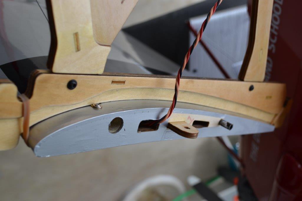

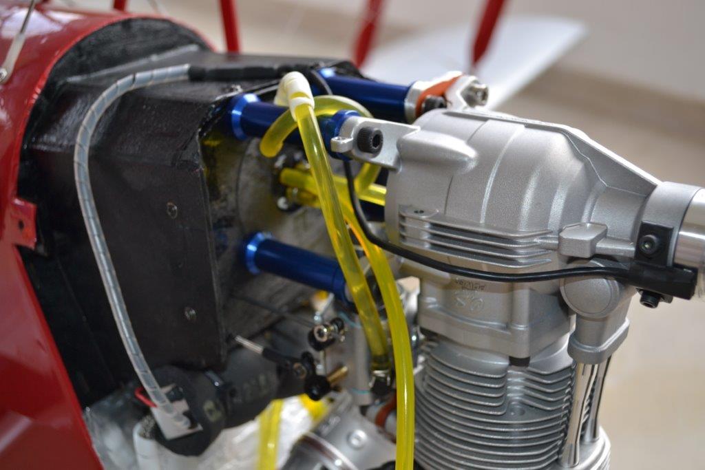

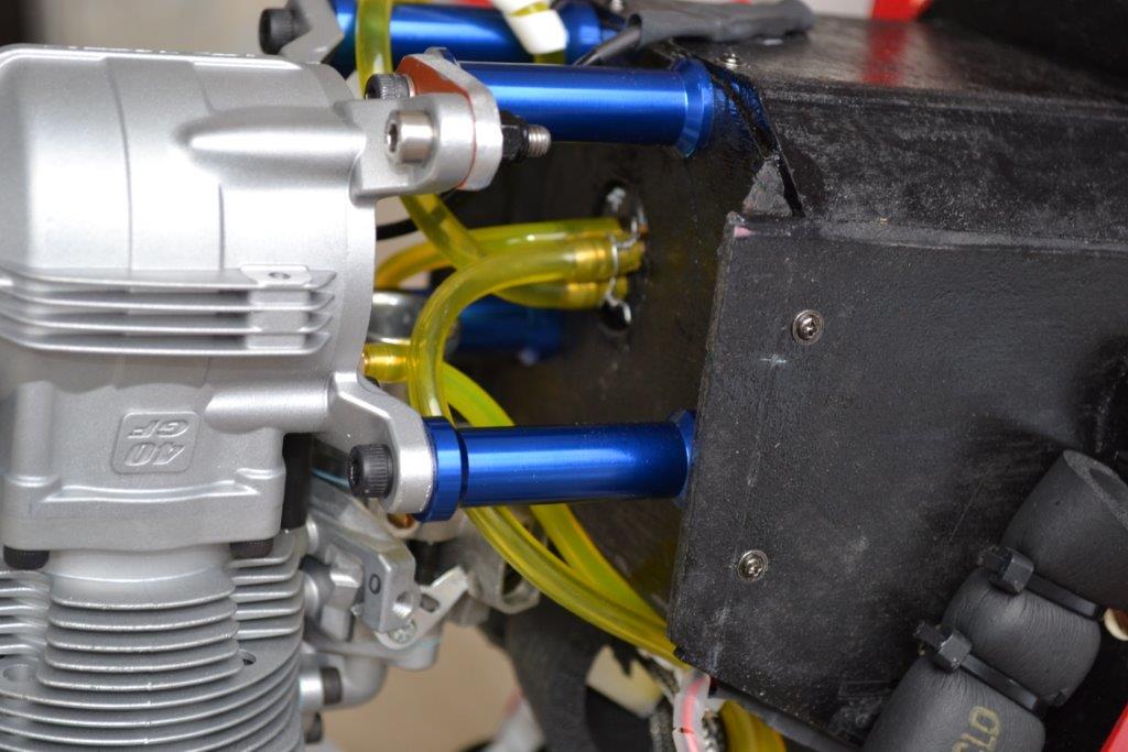

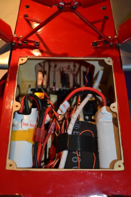

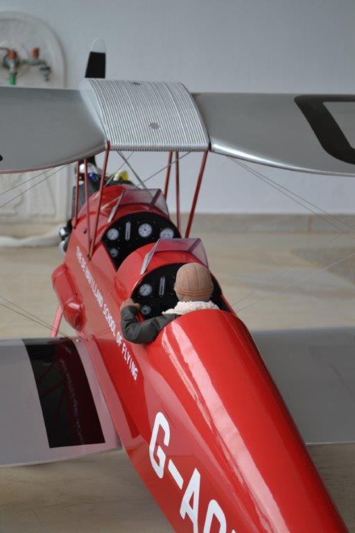

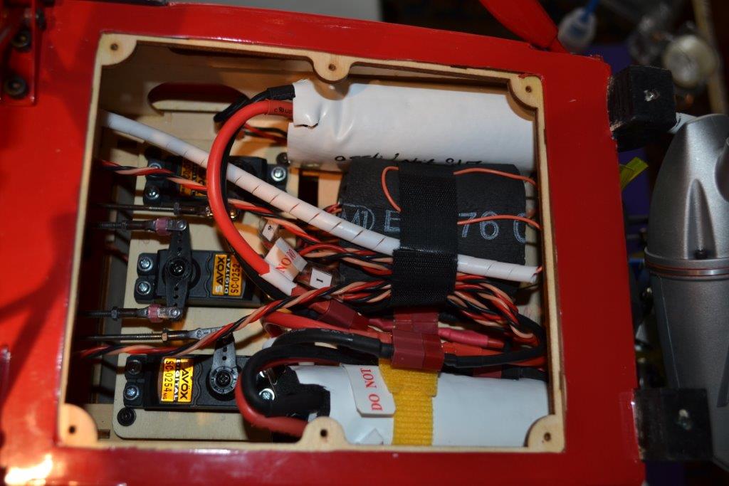

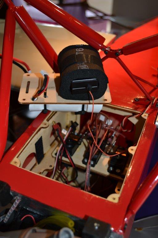

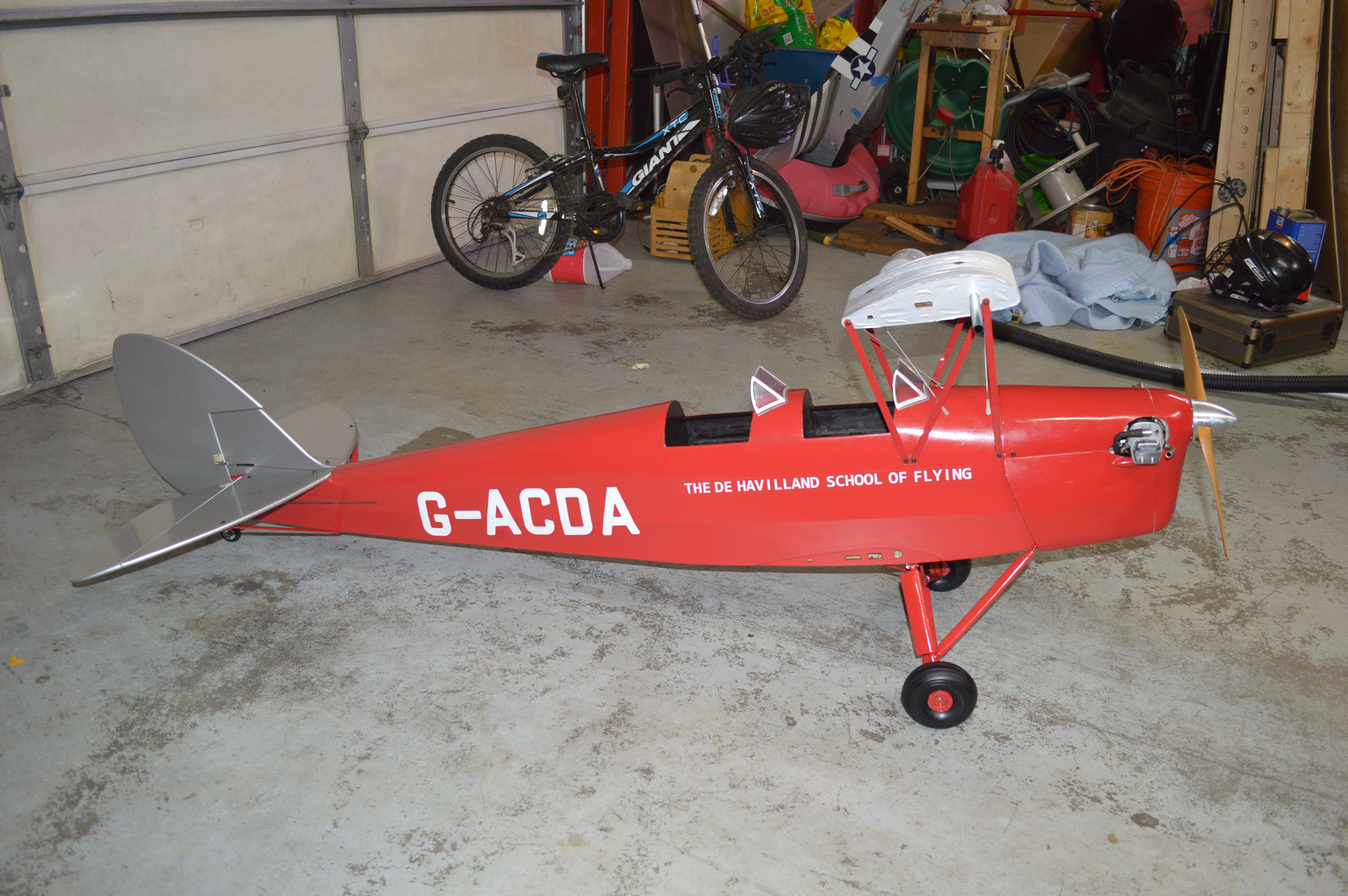

OK, she's done!

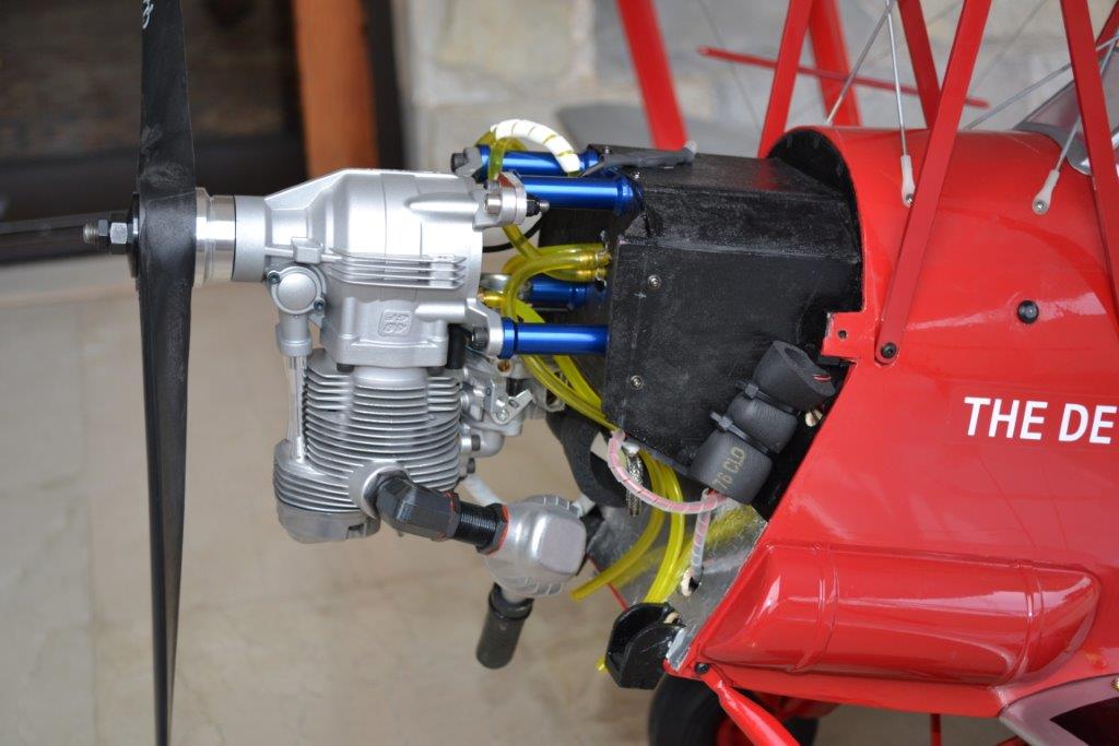

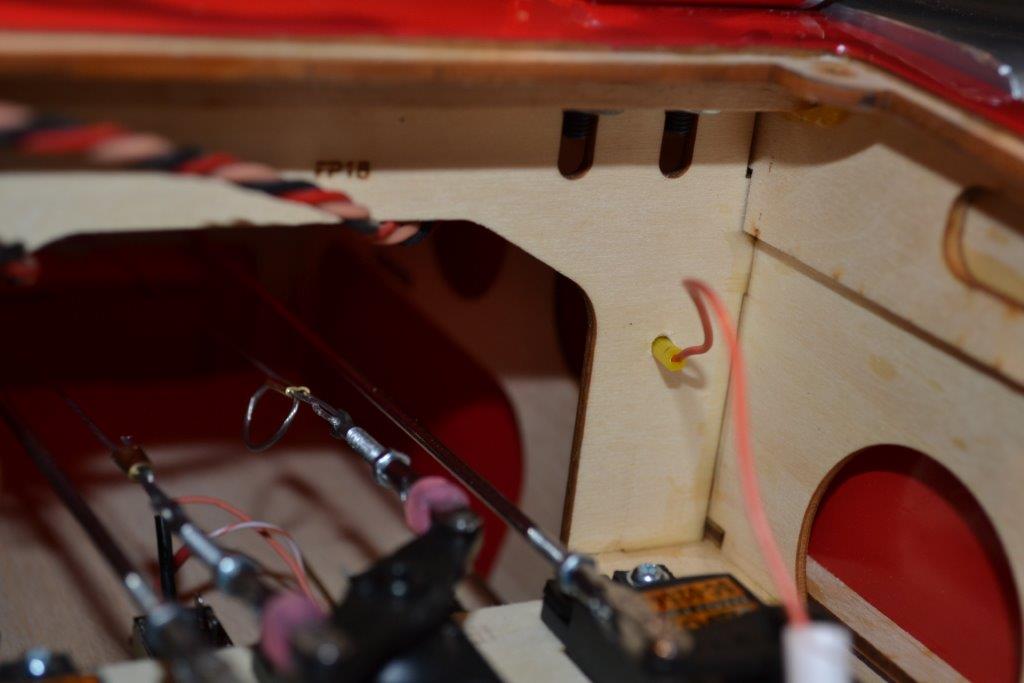

Had to make a few mods:
- Shortening the engine box means the fuel tank is pushed back. No biggie. Just needed a retaining cross-brace on the back so that it does not slip back. The hole on the new firewall was opened with a boring tool.
- Tank was given a 3rd line for filling (carb/vent/fill).
- A choke rod was set-up from engine to front cockpit. It passes just 1mm off the throttle servo spline - just enough to avoid contact.
- Closed firewall holes to avoid heating-up the lipos situated just behind (the exhaust).
Power system uses 2 x 1550mAh lipos, one tie-wrapped under the Rx tray, 1 on the side next to the Rx. A voltage regulator is placed next to the fuel tank, below the removable trays, on the choke servo bay. This is possible by the choke rod mod (no servo needed). Added 2 balsa blocks on the plywood electronics bay cover to keep the Lipos securely in place.
Ignition system uses an RCXL optical cut-off and another 1550mAh lipo, velcroed on the other side of the Rx Tray.
The Rx Aerial (I still use PCM) was passed between the edge of the fuse formers and the ultracote skin - worked nicely. A guide hole was drilled in former "F2" to keep everything in place.
An AH Designs 1/4 scale Pilot is under the helm, looking relatively relaxed (such a docile airplane!).
The plane with the OS GF40 balanced on the dot @ 8", no additional weight or anything - nice bonus. The elbow used allows the exhaust stinger to come out at the right scale location..!
The engine was started BY HAND on its first run . Idled out of the box @ 1560rpm - impressive! Should be a nice match, although @ half throttle it will want to rip the wings off.

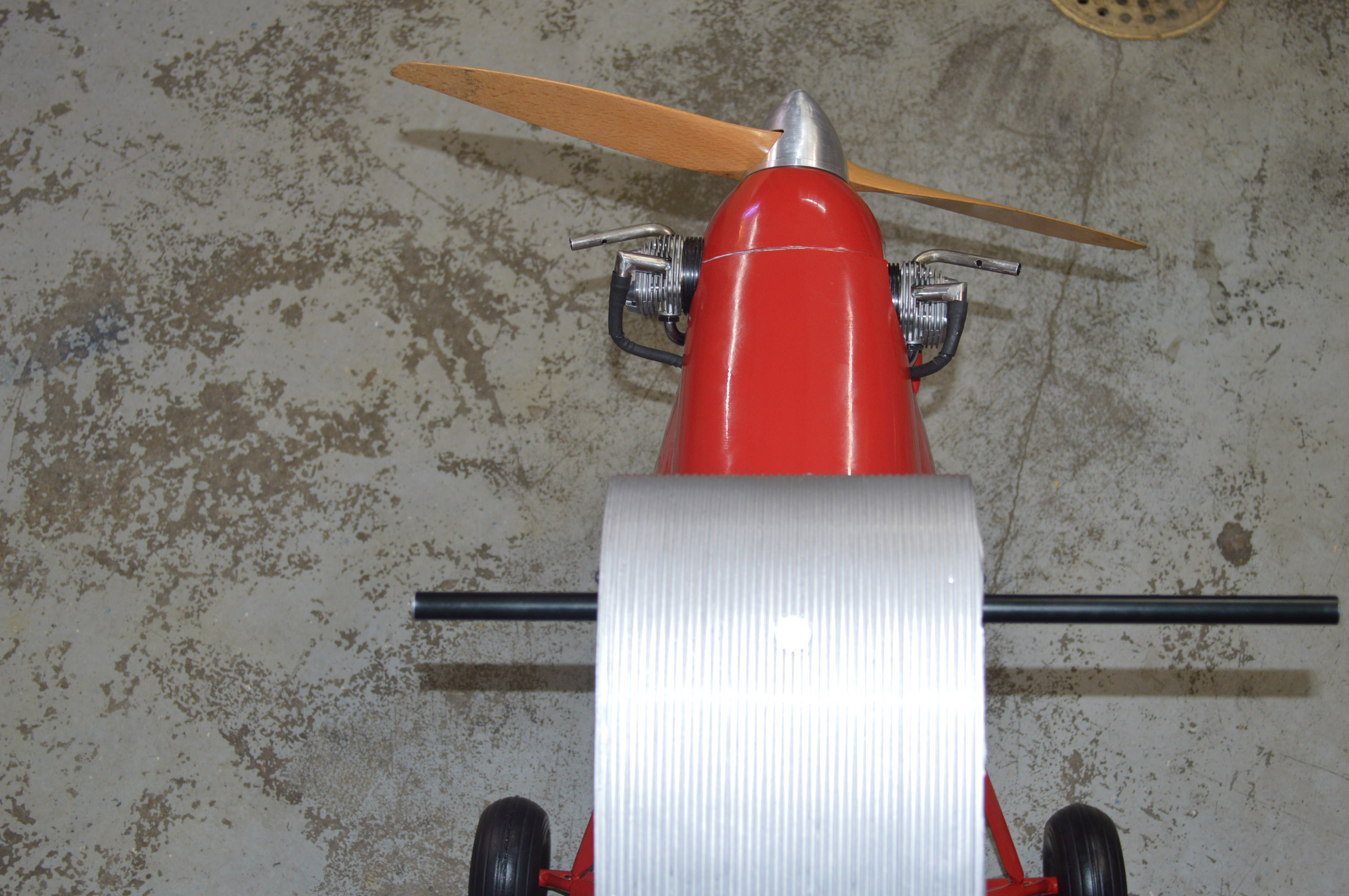

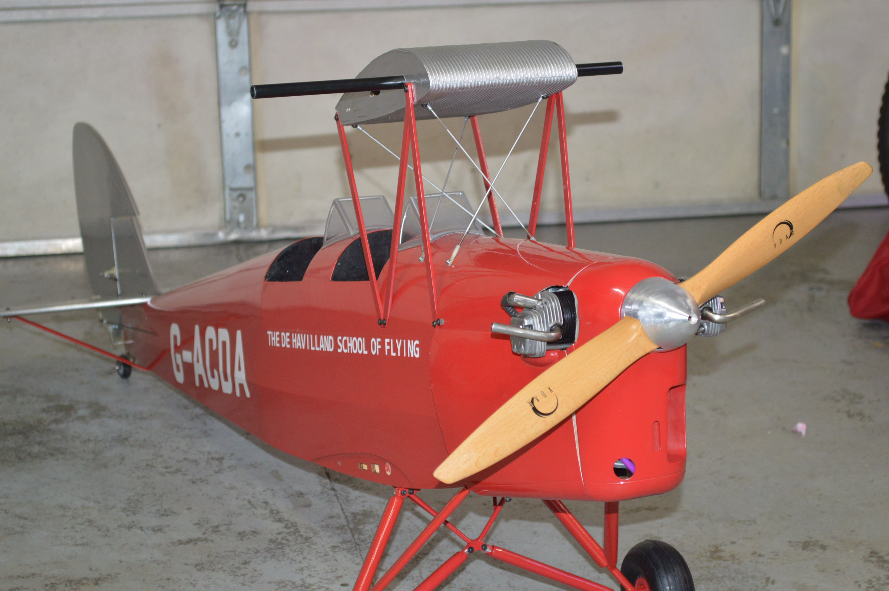

Here is mine.
It has a twin in it... will post some picts w/cowl on... it actually turned out great....
os 1.60 Gemini with C&H manual advance ignition.
had some trouble with it... turned out to be BAD batteries.... I have had trouble finding 3.8 volt bat. packs....LOL....
I had some old lipos and split them, to make it 4 volts and those didn't even work properly... it would brown out with .5 amp...draw
I raised my Rudder servo, so I could get HIGH rates on the ELevators.... This will help w/nosing over as It will have more degree of elevator.
I didn't see any instructions on how to secure the fuel tank so I used the old way.... bands and eye hooks..
and yes, I will move the sevo wire that is under the bands...LOL...

The heads do stick out on both sides... but that isn't unlike most airplanes with glow engines or Zenoah carbs & mufflers on many 50cc warbirds....
The only thing that I am trying to figure out is the thickness of the prop hub w/the spinner.... the lock bolt has no threads ( the prop/spinner backplate) takes up all the room..
Any suggestions???

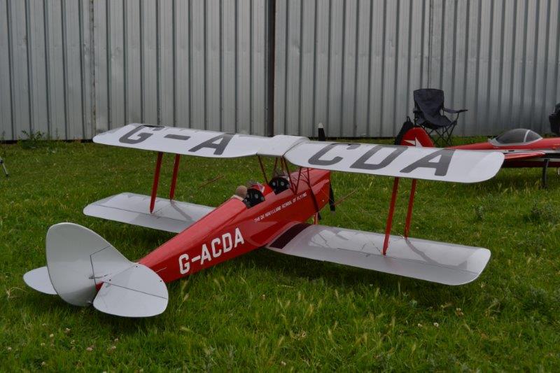

Don,
When reaching later stages in construction, it turned out that changing the AoA of the top wing forces one to re-make the front struts much shorter than can be achieved (aluminum fittings screwed all the way-in but still distance is too large), so I opted out pending the 1st flight.
Indeed, with the stock decalage, the model needed some down-trim (approx. bottom surface of elevator flat with stab) but all in all the flight characteristics were docile, not much retrimming in flight.. So I let it be for the moment.

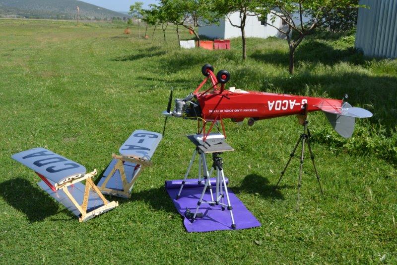

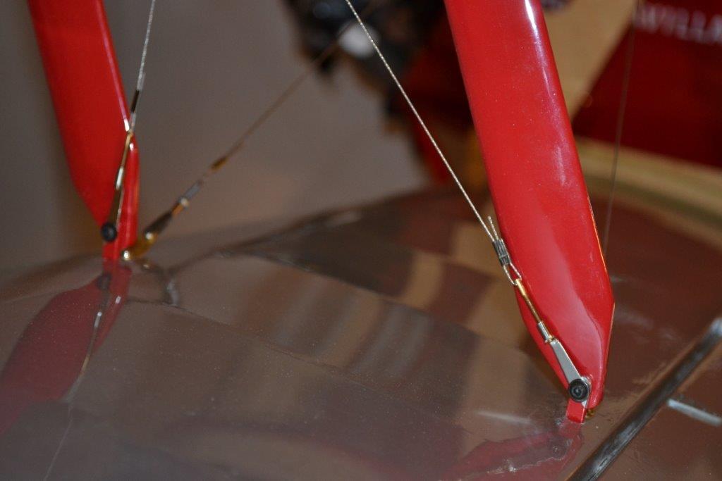

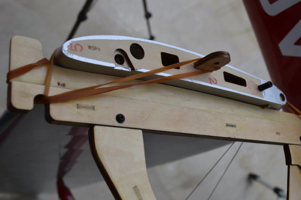

One more thing, about the wing cradle problem.
It was readily evident that the whole wing storage system (i.e. supplied transportation cradles) was not stable, as also reported here in the past. However, I think this is not so much a design fault of the cradle system provided, but a small ommission from H9's side.
Basically, I noticed that if the wing struts were not done-up super tight, the 2 wings would easily move to release the tension of the rigging. This would then naturally force the wing roots to slip-out under the rubber bands of the transportation cradles, making the whole assembly "collapse". If the cabanes were tightened-up firmly, the problem was found to be much less.
It was then a matter of 1/2 hour and <$10 to solve the problem whilst still keeping the beautiful original cradles. The solution is to rig the struts themselves as well! This way, the wing relation/distance is "locked in" without undue stress on the strut bolts. It costs "nothing" (8 x 2-56 clevises, closed loop adapters, crimps and some wire) and it's more scale as well! Wonder why H9 skimped on this simple thing on a $800 aiplane. Highly recommended!
One final little trick is to position the profiled seats of the cradle right between the rigging self-tapper and the brass fitting, so that all the pressure of the rubber bands is concentrated off the sheeting (leaves no marks on the balsa) PLUS it locks-in the cradles sideways (i.e. the cannot slip out). See pics.

I actually quite like it - gives it a 1930's "air"! Putting-on the cowl should be a challenge, though. How did you manage it - I see the front piece cut-off...
I had the same problem with a twin on a Cub - had to cut-up the cowl to put it on, then piece it back together with little servo screws...

I think it looks great! The best thing is that the engine is the sweetest one on the market, smooth, runs great, lots of power and a neat sound. I have one in a Dave Patrick Super Cub and it is a perfect fit

Thanks..
I did a Mold of the inner back of cowl. Epoxied it to the front half, and used that as a way of attachment.
A VERY tight fit.. SO much so, that I had to reinforce the front of the cowl, so I wouldn't bust it up, while attaching it..
This is do to the Tapper of the cowling... Easy to slide the front of cowl through the back, and then snip inplace....but obviously, wouldn't work
if the engine is there!...LOL.....
I could go without screws to hold it on, but I didn't want to take a chance.
1.place the back half of cowl
2. place engine on firewall
3. place front cover of cowl
4, spinner/ prop ect ect...
Obviously, it took some time to do the fiberglassing, but worth the effort.
The Pictures were BEFORE the 2 screws were used to cinch up the fit, and red matching paint was on, to
form a invisible line.
If I hate it, I have a brand new H9 TIgermoth in a box, that I can mold a NEW cowl from...
