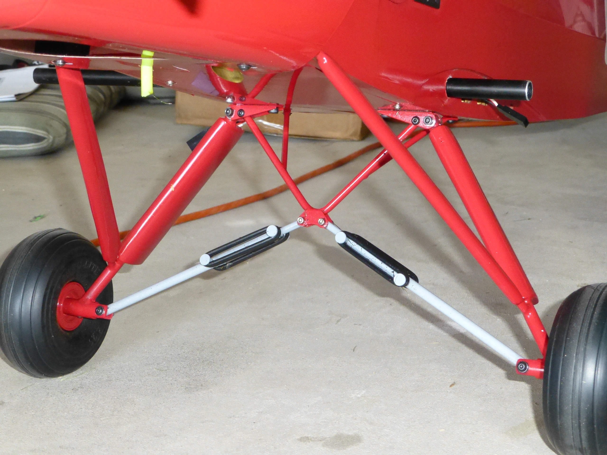

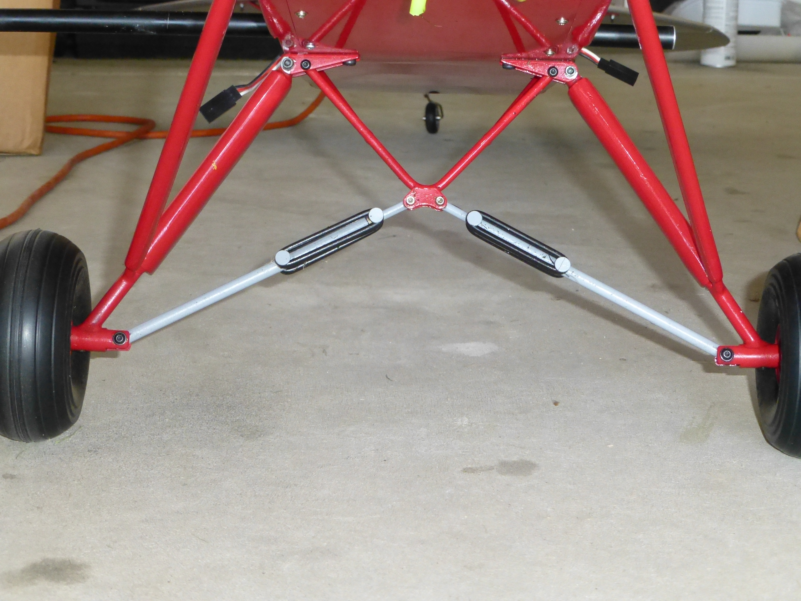

Here are pics of my modified landing gear. I yet have to paint it or enclose it to cover the o rings. Works real well.
These are components from a Robarts J-3 landing gear assembly. I had to shorten the telescopic struts slightly and modified the mounting point of the front strut by just packing a thick piece of rubber under it and beef it up from inside the fuselage with a 1/2" x 1/2" spruce.

That's a pretty smart mod Rafeek - thanks for sharing.
I was always wondering how to make the front strut pivotable...
On the other hand, I was worried about over-leaning when taxying/taking-off/landing in crosswinds (bipes are more susceptible to the wind "getting under the wing") when having a soft LG, then decided to live with the rigid stock set-up.
Hasn't proven too much of a problem, plane flies so slow I can grease it in every time (even deadstick) without bouncing.
My CG is on the front of the suggested range (126-129mm if memory serves). Definately ~1in. in front of the TE of the fake top tank... Maybe this is why I experience nose-ins during taxying out without up elevator. But flying is good.

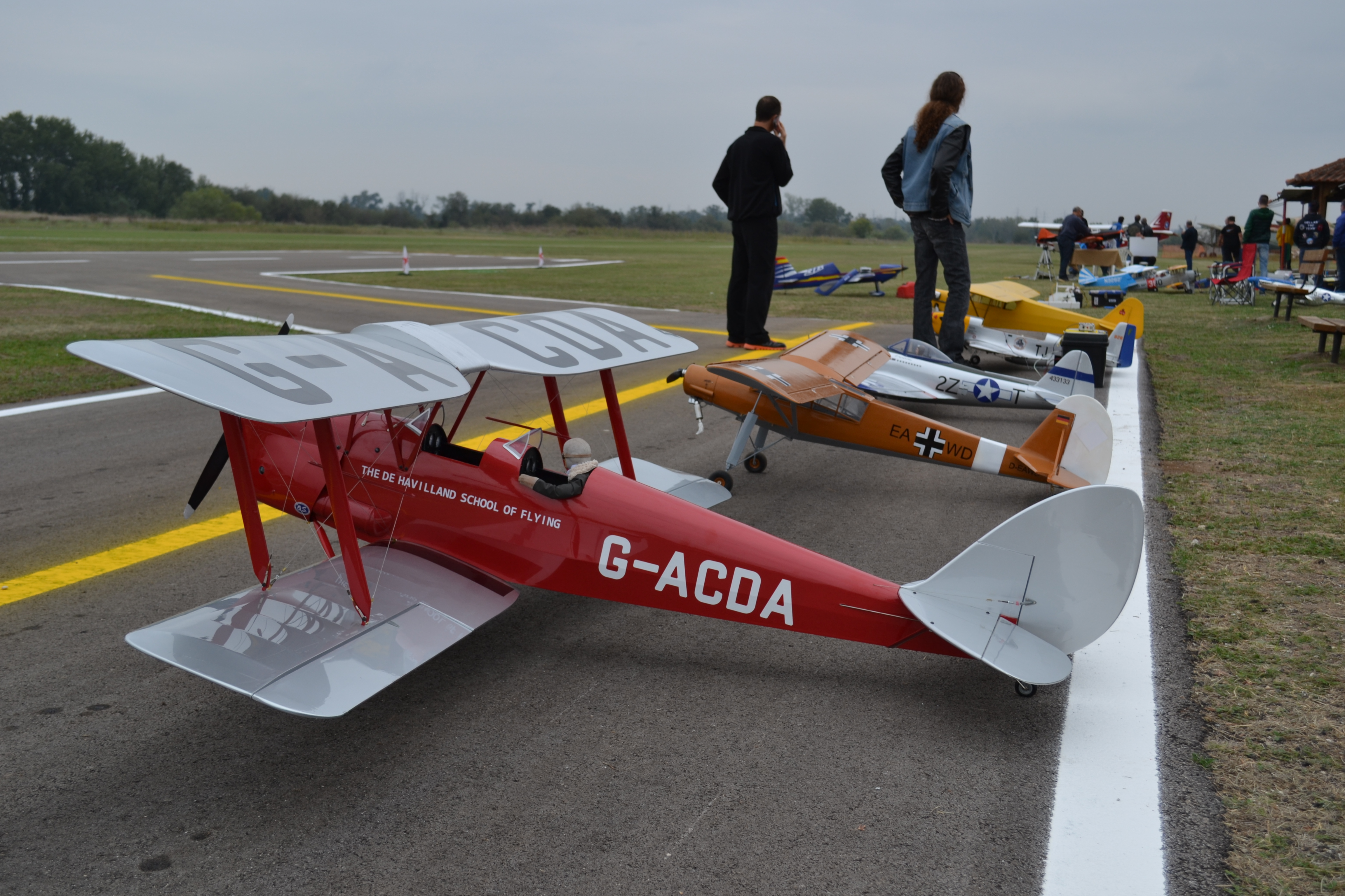

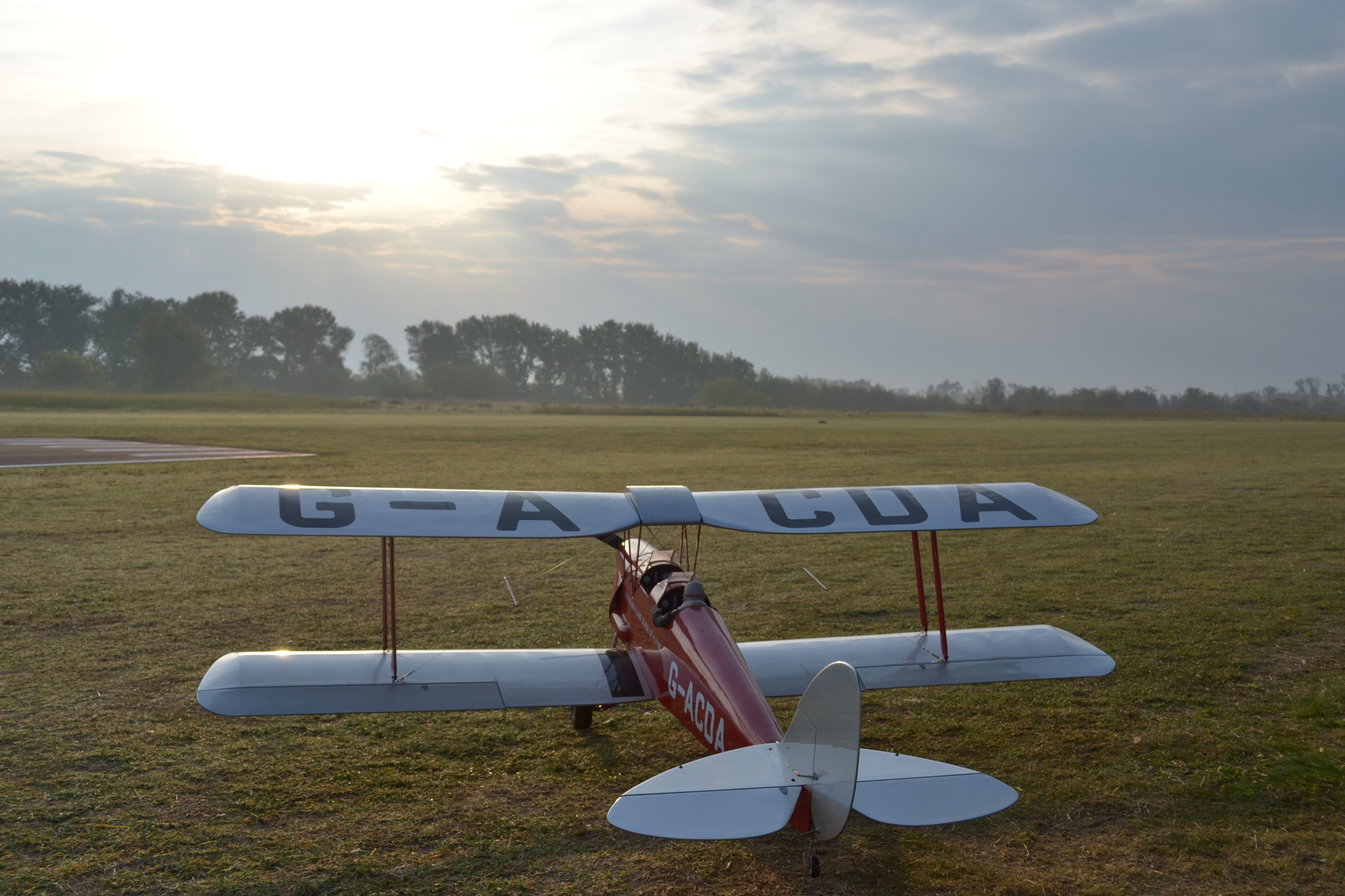

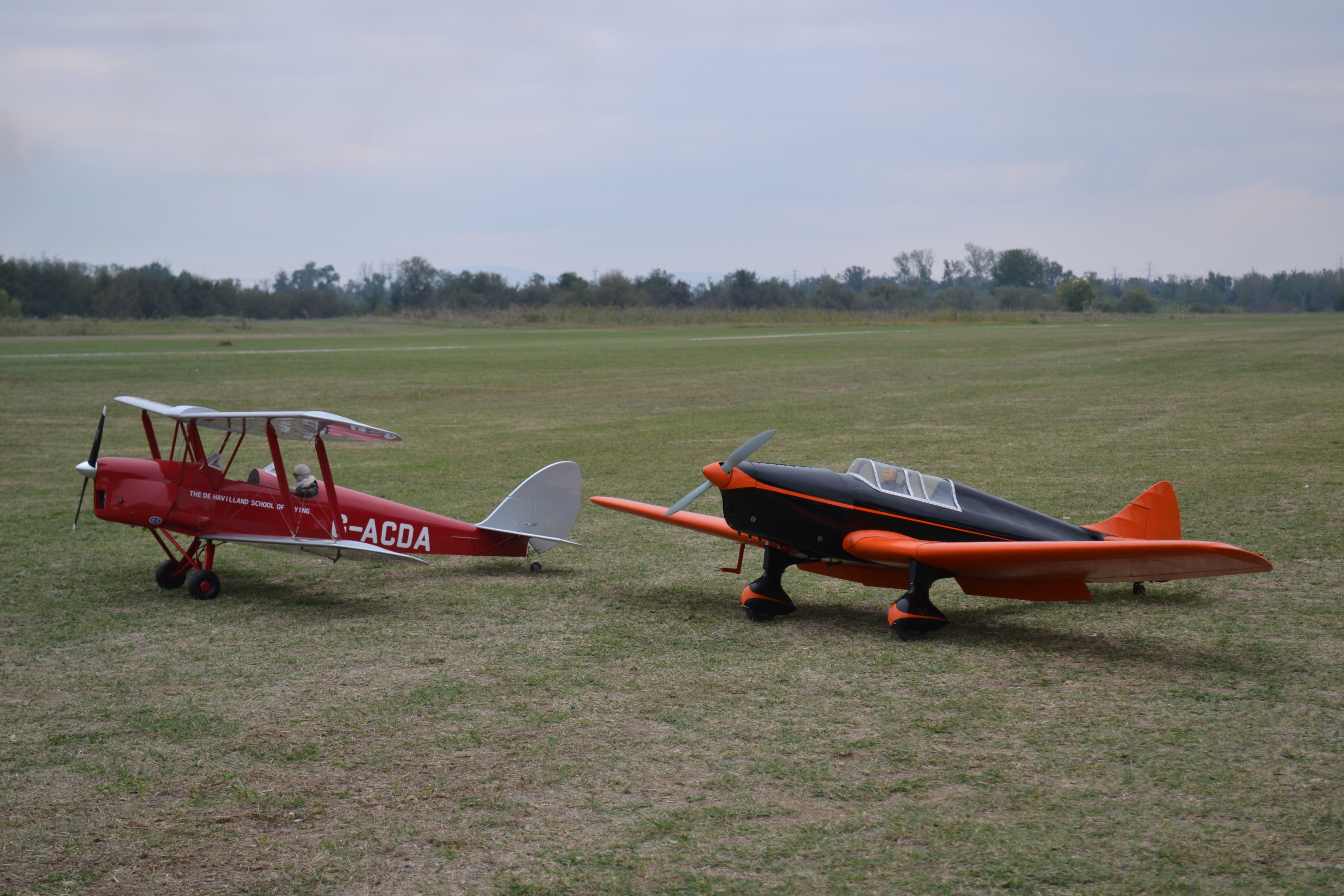

Just a few pics - to break the monotonous text; the DH82 in last year's F4C Nats in GR (ARF category).
Nothing beats an early morning flight in dead calm and mist on the ground... Almost back to 1930's England.
(The Miles Mohawk is a scratch built, winner of Designer Scale - not mine, of course..)
