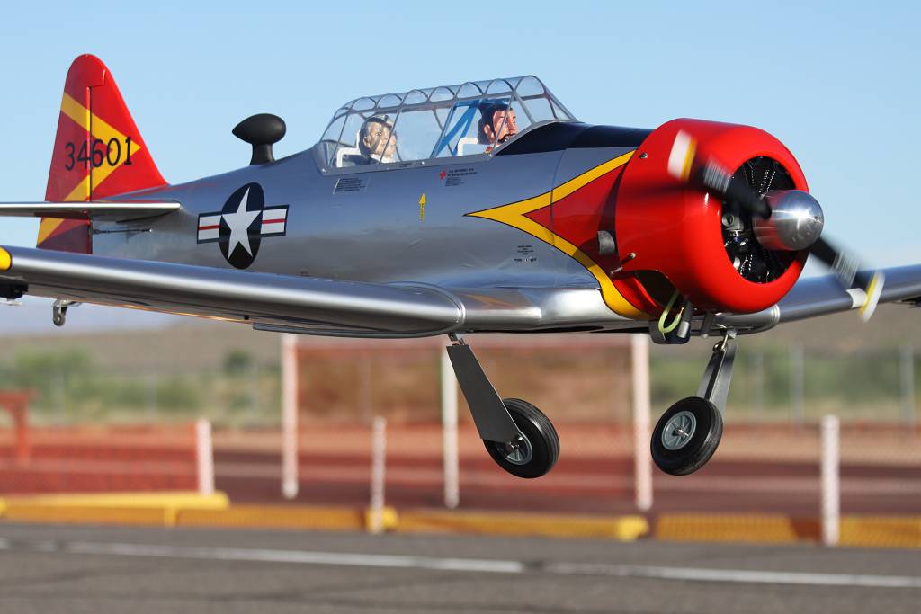

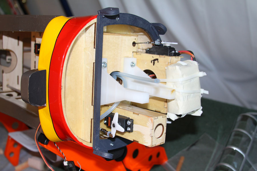

I have built and flown the larger Texan and yes the servos mounted ahead of the firewall created a 'No-Dead Lead' condition and I even used a Saito 180....still have the plane for that matter....here is a couple of pics of it.
But will have to decide if you want a one-piece wing, two-piece wing or 3-piece wing...I opted for the two piece wing.
Jerry

The Saito was way too much power for this bird, and switched it to an Evolution 120 and that flew it just fine. I used the E-Flite retracts and they worked well and yes, I did mount the engine on it's side - with the Saito requiring some holes for the rocker head and cooling...This picture was the second cowl and the Evolution engine.
