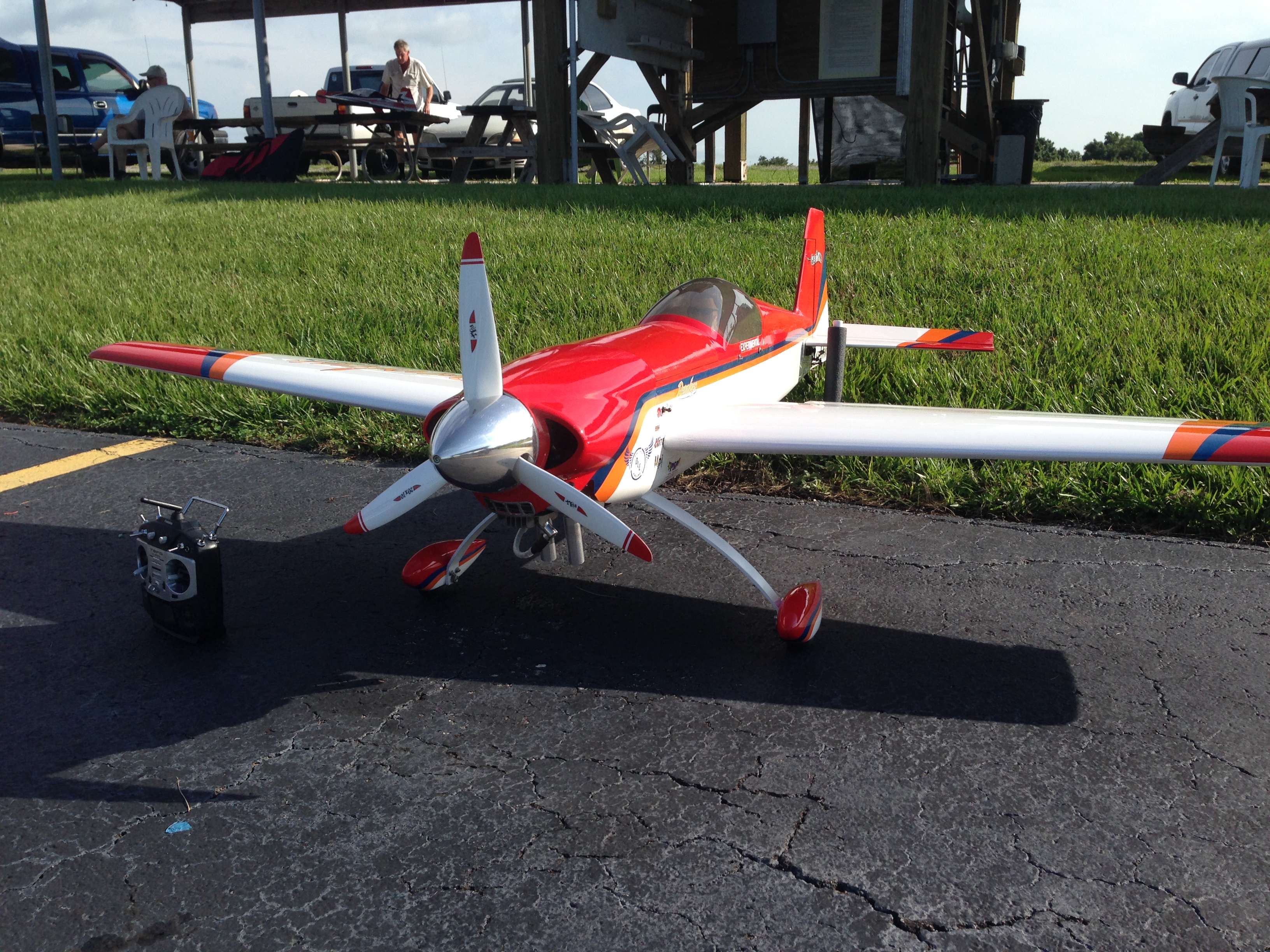

Yes I did see one of these Xoar 20x10 laminated props at Graves RC last month but did not pick it up. Now it's gone.
But I have not tried to tweek the carb yet with this change in props, so maybe I can get a little more out of it.
Here is a photo of the Revolver with the new Biela 20x10. I really like the looks of it and even with the slightly reduced speed, I will keep it. I already got a few positive comments about it.
