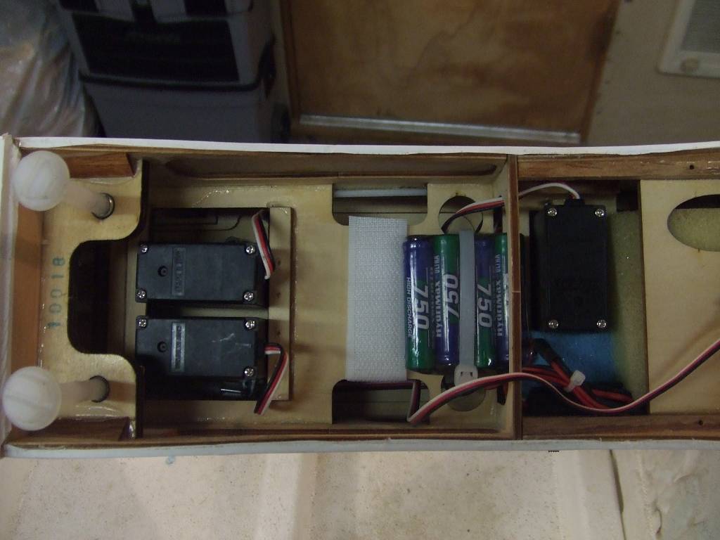

I have built a escapade 40 today and it went together without a hitch until............... This plane is a grab and go plane. Just wanted a very simple inexpensive plane to fly in my backyard everything super basic. I opted for the single servo build since the plane is not a speed plane (OS 52 Four stroke) I figured a single servo on the wing would be fine. Here is the problem........ Built just as book said but I tried to install the wing the wing servo hits the receiver battery which does not allow the wing to meet the fuselage. Is this a problem or have I just made a mistake in the build or am I just simply missing something?

Take the battery out and balance the plane. To get the desired CG I think you will find that the battery should go in the tank area. I have mine on top of the tank.

I wish I had thought about that at 2AM. After over an hour of undoing and redoing I finally said the heck with it and went with the dual servo option. I am using a small engine (OS 52 Four Stroke) and was worried about CG and sure enough just like you said; TAIL HEAVY. I added some ballast just in front of the fuel tank but I am going to take it out and try your suggestion and move the battery. I should be able to drop most if not all of the extra weight. Thanks alot for the advise.

If you use a single servo for the ailerons it is all but impossible to get the wing on.Like landeck said put the battery on top of the fuel tank or put two aileron servos in the wing then that solves everything. They are fun airplanes, as long as the elevator does'nt blow off. I'm sure you read the threads on the defects of this plane.

I did not have trouble with battery installation and using one servo. Of course I just used a 750mah NiMh battery but that is what I used to use or less in the early 80's when that is all that came with radios. I get a good 5 10 minute flights on this setup..........and there is also recharging. I was also after a grab and go plane and this one fits the bill. I then bought the Escapade 60 size and love it as well.
