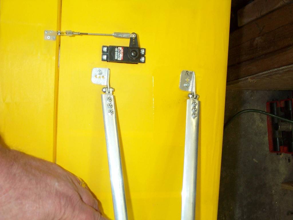

I am using Hi Tec 425's...My buddy bought a whack of them for 13 bucks each... I am not sure where he got them but He gets good deals and shares with the club. The pictures should be here. I'm trying to post pictures of the wing struts.
ID:	1838362   Click image for larger version

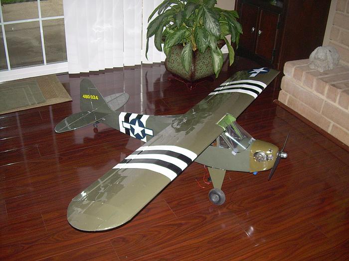

For what it's worth, here's a picture of my 20 year old Goldberg clipped wing Cub with the original OS .46 FX, standard Futaba servos and she fly's just fine. Now you all have me thinking of the magnum 4 stroke.... !
