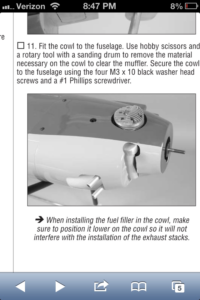

<span style="background-color: rgba(255, 255, 255, 0);">I am currently building a Hangar 9 P40. The instructions show a picture of the bottom front part of the cowl has been cutout to make room for the Pitts muffler. I want to see if there is a way to not cut that part of the cowl. I thought of just shortening the motor mount but then I don't think the prop will rest up against the drive hub.</span><div><span style="background-color: rgba(255, 255, 255, 0);"></span></div><div><span style="background-color: rgba(255, 255, 255, 0);">Thoughts/suggestions?</span></div>

What engine are you going to use?
If you could put a header on the engine, you may be able to use a Top-Flite In Cowl Muffler...
[link=http://www3.towerhobbies.com/cgi-bin/wti0001p?&I=LXHY77&P=7]Click me![/link]
If the header and the intake side of the can muffler does not line up, you can always use other tubing too.
I've used this muffler for cowled .91 OS and Magnum four stroke engines, using automotive tubing and clamps.
Sorry I will not have access to those planes for a few weeks ( storage ).
The "can" mounts on the firewall or where-ever you can affix it.
I used small clamps to affix auto tubing between the four strokes normal header without the muffler.
Your only big concern is that the exhaust tubing must be able to sustain higher temps. That is why silicon is normally used.
By the time the exhaust passes the header, it is not still being burned, so it does not tend to scar the silicon tubing.
Automotive tubing used around exhaust manifolds also have to take high heat so it works well.
Check into things used for tuned mufflers too, as they have the same routing problems with their tubing.

That Tower Hobbies in-cowl muffler has the right header for your engine so you're way ahead of the game already.
That header could be used for a straight pipe or the CAN muffler Tower provides in the link above
The concern is that once you obtain it, you may find you cannot fit the CAN in such a position that there is a straight shot back from the header.
Here is a better picture of the Jtec muffler [link=http://www3.towerhobbies.com/cgi-bin/wti0001p?&I=LXVNG5&P=7]Tower Jtec Link - Click me![/link]
As you can see the muffler affixes directly to the engine and the engine must be mounted inverted, then you have to cut holes for the exhaust.
You may end up having to cut a whole side of the cowl to get that Jtec muffler to fit.
With the Top Flite stuff you could always hook things up with something like this...
[link=http://www3.towerhobbies.com/cgi-bin/wti0001p?&I=LXACCG&P=7]Coupling[/link]
Or this...
[link=http://www3.towerhobbies.com/cgi-bin/wti0001p?&I=LXZ670&P=7]Click me too![/link]
Cut to size and tied down with wire ties.

<font size="2" color="#00265e">KazeRacing</font> & <font size="2" color="#00265e">opjose</font> How far do you have the end of the cowl to the leading edge of the wing? The manual says the distance should be 4 15/16" from the firewall to the end where the prop would rest on and with the cowl on the spinner back plate should have 3/16" space. Last night I mounted the engine and measured just over 4.5" from firewall and measured 3/8" from backplate. I moved the engine to the next hole up and got to like 4 13/16" from firewall which is closer. I figured I could move the cowl forward or backward to make up the 3/16 space from the backplate if needed to but I am taking a chance when I cut the cowl that the muffler hole is not cut in the correct spot.

</div><div>I have the Top Flite can muffler and header. The only forceivable way I can see doing this is using 2 90 degree elbows. Only issue is they would have to be awefully small elbows as the spacing between the end of the header and the edge of the motor mount is pretty small. Then I can use something like an automotive clamp to secure the can to the bottom of the motor mount which would mean cutting a couple slits on the bottom of the motor mount. I thought about using zip ties but figure they would melt. Other issue is sealing the elbows to the header and muffler can. Thought about silicone adhesive but don't know how it would react to the nitro fuel.</div>
