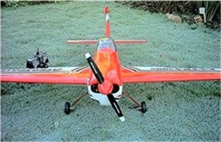

Hi
I built the Seagull 300S ARTF last year for .46 -.53 size engines which is an excellent model to assemble and fly. The .60 you refer to must be its new big brother as I've not heard of it. Sounds interesting!

If you fast forward to page 8 on this section there is a summary of my Seagull 300S ARTF review which I did on another forum. I built/assembled this model early last year and fitted an Irvine .46 which gives good performance. At less that £90 it's an attractive budget priced model that flies well!
