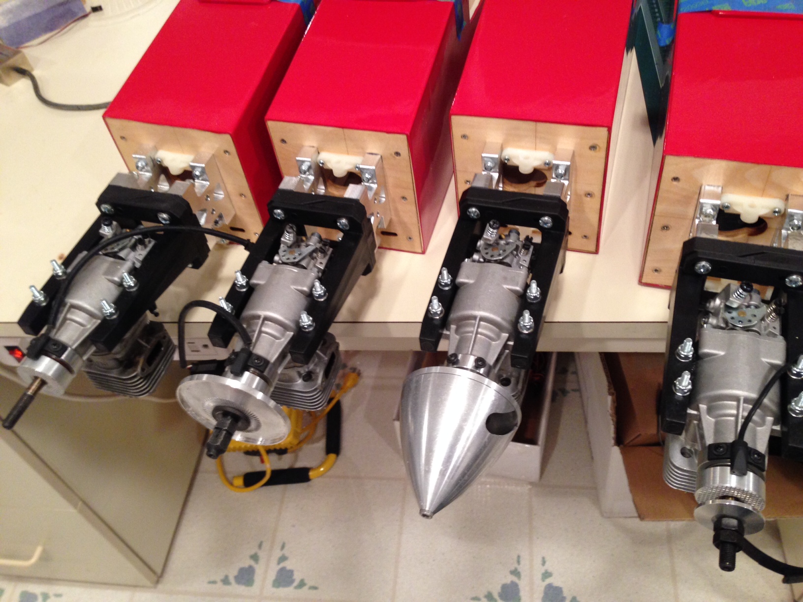

I've built 11 of these planes used as club trainers...
Don't use dowels. There will be too much torque on the dowels and the extra length produces a high lever moment.
You can use hard wood if you maximize the contact area as much as possible.
On our club trainers I am using lowely DLE 20 engines. These engines are far TOO light for the plane, yet they power it adecuately for a trainer.
In the picture below you can see how I've moved the engine out much further, to both adjust the C.G. and to permit the use of heavy duty Fults struts in a tricycle configuration ( better for newbies ).
The fuel tank is in the aft position and I have a 4200mAh 9v LiFe pack behind the firewall to power the electronics as well as a 2200mAh 6.6v LiFe packs for the ignition.

Been there, tried that, found it problematic.
Avoid wooden dowels. There is not enough contact area nor anti-flex strength to avoid the torsion problems with the engine out pretty far.
On my first build I created wooden standoff blocks similiar to the aluminum ones you see in the picture to solve the dowel problem.
That worked. Later another club member created the CNC standoff blocks in the picture which are even better.
At worst, zip tie your battery packs to your standoff mechanism.
Remember that these planes were designed around the relatively heavy Fuji BT-32B engines that come in at 4.5lbs in weight each... and they mounted with the included standoffs and wood.
Use a BIG battery pack as far forward as possible too. This helps a lot.
You'll need something large anyway to power all of those servos, particularly if they are digital high torque servos. I clock momentary 8.5A power draw bursts when there is resistance on more than one surface.

Ok wooden dowels are a problem then. Back to square one. What can I use to move the engine out to keep from adding a lot of lead weight? I have both ignition and receiver batteries in the fuel compartment. What about building a box around the dowels epoxied, to were I can epoxy weights into it that would add support to the dowels like an engine box you see on other airplanes
You sure want to go to a lot of extra work, just so you can use dowels. Why ?
As has been stated, forget the dowels. Use hard ply or hardwood. Cut it into 3/4" squares and drill a hole in the center. Place a square behind each engine bearer mounting hole and mount the engine. Use a 1/4" thickness.
If it balances, your done. If not, add another square and repeat.

Yup you can do what Tom suggests. That will work well.
You can also build a NEW "box" if you choose. Just make sure you use relatively thick hardwood, and use tri-stock bracing.
Note that the Stik's original firewall has aluminum angle bracing on it too.
Don't design around the dowels though.
