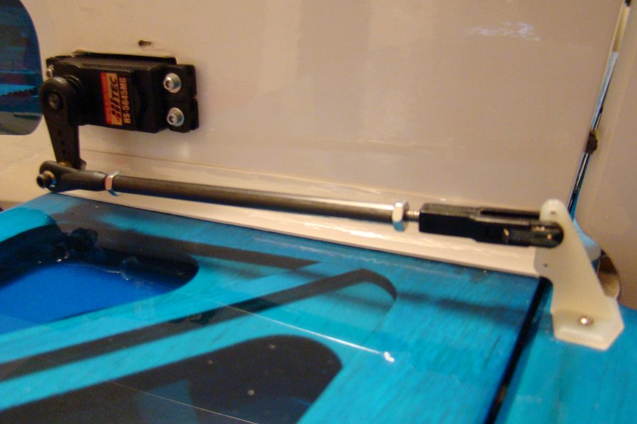

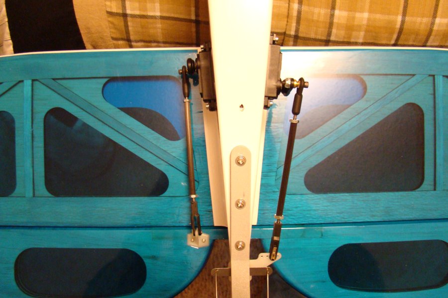

This is how I rig mine up. Really strong and cheap.
I assume that you are using all thread, and the sleeves are for added strength. Am I correct ?
Yeap, 4-40 all thread rod.

Tom my buddy had his put together with the jam nuts and metal clevis's however with the vibration put out by the Saito 180 they came loose and unwound. The metal clevis's turn to easily to take a chance even with jam nuts .. I like the looks of Zippi's set up with the plastic clevis's . I think they would have less of a chance of undoing themselves. That's a very nice looking set up that I will keep in mind ..I will do that myself next time . Zippi is that sleeve made from aluminum fuel tube ?
It is a carbon fiber tube I got from the LHS. I got one that fit the tightest around the 4-40 all thread rod. I'm running a SYSSA 30 cc gasser on mine swinging a VESS 18.5X5.5 prop.
Where did you find the Carbon Fiber Tubing ? Pschulte could you tell me what your friends reasons for not wanting you to use the ASP 160 ? I have an OS 160 Gemini Twin in a 1/4 scale Cub and I really like it . I am hoping the ASP 160 will be as nice an engine .
I got the CF tube at the LHS. I believe it is by Midwest. .188" OD X .166" ID X 24". $5.49 for one piece.

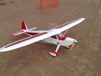

Mine also is the first generation with no flaps. I have a DLE 30 and rarely fly it above half throttle and we are regularly above 7000' density altitudes. And its a floater.
