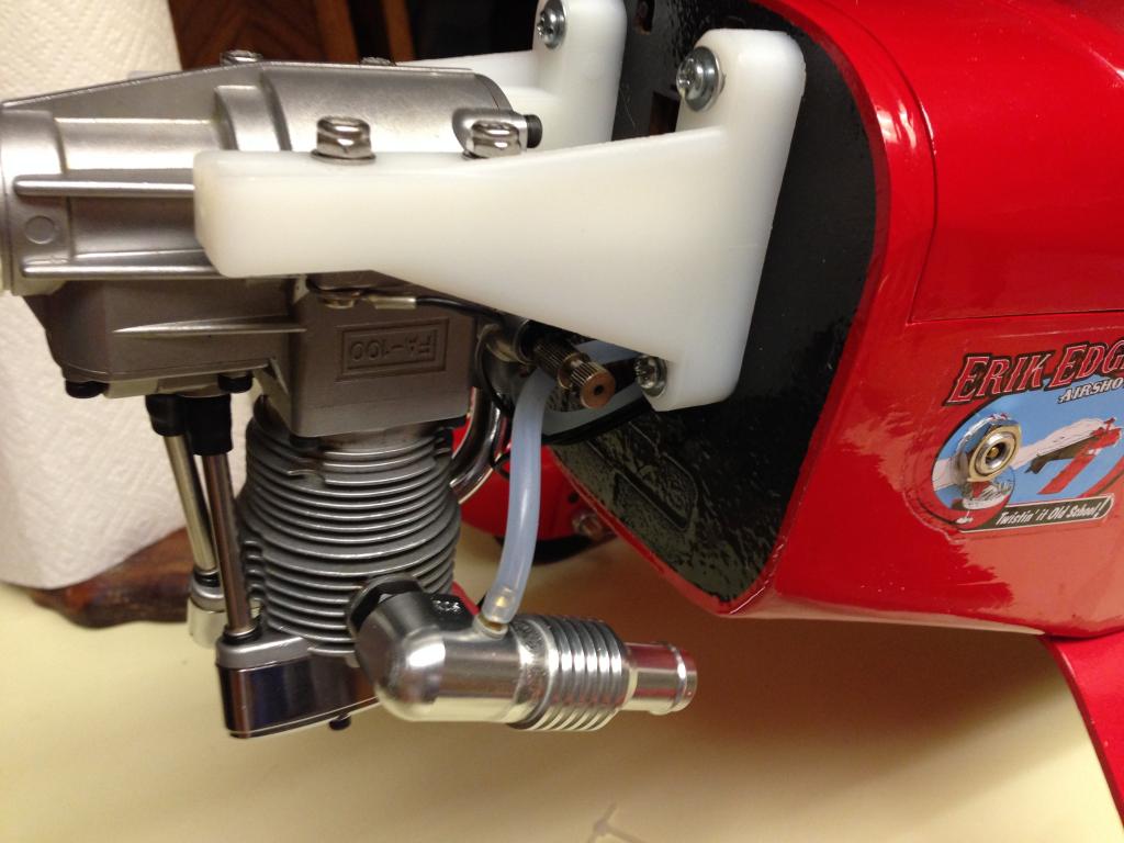

Should be a perfect match for this plane. The FG-11 I have is based on a FA-62 case which is smaller than the OS-70, so I had to modify the way it mounted. The Magnum 91 and Saito 100 both dropped right onto the mounts. As far as weight goes, the FG-11 weighs the same as the FA-100, and I added no dead weight to balance it, so the 70 should come out pretty much the same. I flew it on a 13x8 APC.

Move your battery as far back as you can, along with the RX. The 100 weighs in at about the same as the FG-11 with the module. I put the module at COG, and use a 2500 mah Life with dual leads. I haven't put the cowl on, and it comes in at about 2 ounces, so I will need to add some dead weight to counter it. Right now I am flying without the cowl until the engine is broken in, and I want to put a 90* adapter to put the muffler on the bottom and not out the side, fewer holes in the cowl. I have also had bad luck after putting on a cowl, both planes that I put cowls on I crashed the first flight afterwards. The 100 will work fine with the stock mounts too, but I dont know about using a 3 blade prop, it takes a bit to get this plane up to speed. Will be interested in how it does, I have one sitting on a shelf that came with the 100 GK I have.

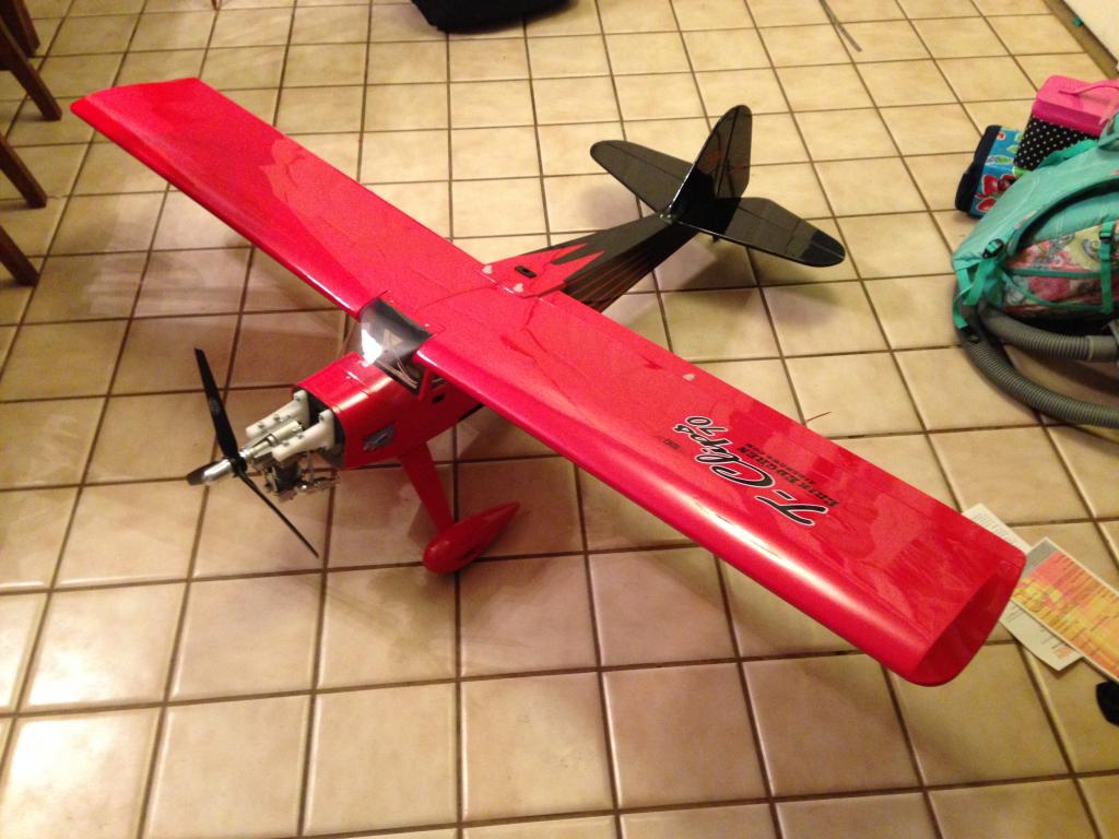

Well, the engine came out of a fat heavy P-40 (pneumatic retracts) and that was the prop that flew it (actually the spare). Seemed to have plenty of oomph back in the day. I've got some wooden 2 blade props if need be. 15x6 from when I did the original engine break in.
My T-Clips weighs in at 6lbs 15.2 oz dry with cowl (uncut) which is a couple pounds lighter than the war bird. Expecting her to be slightly more friendly to fly.
About 4 oz on the tail is what the balance rig says to get her level (3.5" back from LE) with the cowl sitting in place and all of the equipment locked in. I've got the battery back as far as I can without opening up the covering. Looks like figuring out the final balance will be next on the agenda. I did swap out for a turboheader on her. The deflector isn't on yet but will be before I fire it up. I'll want to run a tank or two through it on the ground to make sure its happy. I'll miss the Keleo exhaust I had for the P-40, but somehow I doubt I'll miss the mess it made of both sides of the plane.

I'm not concerned over cooling, the FG-11 doesn't prime itself just yet, and will still need fine tuning, so the cowl stays off until then. Lunn, is that weight before or after balancing? Its just an ounce shy of mine. Mine came out at just a hair over 7 pounds, balanced.

Hi acdii, That weight is before balancing. I don't really want ~4oz of dead weight hanging out on the exterior of the plane. Since I'll need to open the tail anyway, I'll see where the battery needs to go (2100mah life) and work on moving it further back before I think about internalizing any dead weight.

Got mine balanced with cowl on the nose and battery moved way back in the tail. Only additional weight needed was the triangle stock, lite ply and velcro + velcro straps to build a little battery tray sitting lengthwise between two frames.
