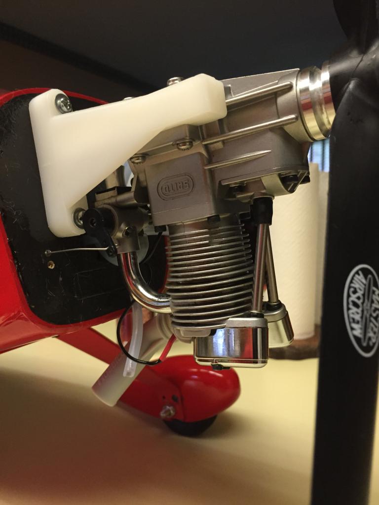

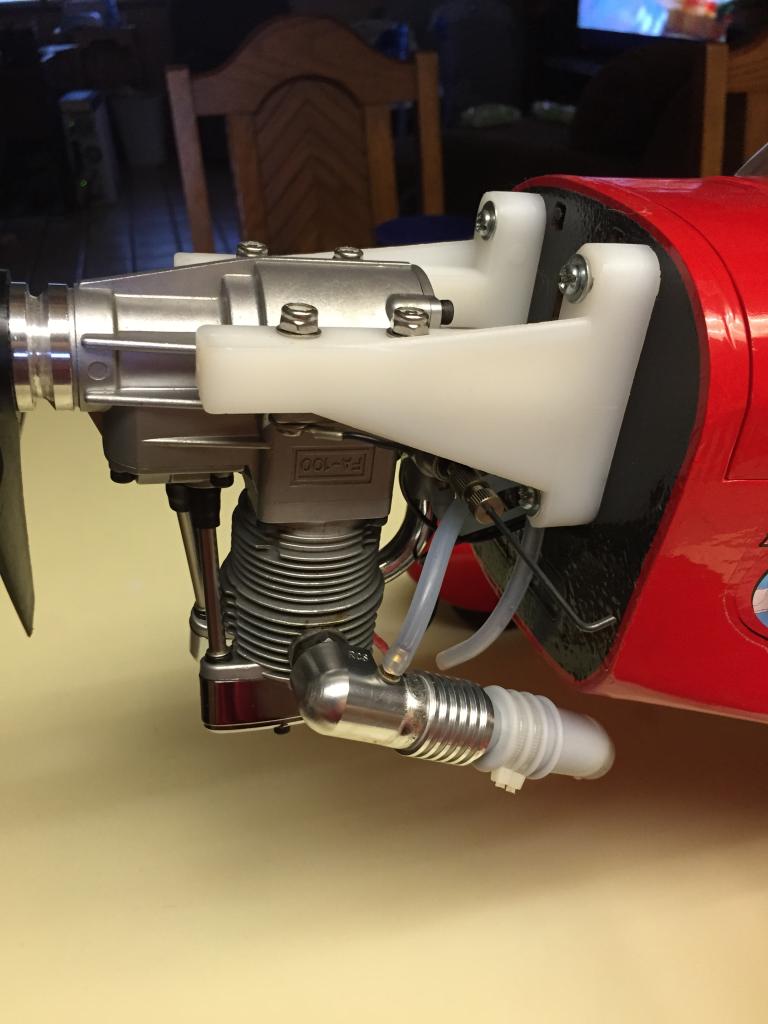

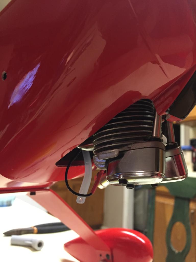

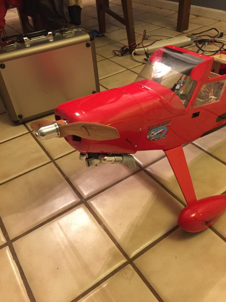

Here is the engine. I've not cut the cowl yet, but there's going to be a pretty good sized hole in the bottom to accommodate the FA100 and the exhaust. You should be able to follow the lower line of the fuse and make an imaginary line through the engine for the cowl. I really think that the Saito 72 or 82 would be a better fit for the plane. The 100 is simply massive overkill. The valve covers and a good bit of the head will be exposed. Certainly should be no cooling issues I will say that this particular FA100 was a pleasure to run today. Easy starts and sounds very nice. But it'd be more at home tugging a 9+lb warbird than a 7lb sportster with the current prop. It'll still be cool once I have the prop size dialed in.

To balance mine with the cowl, and the FG-11, which weighs the same as the 100, I would have needed to add 4 ounces to the tail. I wound up cutting the bottom covering two spaces behind the wing, putting in some support and mounting the battery pack and 1 ounce lead back there. Worked perfectly.
I also did a dumb thing(which prompted the rebalance and cowl), I flew it a few times a couple weeks ago and one last time, went to take off, wind had changed direction so it was opposite of what I had been taking off of, and tail came up, nose pitched forward due to being nose heavy and I over compensated, so off it went, not fast enough for the wing. I tried to recover with rudder, but just couldnt level off in time and cartwheeled it. Ripped the wing off, pulled the bolt down block out and cracked the fuse at former 2 and 3. Its all fixed up now, and reblanced so it wont nose over when it comes up level.
My LT-40 tends to take off the same way, nose down a bit, and I know its nose heavy too, just a hair, but the long fuse on it prevents it from lifting off too soon.
The FG-11 is the fight amount of power for this plane, I would fear over powering it would rip the wing off. It can do some wicked maneuvers.

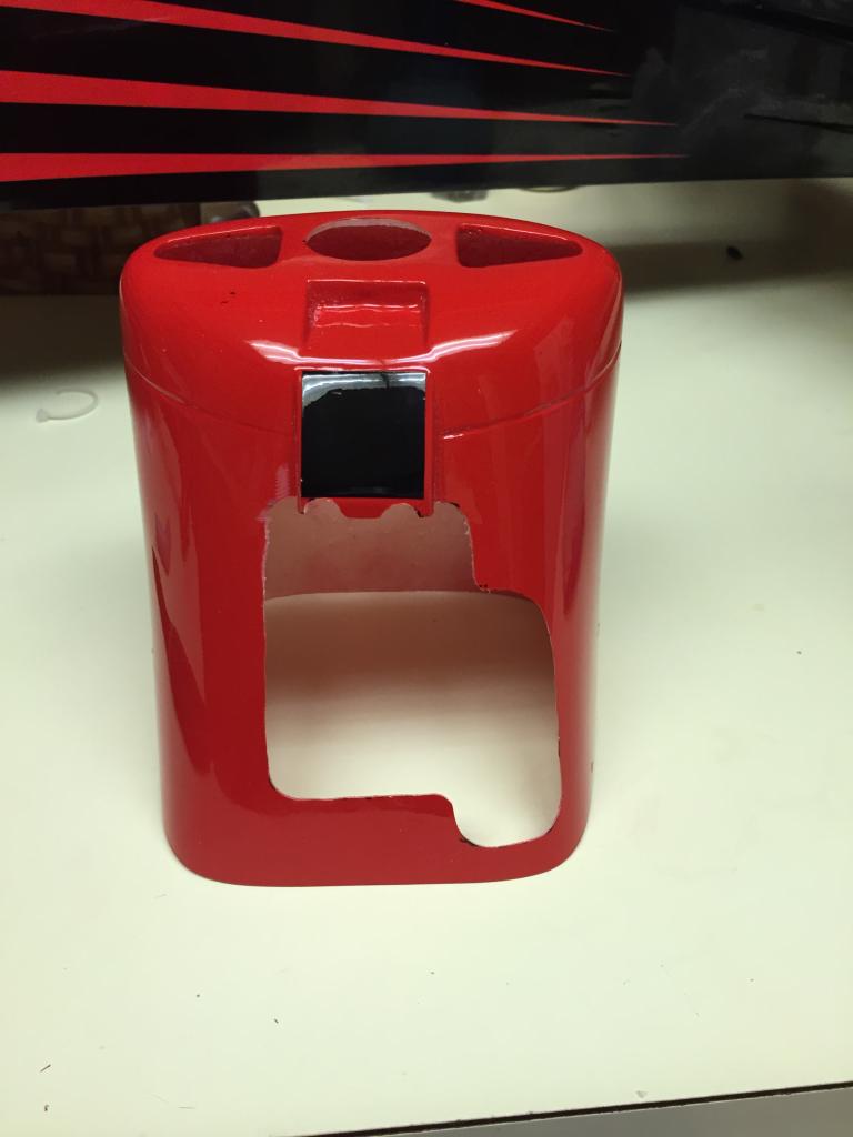

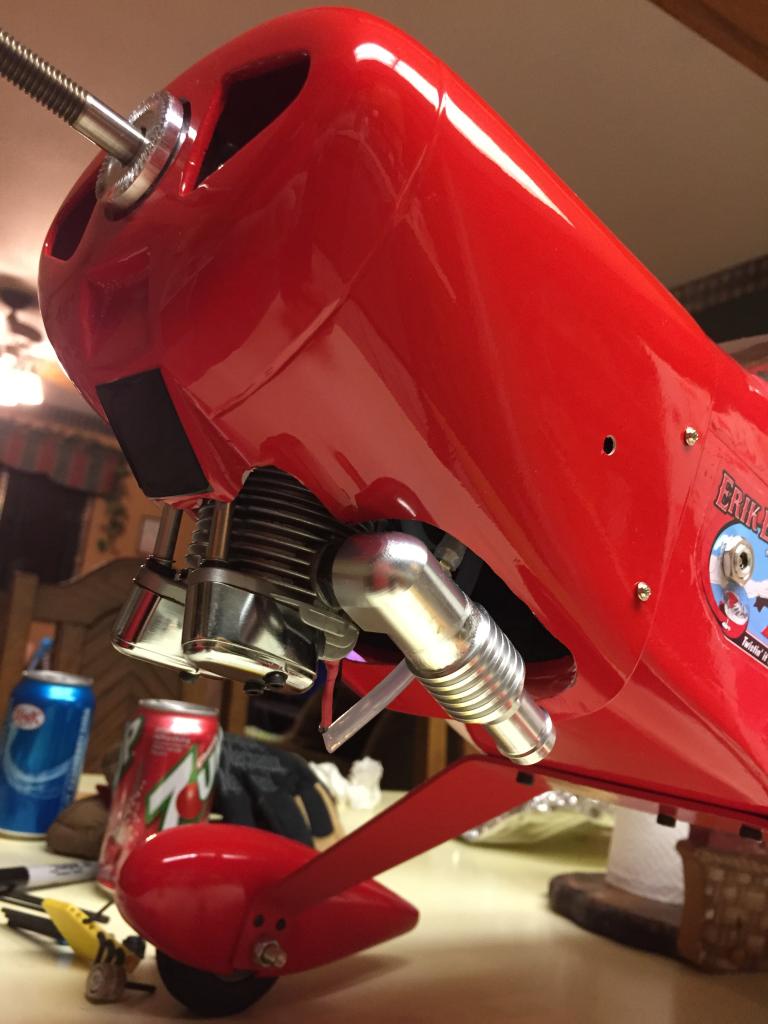

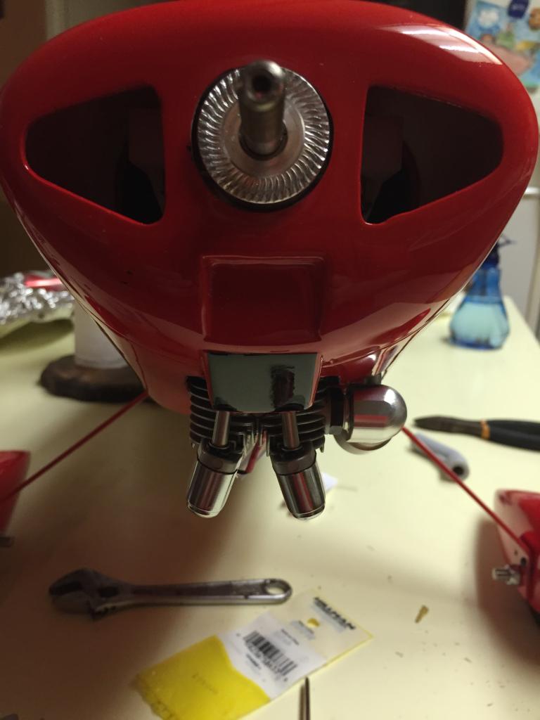

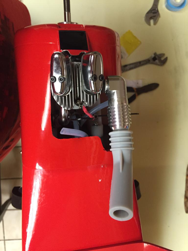

Well, thanks to landeck, I got adventurous and went ahead and cut the cowl. Pretty good size hole as expected. I was able to leave the back ring of the glass intact. It just takes holding your tongue just right to maneuver it into place. Swapped out the prop while I was at it. We'll see if this one works out. Should drop my static thrust at idle a couple of ounces. (still need to trim the bolt for the prop hub a bit... will get to that another evening)
Sorry to hear about the inadvertent ground acrobatics. My battery is way back in the tail as well. Between the same formers as yours. Sounds like my battery is a little heavier as I didn't need to add the extra lead.

Quick glamor shot after putting in the cowl and remediating the couple of minor issues. Thinking that I need a pilot sitting in there.

lunnrais, thanks for the pictures. You did a great job of installing that engine. I am thinking of installing a Magnum 91 FS. It may take more cutting of the cowling. I wish I had an OS 65V I could install.
