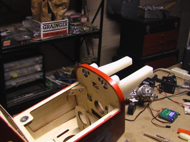

Old 01-02-2016 | 03:26 PM
  #128
Joined: Dec 2011
Posts: 36
From: detroit, MI
How did u do with the 70 tclips? I reinforced my firewall and I'm installing a rcgf 10cc with a 13x6 prop.
The 2 angle supports at the top inside firewall are hardwood. Did u resupport your firewall? What engine did u use?
Dan
Name:	TClips engine mounting 002 (640x480).jpg

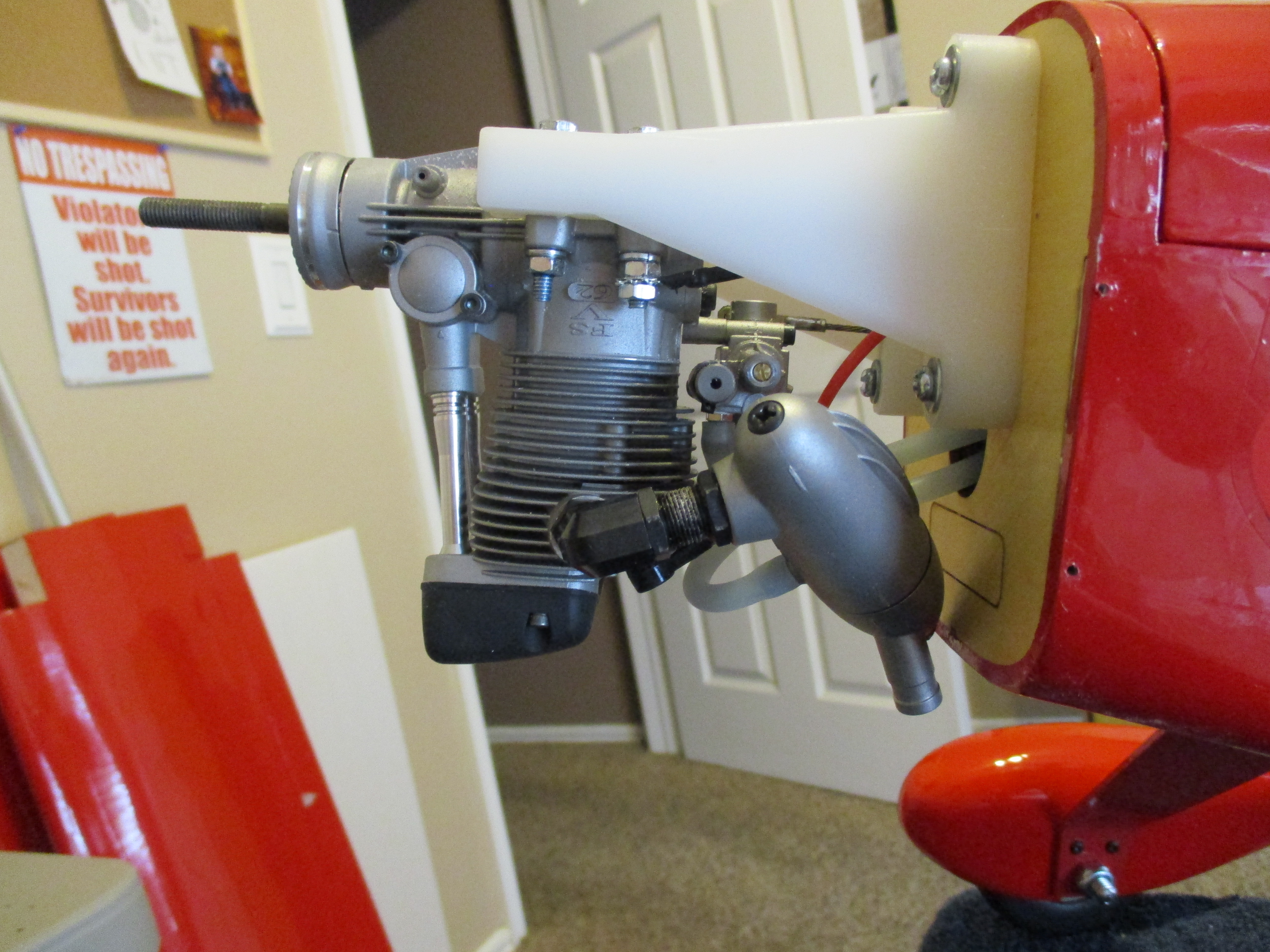

Old 04-20-2016 | 04:00 PM
  #132
Joined: Oct 2011
Posts: 88
From: claremore, OK
This thread been dead for a little while so I thought I would add this to get it started again.
Just received this today. Will get started on it this weekend. Will be powering it with an O.S FS-62V fourstroke. Should work well.
Name:	IMG_0142 (640x480).jpg

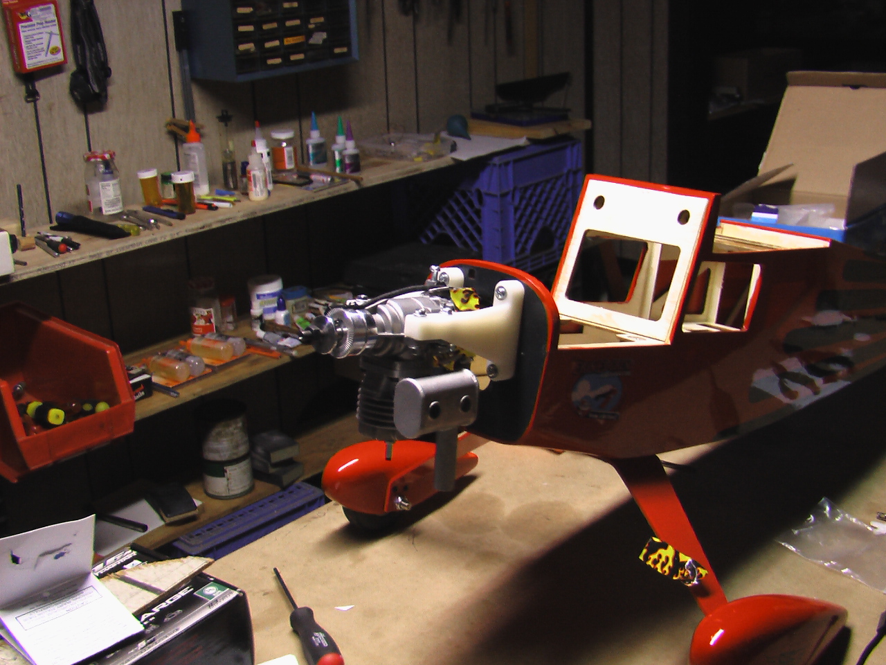

Old 04-25-2016 | 12:46 PM
  #133
Joined: Oct 2011
Posts: 88
From: claremore, OK
Have the motor mounted, used an 80 degree elbow to keep the stock muffler in the cowling, not the best job but it will do.
ID:	2159122   Click image for larger version
ID:	2159123   Click image for larger version
ID:	2159124   Click image for larger version
Old 04-25-2016 | 01:55 PM
  #134
Joined: Jan 2011
Posts: 10,075
Received 108 Likes on 96 Posts
From: Capron, IL
Just a suggestion, you may want to open the bottom rear on the cowl and baffle around the cylinder or you may have cooling issues. Having the muffler inside the cowl is going to add heat, especially where you dont want it, near the carb. I think somewhere back I posted a pic of how I opened mine up for the FG-11, and haven't had any cooling issues, yet.
