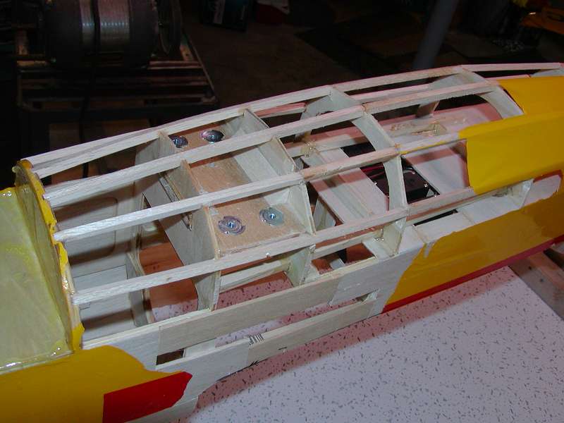

Actually, I believe I described how the cockpit is mounted on my plane earlier. Rather than gluing it on the wing, it is separate, held on by a dowel protruding from the front going into a mating hole in the former on the fuse, and a screw going through the top sheeting and stringer and into a wood block mounted on the rear compartment former. A rectangular hole was cut into the bottom/back sheeting to accomodate the wood block when the cockpit is mounted. I can post pictures if any of this is not clear.
As to an advantage of this, I really don't think it's much either way.

John, I'll try to post pictures of the cockpit mount tomorrow night.

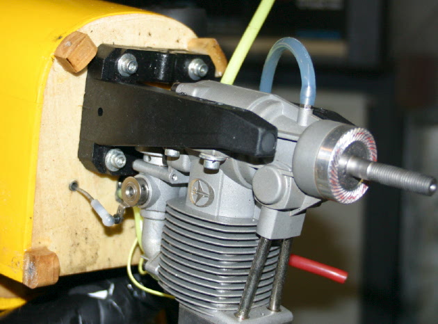

Jeff, Yeah, you remember right, I didn't build it, BUT you forgot that one of the big changes I made was to move the engine (and the cowl) BACK 5/8". The thrust washer WAS right where the instructions called for (6 5/16" from the firewall or something, I'm not at home now and can't check), now it's further back than called for. I did this because as it was the balance was so drastically noseheavy I needed to do something drastic.
Interesting that you mention the change of thrust line; adding down thrust would help with the trim and also with the cowl alignment - as with others who have posted hear, when the cowl markings are aligned with the fuse, the thrust washer (and therefore the spinner) are way out of whack with the cowl, with nearly a 1/4" gap at the bottom with 1/16 at the top. I think I'll try that first.
By the way, according to the GP web site, the incidences should be 1 degree positive wing, 0 degree stab, and the thrust 2.5 degrees down, 2 degrees right. I'll have to check mine, too.

I think your on the wrong track here. The engine mount, thrust washer and cowl alignment shouldn't be off and the stab and wing are factory set. I found when I mounted a YS 110 inverted that there where four possible variations of engine mount and engine. Engine on top or bottom of mount and the engine mount itself can be turned over so I had to figure the right combination to get the thrust washer and spinner centered on the cowl. Once this is accomplished you will have the factory settings which are correct. I think the reason they don't give them in the basic instructions is that you don't need them to successfully build this model.
As for weight, even with the YS 110 I was able to place the battery rearward and get it to balance fine. It slows down a lot for landing and flies very well.

As I said in my post "I was able to place the battery rearward" so yes it is behind the wing. Also, a few other people having the misalignment problem makes sense. The first way I tried mounting the engine it sat low and the spinner didn't match the cowl. I ended up flipping the mount upside down and mounting the engine with the top of the lugs (which were on the bottom because it was inverted) resting on the mount. This solved the problem with the YS 110. As I mentioned there are four combinations possible to get the cowl and spinner to line up correctly and you have to experiment to see which way works best with your engine.

I built the plane for a friend so I don't have it here to take a picture. The engine sit's on top of the mount inverted so you are in effect putting the bolt through the bottom of the engine lug first, then the mount. Does that make sense? If it doesn't line up that way turn the mount over and it will.

I'm not following your original mounting options premise. If flipping the mount over changed the relative angle of the engine thrust washer to the firewall, that would mean that the engine bearing surfaces (top and/or bottom) aren't 90 degrees to the firewall surface. I can hardly believe that's true. The problem as I see it is that if the cowl is mounted so that the paint lines up properly with the fuse, the cowl front surface is perpendicular to the datum line of the fuse, rather than parallel to the firewall (which I assume has the proper thrust angles built into it. This is definitely the situation with the Lancair, so it would surprise me to find it on the Shoe.
It looks to me that they forgot to put the downthrust in the firewall! Eyeballing my model, the right thrust is apparent, but there doens't appear to be any downthrust. Using the center sections (between the two main formers) of the wing saddle stringers (did you follow that?) as the zero reference, I measure 1/2 degree positive thrust (UP-thrust!) at both the firewall and the mount surfaces. Am I goofing this measurement up somehow?
The picture below shows my mount situation. This setup is academic, since I made the descision last night to ditch the finicky TT91 and replace it with a YS91AC. Another question for you Basin - is there a great deal more clearance required behind the crankcase of a YS engine (for the pump) than for a regular 4 stroke like mine?
By the way, I didn't say the other night that I had no problem handling the Shoe (other than getting the darn thing to stop
), even keeping over the boundaries of our recently reduced field airspace while taking it through all the basic manuvers. So I've pretty much convinced myself that I can fly anything at this point. Warbirds, here I come!
