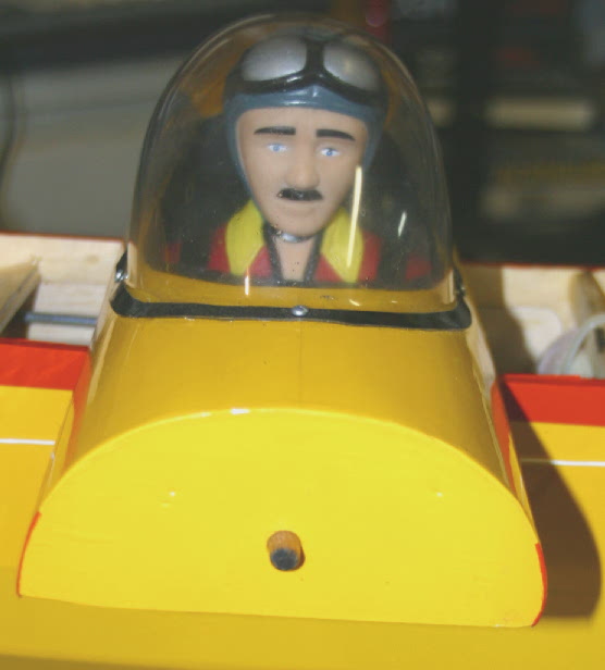

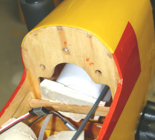

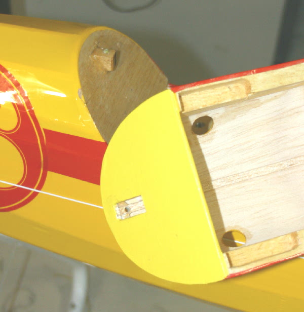

In answer to the earlier request, here are the photos of the cowl mounting. Once again, dowel in the front going into a hole in the front former, and a screw through the top in the back going into a block on the wing saddle former.

Rick,
It's not the angle that's the problem, it's the position of the thrust washer so when you adjust the cowl to center on it the cowl may be pointing up or down which makes it not square to the backplate. By turning over the mount and placing the engine on top of it (inverted of course) it places the thrust washer in the center so the cowl is in the proper position.
I wish I had it here to take a picture because I don't think I'm explaining it well enough.

Does my mount in the above pic look like the stock one?

Yes, the stock mount is a two piece.

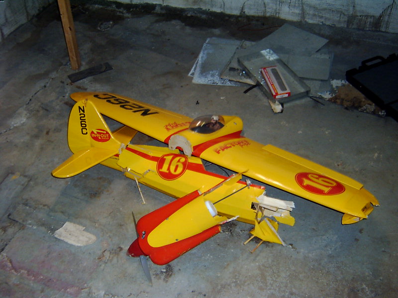

Sad day A little over a week ago... I'm in NY and been waiting for spring. Been flying in tall grass and high winds. Grass was real tall at the field and had 3 great flights but was having trouble with my Shoestring nosing over on taxi so I was being lazy after walking out to get it a couple times and took off from where I was standing. It was a hard cross wind and probably a little down wind.. STUPID I KNOW... Here is the results... SUCKS... Will get another one... Love the plane too much not to have one.

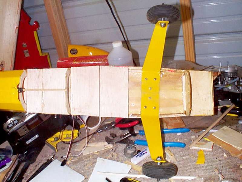

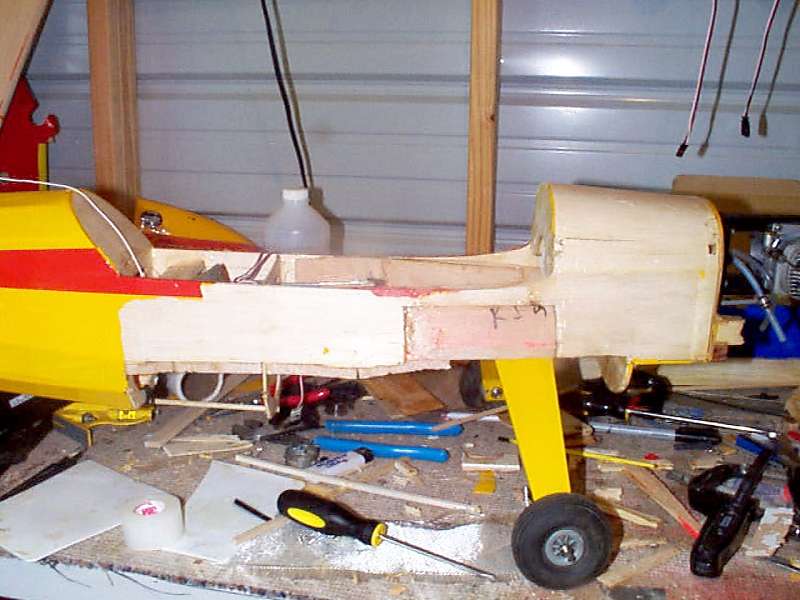

Well, I finally got it in decent shape again. It's a "Frankenplane", but it will fly and that's all I can do for it. Below are a couple of pics of the butchering, errr I mean repair job I did. Keep in mind this is a major improvement in my building/repair skills. Also, this is the second repair on this plane. I just love to ressurect it again and again. It will fly this weekend if the weather holds. Only covering remains and that's an easy task.
P.S. Not a word about my messy table

OK so now I feel guilty... mine is repairable... I hate to take the time. All I have to do is run new stringers from back to front... and CA a few spots... Promodus you are making me feel guilty about not doing the repair... My repair job would be Waaaaaaaaaaay less then yours. Show me the pics of yours re-covered... Maybe when winter returns...
