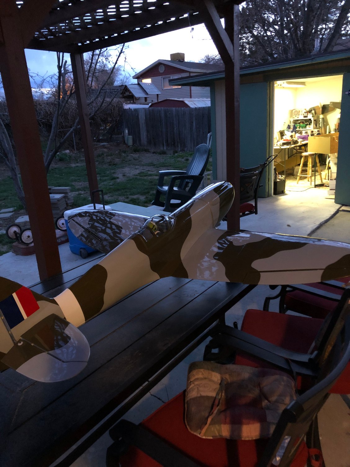

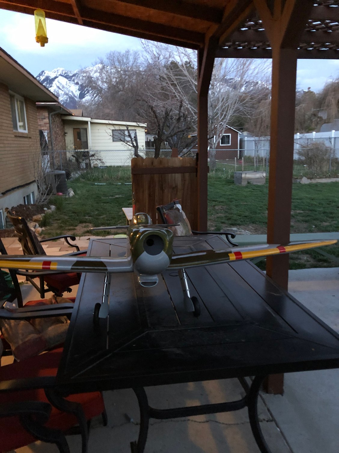

Old 04-04-2020 | 07:20 PM
  #40
My Feedback: (10)
Joined: May 2003
Posts: 155
From: Utah
Mine is almost finished... I had a couple of 20cc engines hanging around and am looking at downsizing my fleet from the large scale birds to something a bit easier to haul around and put together etc.. getting old here! Losing the excitement of flying the large birds.. this looked perfect, .60 glow size is too small and this Spit looked great. I bought those HK retracts! Love them ... plane is about ready... everything went together pretty well thanks to all the comments here on this thread.. Big thanks!
Old 04-05-2020 | 03:26 AM
  #41
jstanton's Avatar
My Feedback: (14)
Joined: Aug 2002
Posts: 3,257
Received 26 Likes on 26 Posts
From: Millington, TN
Looking real good. I have the same HK retracts and they work great. Good luck on your maiden flight. Mine is a good flyer and I agree with you on the size if the plane.
