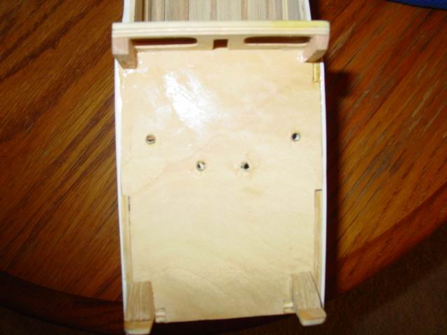

I just picked up my new Razor 3D ARF, when I first looked it over at the hobby shop through the plastic bags I thought it looked great. I could not wait to get home to get it all out and begin to put this wonderful looking plane together.
As I began laying everything out and looking everything over a different picture began to develop.
First I noticed that the firewall is slanted to one side, further observation showed that the blind nuts for the engine mounts were not in the center of the firewall but off to one side. I began to look over the fuse even more and noticed a gap in the top portion of the firewall, cracked ply in one of the formers and two cracks in the bottom deck just behind the firewall.
To top it all off the fuse had a fair bit of hanger rash and several low spots where it looks like someone sanded way to much before covering. There are plenty of dings and dents all over the fuse.
I also did not see a QC label on the inside of the fuse like the wing and other parts have, but did find a bunch of scribble from a pen as if to mark it or such.
I will be calling lanier in the morning....Will update the thread.
Here are some pics.

The firewall should be slanted...
Its probably slanted slightly right and slightly down. This helps to compensate for the torque of the motor and deliver right/down thrust. By placing the engine that way, you won't have to artificially have your rudder control surface with a constant left turn in it and your elevator with a constant down in it. The result will be more equal control surface throw.
The more slant, the more the designers probably figured your going to overpower the plane.
As far as slightly cracked firewall formers, some questionable sanding, some slightly loose covering...I've never seen an ARF that didn't have at least one of those issues. Hell, even when I build a model its going to have at least one of those imperfections. And if it doesn't, it will after the first trip to the field...if nothing else but minor hanger damage. Now, if the covering has puncture marks...I would say that goes into the unacceptable range.
For all what you said, I would rate this ARF a "C"....there are worse, there are better....
I would probably just epoxy the firewall cracks if they weren't too bad and there was only one....but you didn't include pictures of that.

Sounds like limited experience is complaining here. Off center mounting holes on a slanted firewall is built in right thrust with offset alignment to center the crankshaft back onto the fuse centerline.
I have assembled several Lanier/Goldberg ARF's (Ultimate and Extreme 3D) and found them to be very high quality. The low price of the Razor may indicate they come from a different asian factory.
I find it amusing many folks will whine about some imperfection in an ARF, especially the low prices ones that you couldn't even come close to building one for that price, and probably not come close in the quality too.

It is easy to see that the plane has right thrust built in. The offset holes are so the shaft of the motor centers in the cowl.
I see nothing else that really bothers me in these pics. YES there is a slight void where the nose sheeting doesn't quite meet with the firewall, but nothing a little epoxy and perhaps some microballons wouldn't fix right up.
I don't see any of the other "issues" the fella had, but it COULD be that he's misinterpreting what he sees as flaws when they are common items.
A heat gun or covering iron can srhink covering and pull it away from former tabs that may LOOK like "someone sanded too much" but in reality were sanded below flat for a reason.
Not saying he didn't get a bum deal, just that the pics only show ONE minor flaw and the rest show his lack of experience.

Everyone has some valid points here, it is true that I lack experience as this is my 4th plane. I have a Hobbico Superstar trainer, GP Big stick 40, and a SIG 4*60 kit.
So yea my experience is limited you are right about that.
I took this plane back to the hobby shop and was told these were common issues and to take the plane home and build it.
I looked at another Razor that was in the shop and although it was rough as well it nowhere near as bad as mine. I expected an offer to have it returned or replaced but none whatsoever. I can tell you where I wont be buying anymore merchandise from for sure. I think I will just stick with Tower which I have always had tremendous service. In the past they replace issues like this without question.
Anyway I am building this plane, I have found more issues inside the fuse where one rear former was crooked and not glued properly. The light ply inside the fuse for the bellcrank had a big gob of glue between it and the fuse wall so it would not sit flush. I had to remove it and add another piece.
I am having to put a lot more work into this plane than I expected but I think it will turn out o.k as long as I can keep the weight down. It has become a more of a challange now and also a learning experience.

Should anyone as a consumer sacrafice quality or being content because a shop owner has a heavier load to carry than Tower?
Certainly not!
A shop owner runs his own business and if they cant find a way to compete with Tower thats not my problem. I have another local shop that DOES make sure the consumer is happy, I buy there when I can. They are however limited in what they carry so like I said earlier, I stick with Tower mostly. They dont seem to have a problem with competition, and everytime I go in there its packed with people with smiles on their faces.
Dbow
