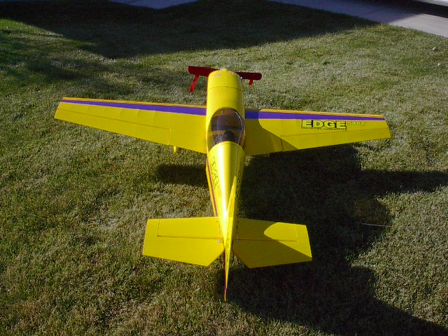

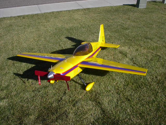

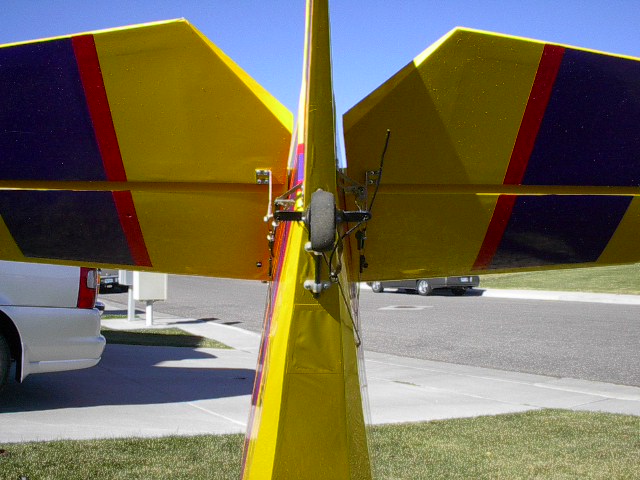

Eric, sorry but I gave you some false info. My friend only moved his servos rudder and elevator both as close to center as possible. Rudder on left side of fuse and elevator on the right side. But he did change some of the control horns on the elevator. He purchased a matched set of sullivans so that all control horns were positioned evenly on the elevator. This works perfectly now. Here are some pics.

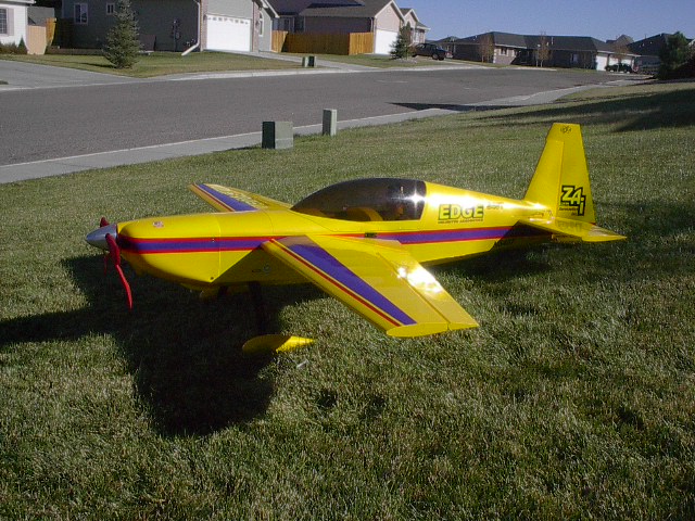

Here are a couple of extra pics. This is powered by a Mki 2.10 and flies great.
