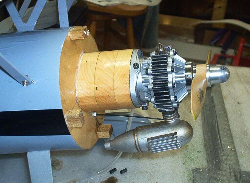

I am finishing up the Waco 30 as we sit here. (well I would be if I wasn't in here typing) I used the OS Wankel engine in mine but the plane was designed around the Magnum .30. I am putting HS81's all around for servo's. 5 of 'em 'cause the wings take two. The plane came out very tail heavy with the engine mounted in the stock location so I moved it forward as far as I could and balanced it on the aft CG. The hinges that ship with the kit are very stiff after I glued them in place so I think If I were you I would swap 'em for some after market ones. CA hinges are fine but the ones that come with this kit are the cheap round ones and very stiff. I should get a test flight in on mine thursday (I hope ) Good luck with yours.

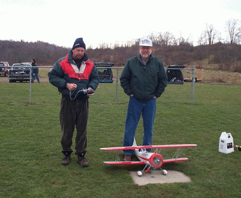

Here she is:

Old 10-23-2003 | 10:09 PM
Joined: May 2003
Posts: 843
From: Springfield, TN,
Default RE: What Engine For WACO 30??
that little rotary trips me out dude, what is it about the dia of a silver dollar?
Miloh.

Naaah, It's about 2 inches tall and 2.5 inches wide as it is mounted. In order to get the CG right I had to build a bigger mounting block then the engine itself!

Only size listed on the web page. I agree with you though it would be a great engine for something like the Sukoi or a Stearman. Seems to produce a ton of power too. It didn't have any compression when it came out of the box but after 4 tanks of fuel it is getting much better. The big problem is the price. It lists for around $350. I got mine from the local hobby shop for around $260. but I think he gave me a pretty good deal 'cause they had had it for a while. The way these engine manufacturers price their stuff, a .60 would probably run around 500-600 bucks.

Jackster, Mine makes a ton of torque, turns a 9X6 about 16K and sounds like a hornets nest at full song. It has a puke tube like a 4 stroke and does seam to put out a lot of oil over the bottom of the plane but then it's not really broken in yet. as to whether it will fly a larger plane? Can't really tell you as I have broken 4 props in 5 atempts to fly it and dead sticked on the 5th try. I don't really attribute this to the engine, more to the short coupling of the Waco 30 airframe. I think the deadstick was a fuel delivery problem as I am using a great planes fueling valve that I have my doubts about. Gonna remove it before the next attempt. The engine makes enough power that it feels like it would take off right out of my hand if I would let it but bipes need a certain amount of airspeed to fly so I don't think that is an option.
