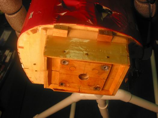

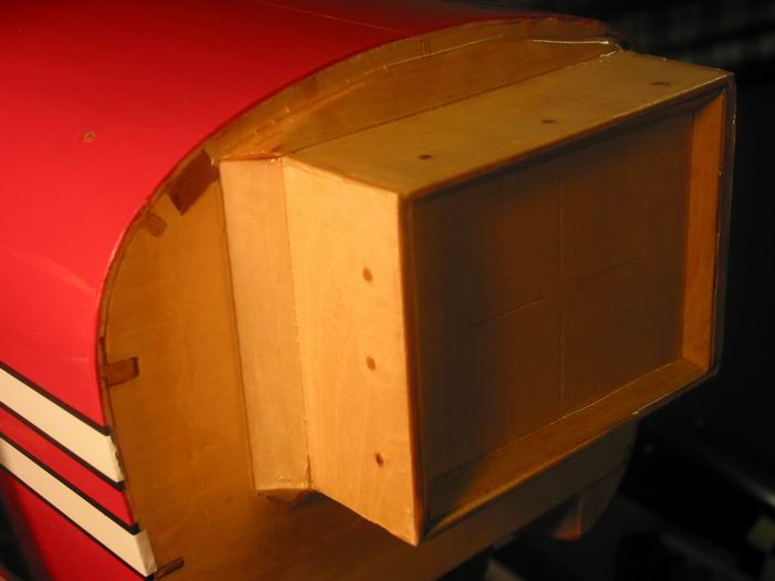

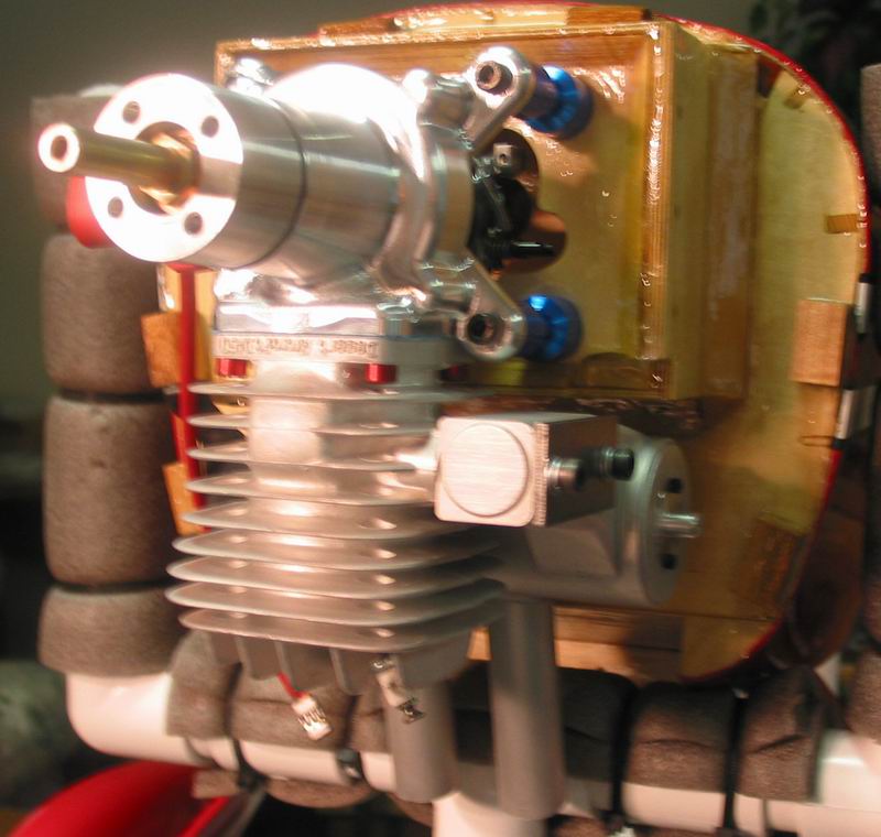

Boy, you ask for a lot, but I'll try. For the others, these are things that I have done and they work fine. My finished Pitts weighs 16.5 lbs. with a Brisson 3.2 and is a superb performer.
Your BME will do just fine. More power than you will know what to do with. Add some 1/8" ply strips inside the engine mounting box for better support for the blind nuts that you will likely want to install.
Add your choice of corner reinforcements at the inside of the fuselage/firewall junction. Without them my firewall pulled loose from the fuselage.
Cut an access hatch at the bottom of the firewall in the lower angled section. Throw away the piece you cut out and replace it with a new 1/8" ply access hatch laid completely over the flat angeled section, fitting it between the raised sides. Space your cuts to be 10mm inside of all the raised edges to permit for screw fasteners. I used wafer head servo mounting wood srews for this. The opening gives you access to all the areas you will want to strengthen or change. The access hatch also provides a mounting location for your ignition battery. Mine is attached to the hatches interior.
I added additional plywood bases and blind nuts at ALL the cabane to fuselage mounting points inside the fuse.
Remove the small balsa tri stock at the engine box and install 1/2" balsa tri strock after adding 1/8 plywood doublers at all exterior sides of the mount box.
