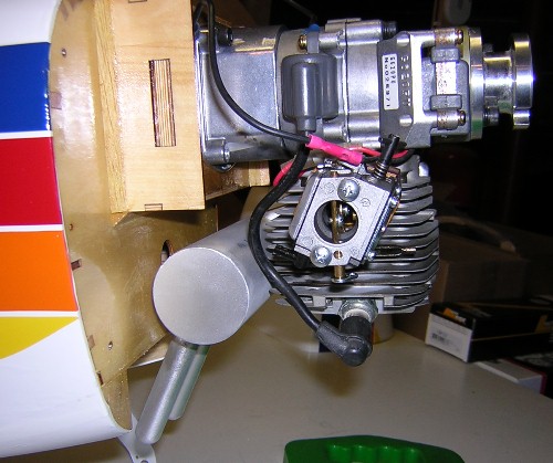

Old 01-11-2004 | 08:59 AM
My Feedback: (34)
Posts: 840
From: Waukesha, WI
Default RE: Best Engine for GP Christian Eagle?
I put in the Zenoah G-62. It fits great! The Bisson Pitts Style muffler is beautifull. It is as if they made it for this kit! Check out the installation in this picture. Spinner backplate was supposed to be 6-1/2" from the firewall. With this B&B cup style mount it is 6-5/8". Close enough.

Old 02-05-2004 | 10:24 PM
Posts: 4
From: garland, TX
I have an old g62 that needs a good home and I was thinking of this plane..how does the cowl fit..the balance etc
Old 02-07-2004 | 07:45 AM
My Feedback: (34)
Posts: 840
From: Waukesha, WI
The cowl fits perfectly. It is as if they where made for each other. I was just shocked how well it went together. I have not gotten to the point of balancing it yet. I expect it to be a bit nose heavy.
