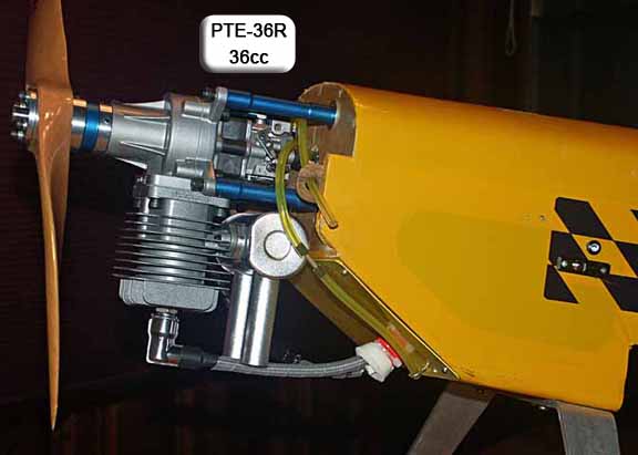

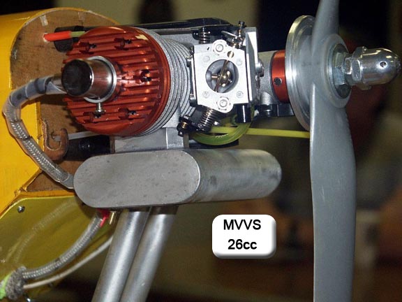

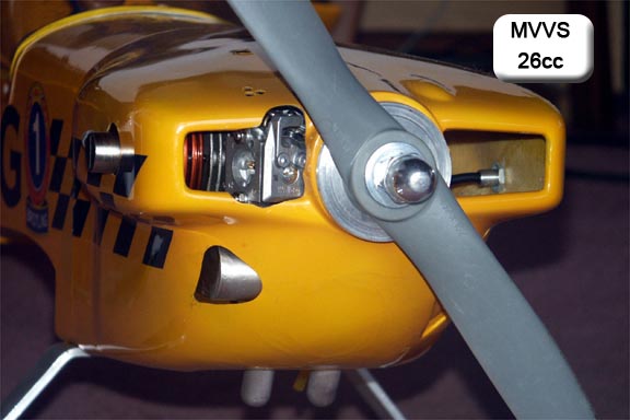

My CAP231EX was originally powered by an OS 1.60FX 2-stroke glow engine with a Bisson Pitts style muffler and the performance was great with unlimited verticals.
The CAP's next engine was the excellent MVVS 26cc gas but those gas 26cc's weren't enough to haul this model around like the 26cc glow (OS 1.60). It ran out of steam going vertical.
The CAP regained all of it's great performance and unlimited verticals with the installation of the 36cc PTE-36R gas engine.
That old adage, "there is no replacement for displacement" applies here. Twenty cc's would be way too lethargic for my taste.
