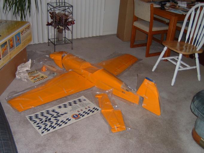

Here's a pic of her brand new during the initial box opening ceremonies.
I'm going to be using the Tower "System 2000" TS 65 BB high torque servos throughout. Anyone have experience with these servos? Also, any info. on engine, fuel line, on board glow etc setup would be appreciated too. I'm putting the OS 160 in this one.

Use a metal gear servo on the rudder and large fuel tubing. I wouldn't go for the onboard glow unless it's something you really want. The engine is mounted on it's side, so its very easy to get to the plug. Start with an 18X6 prop, this will help keep the speed down until you get familiar with the plane. Use a computer radio with dual rates and exponential. If you're not familiarwith these, ask for help. I have seen what can happen with this plane when setup with too much throw and no expo put in. They fly great (mine is being recovered) so I know first hand. Seal the hinge gaps as previously stated. Good luck.
