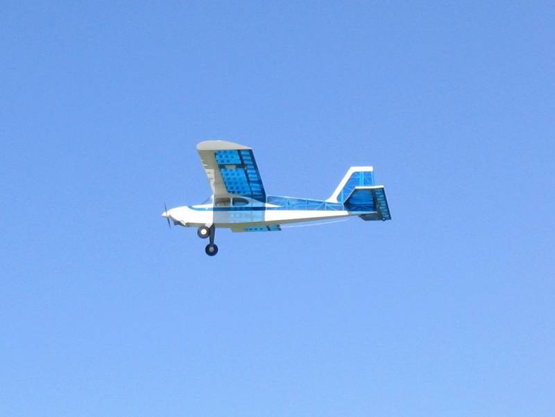

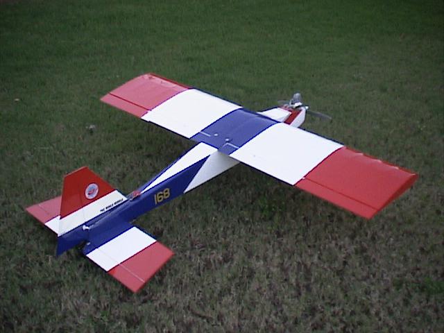

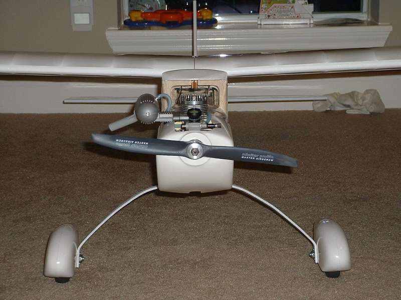

Finally got my Kadet Sr ARF finished up. Took a little longer because of my adding the wheel pants, but I really wanted them on this airplane. For your reference:
Main gear: modified GP 1/4 scale Giles 202
Tailwheel: Ohio small 6-12lbs
Wheelpants: ABS plastic, from a Lanier 35% Giles I upgrade to aftermarket fiberglass ones
The Kadet, as shown, balances right on the main spar (~4" back from LE) with the flight battery pack just ahead of the wing LE. Perfect. The ASP .75 is way more power than it needs. A .60 would have been ideal but I don't have one, so I put on the mildest .75 I got. All up weight is 7 lbs 10 Oz. I could have easily kept it below 7lbs by removing the wheel pants and using a lighter tailwheel assembly, but with such a big wing, weight is not a concern. As is, the wing loading is only 14.9 Oz per sq.ft.
The tailwheel mounting area is reinforced with a liteply plate cut to fit inside the fuse. I could have added the ply plate on the outside of the fuse, as I have done on other planes, but this plane has easy access to the inside. This way I didn't have to mess with recovering.
The main gear mounting area is reinforced with double ply plates, as well as ply stiffener braces on the fuselage sides. I also replace a section of the balsa fuselage bottom, as I didn't want the gears to sit on soft balsa. Six 8-32 bolts and blind nuts secure the main gears to the fuse.

I have done other tail dragger conversion that were a lot more extensive. Here's an example of one that had reshaped rudder and split elevators. It started out life as a Wolrd Models Super Stunt 60, shown in the first picture. I prefer spring pull-pull setup because I fly mostly off grass and the tail wheel steering connection needs to have some "give". Otherwise the rudder servo will take a real beating.

fwthomas, I just noticed a reply I wrote for you here got lost somehow. Here goes again:
Mods to the GP 1/4 Giles 202 ARF gear:
1. Trim the upper mounting tabs to fit Kadet fuselage.
2. Drill additional hole as required to mount gears to fuselage.
3. Spread the bowed legs out a bit, both to widen the stance and to lower the nose.
4. Bend the lower wheel mounting tabs to be veritcal again.
I really like these Giles 202 gears. They come two-piece and are very versatile. Very reasonably priced too. I have used them on two other taildragger conversions.

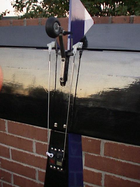

I just finished building a kadet lt 25 and it has a pull pull system in it . maybe you can find a set of plans to fabricate a set for the senior .looks like it would be easy to fabricate

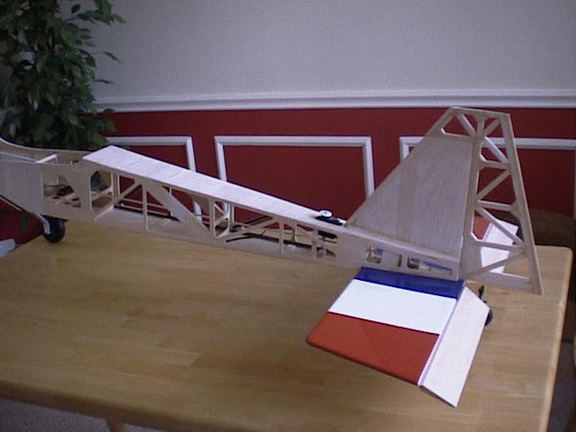

Just wanted to let everyone know that there are still people out there converting Kadet Seniors to taildraggers. Mine's about done.
I actually removed all the covering from the bottom of the fuselage, glued in a structure of lite-ply and tri-stock for the mains, and a lite-ply plate for the tailwheel. I used pull-pull cables for the tailwheel steering. Not a hard mod to do at all. Mounting the Saito .72 inverted was a bigger challenge than the tailwheel mod!

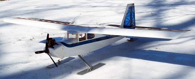

I have a kadet senior that was built in 1986 my first plane. It flys today as a taildragger with main gear moved one former forward and a free caster tail wheel. The senior has so much rudder that TO's aren't a problem. Ground handling is poor without direct tail wheel control, but if plane is placed on the runway TO with full up elevator, full throttle, ease off up elevator as speed builds then rotate for TO. Stearing on roll out is not a problem. Satio 65 for power and standard 3 channel
