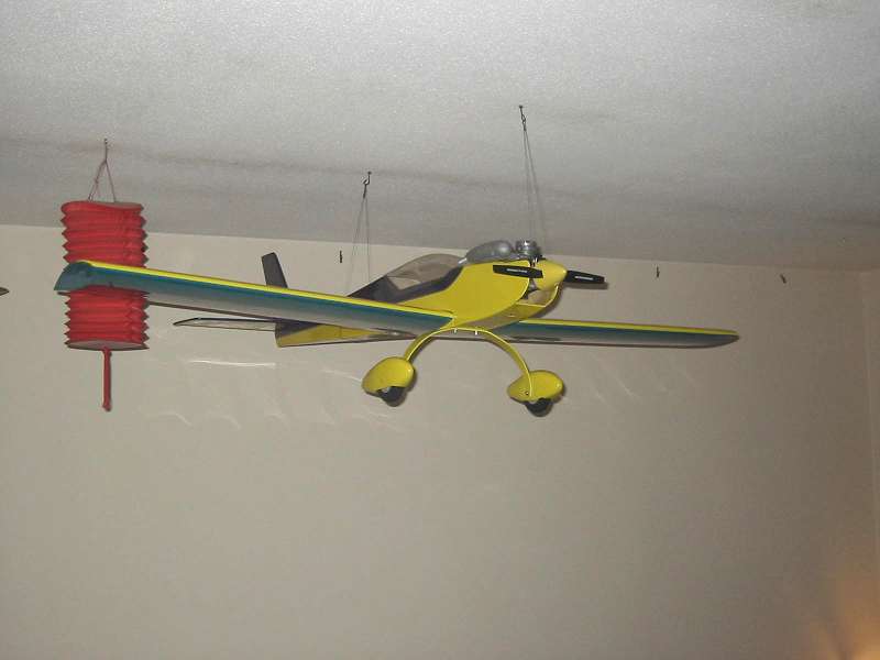

When I did my friend's conversion last year (after a crash...I was rebuilding it anyway) I took a piece of 1/4" ply, large enough to support the aluminum gear, recessed the ply into the fuselage so the bottom of the fuse still "flowed" and then epoxied the ply to the fuselage in front of the wing and then glued some 1/2" tri-stock inside to spread the load to the fuselage sides.
Then add a Klett tailwheel.
It's been through hell and has no sign of wear. Hard to believe the plane below was smashed to bits from the leading edge forward. I also sorta kinda cowled in the motor so it looks good
Don

I added a picture to #9 to sort of reinforce the theory of "don't throw it away until it's been sitting for a few days".
The plane was flown into a tree trunk and was pretty much toothpicks from the leading edge forward. My friend said he was going to toss it and I said to let me see what I can do. I think the end result speaks for itself. I made up the whole front end using the TLAR method (That Looks About Right) and cowled in the bottom.
It's still a sweet flyer.

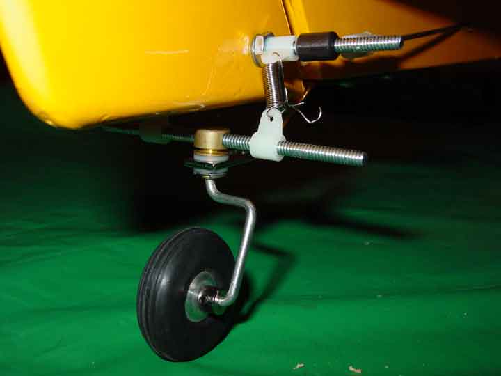

Someone is got to help me out here.. Im slow, and the lack of decient instructions has gotten me confused. I got the conversion kit and the tailwheel is something else i tell you. Two long threaded rods, one goes through the rudder and one through the tailwheel hub. Anyway. Those Springs. how on earth are you supposed to attach them? There is maybe half an inch - 1 inch between the two rods and the spring is like 2-3 inches long. Do i need to cut it? Anybody got pictures of their tail wheel setup? Im really not liking it at all.
I have noticed there is a lot of slop from the tail wheel hub through the wheel, is that good? It just wobbles..

Well the wobble is the whole unit itself. the axle wire which is then going up through the hub etc. the wheel itself is allready a snug fit, so thats not it.. Ill post a picture when i get back home. Ill tell you i was about to rip the whole rudder off. It was really begin to irritate me.

glowplug,
I dont really care about the wobble thing, its the whole spring thing that was really pissing me off.
I also bought the ohio superstar tail wheel, I like it a lot better; then again its the springs... ARGH

As I promised, here is the pics of the tailwheel setup. Ill tell you looks all narled up. The kit (Carlgoldberg) came with 2 long threaded rods. Looks like crap!
Im seriously looking at the dubro tailwheel bracket that goes right into the rudder with no springs. Ill use a servo saver instead.

That doesn't look anything like the Klett tailwheel assemblies I have bought. They must have changed the design.
That doesn't look like it will work too well, it may be better to go with the Du Bro model although the Sullivan model works nicely too. http://www2.towerhobbies.com/cgi-bin...?&I=LXFV47&P=7
