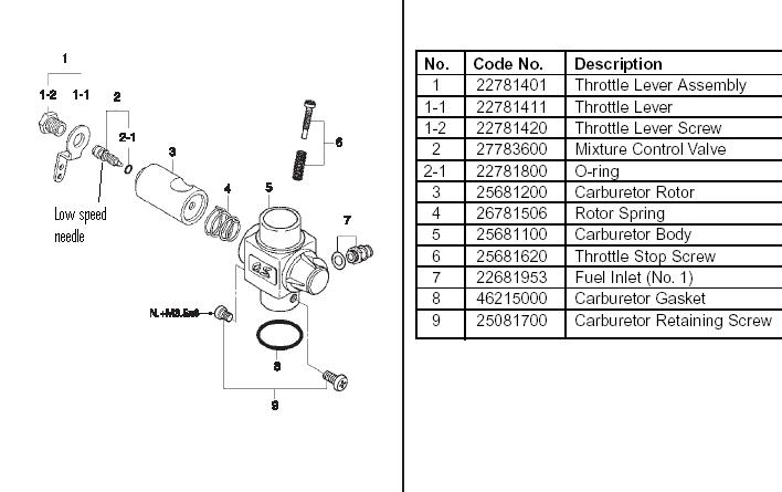

My new Nexstar has the OS .46 FX engine in it.. For some reason they didn't put the FXi in it.. Is there any difference in the two.. All I could find is the FXi has rounded cooling fins on the head and the FX are straight.. Also the needle valve mount is not part of the engine case on the FXi..Is there any performance differances in the two..Thanks...

I doubt the FX performs worse than the FXi -- my guess is that it performs better... The 46FX is a great little engine and will pull your NextStart around very well. They are easy to tune and should not give you any trouble at all!

I believe the FXi engine comes with an air-bleed carburator, whereas the FX has a twin-needle carb. The twin-needle carb performs better and is more precise, that's why they are on the more-expensive engines. You can tell the difference by the tiny hole on the front of an air-bleed carb. Sounds like you got a good deal!

No, it's definitely not an airbleed carb, it has a low speed needle, like the fx. The carb looks exactly the same, just has the limiters. The performance is the same as the fx. Here is a diagram of the fxi carb
