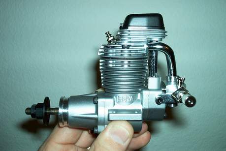

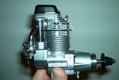

Here's the Enya .53 Four Stroke....

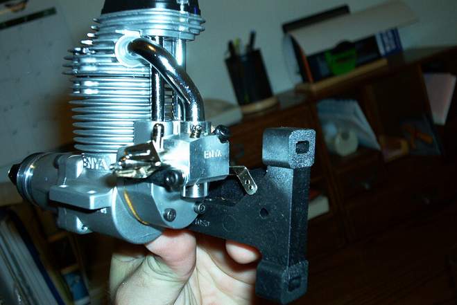

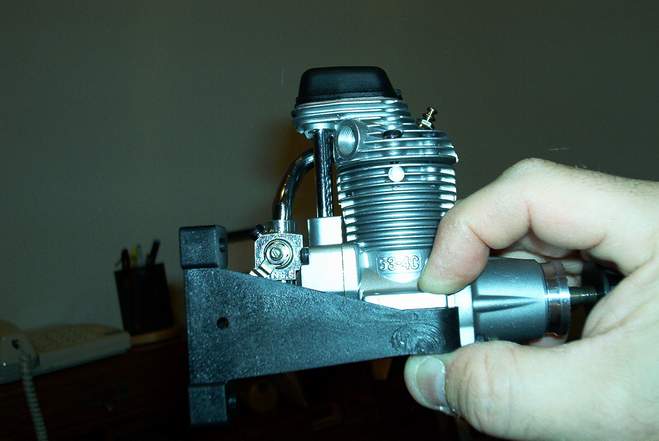

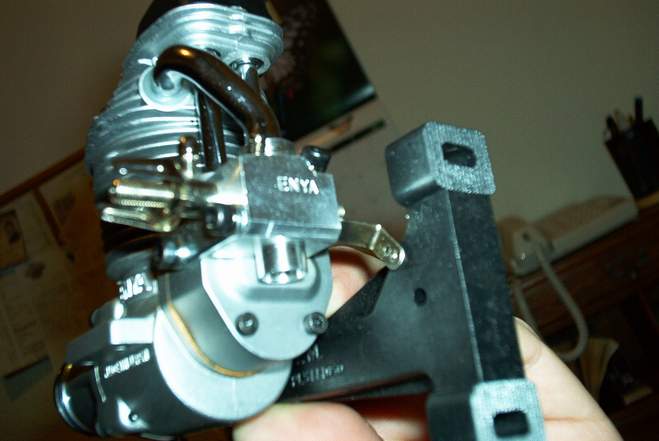

This is the dilema I'm facing! The throttle is close to the beam. If I try to mount it from the out side, I would have to grind ALOT of the mount away. Probably too much!!!! I do not believe there is enough room to mount linkage on the inside, straight shot due to the movement of the lever on the carb lever....
How in the &#&*(@$@^$@*^!)*&!#$ do I throttle, and run linkage to this ????????????????????????????/

Hi Dennis. Sorry for delay. On weekends, I'm in competition with my 14 year old (female ... there the worst!) for internet and phone time. I would be surprised if you can not reverse the throttle arm on the Enya so it's above the engine mount? By the way, I used the stock mount on my Rambler for my Magnum 80 FS. It should be fine for the Enya. You can mount the engine either way. I would probably mount it upright for your needs. Flyboy1950 (Bob)

Bob, with the carb lever secured upright, it looks like I will be able to have a shot at hooking up the throttle linkage W/O any major problems. I just sat the engine near the engine mount location on my W.M. SS40S, and the throttle linkage from that airplane almost lined up. It was a bit lower, but I believe if the location is near that of the SS40S it would work. If not, I will pobably try to re-drill a new path for a new throttle line to attempt to make it work.

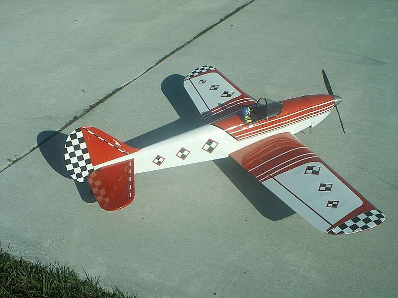

Hi Dennis. My Camera and computer finally made up and there talking to each other again. Here's a couple of shots of my modified Rambler 45! Flyboy1950 (Bob) P.S. Underside of the wings are Black/White check.

Wow, the recover job makes the plane look like no other Rambler 45. Heck makes the plane look like a totally different plane all together almost. By the way nice DynaThrust propeller. What size do you use with your Magnum .80 four stroke anyway? I sure do like the 15 sized DynaThrust propellers. The foil and thickness sure does jump to a different size when you jump from the 14 inch size from their 15 inch size....

Hi guys. The engine is inverted and it has a 13/8 in that picture. It's quite fast! I recently tried a 14/6 on it and it just about hovers. I'm getting around 7000 rpm static so I think a 15 would be too much. 3-D is not my passion but I like the performance with the 14/6. The Dynathrust props are a great value however I had one (brand new) fail in flight on a Topflight Corsair (65") and I got real lucky. I dropped the nose and put the Corsair on the ground fast and when I got to the plane the entire nose including the firewall was hanging off.
The Throttle cable was the only thing keeping the nose and the engine on. It was an easy rebuild but could have been a total waste! A close look at the prop seemed to imply a weakness in the casting. The Rambler has great scale lines. The new finish really makes it stand out. Thanks guys! Flyboy1950 (Bob)
