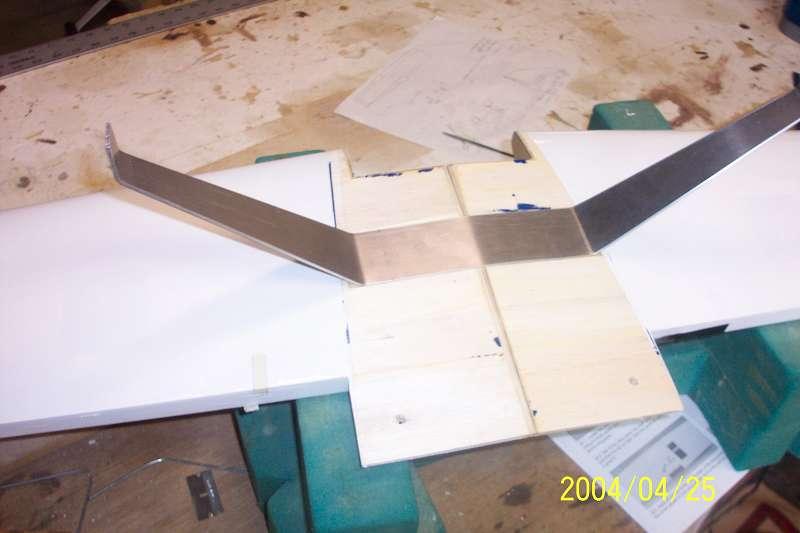

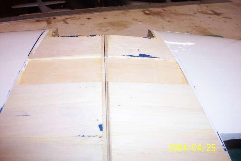

Okay, guys I got the gear down to TnT Landing Gear www.tntlandinggear.com and had them make up a one piece gear. The initial fit looks really good. I took the stock gear down to the guys along with the wing, to make sure we got the right amount of diehedrial bent into the gear.
The second picture shows that i've removed the portion of the root rib that will now accomodate the one piece gear. Also, i'm now ready to fiberglass the center section by removing the covering.

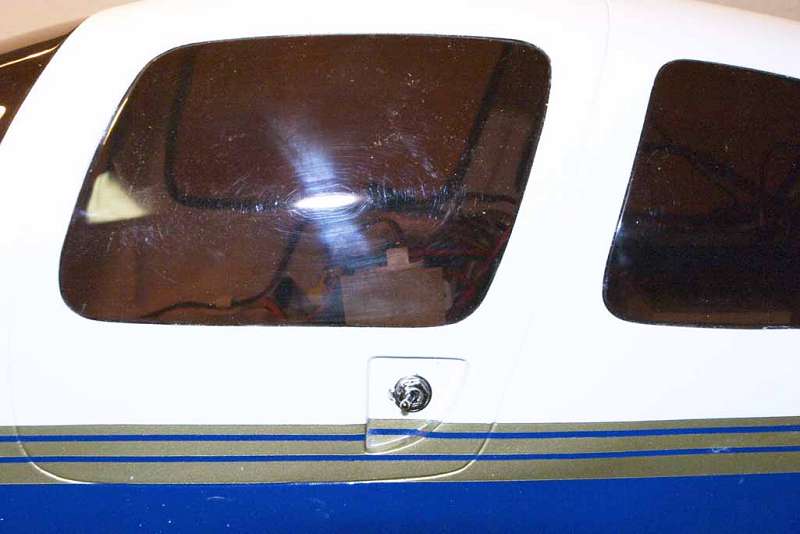

I noticed on another thread that somebody glassed around the baggage door for strength before cutting it out. I ended up running rails over the door to support the subfloor which seems to have given adequate strength to this section without glassing it. The door itself has a shaped former for strength.
Al,
You may be referring to my post about glassing the door, although you got it partly right. I cut the door out first, the cover it with duct tape and tape it back into position from the outside. Then glass the inside of the fuse around and over the inside of the door (the glass won't stick to the door though, because it's covered in duct tape, which epoxy won't stick to). Then remove the door and trim away the doors opening in the fuse to all but a lip for the door to rest against all around...no former needed on door.
Way better method than just applying a couple of wood "stops" around the inside of the opening.
Hope this is clear. It was not done so much for strength, but simply looking like it should...the way it would if they did it in manufacturing.

I received the new one piece landing gear and installed it without problem. I had glassed the center section in three pieces so the original measurement worked just fine. I checked the balance and only had to add 3/8 ounce. I'm real happy since the Saito twin is several ounces heavier than a similar single. This worked because I used a 1300 mA 5 cell receiver battery and on-board glow driver battery all mounted well aft of the hatch door. I'm really happy with the finished product but now I'm afraid to fly it. I think I'm going to wait til I can find one of the club's best pilots for the shake down flight. Hopefully I can do that in the next month. Stay tuned.

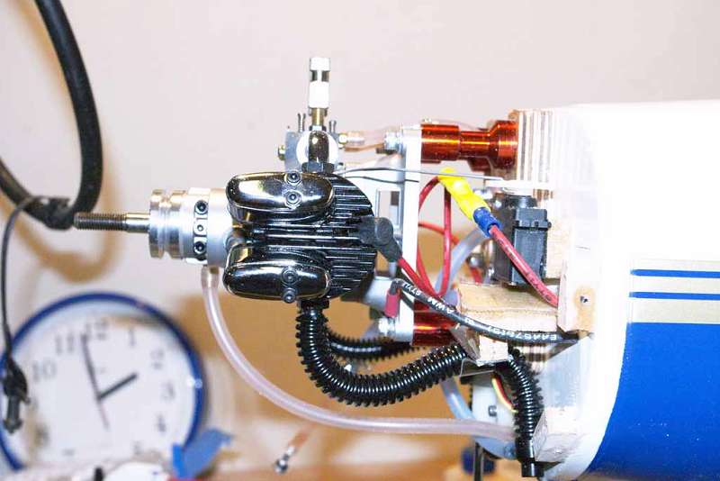

I'm going to try to upload my first picture. My apologies in advance if I screw this up. This pic is from below showing the muffler attachment. The brackets are mounted on hardwood blocks attached to balsa. This was reinforced with fiberglass cloth.

Here's a side view showing the throttle servo. The micro servo is attached to a balsa spacer with double-sided tape. The spacer is glued to the firewall. The red standoffs were purchased from [link=http://www.aerografixs.com/]aerografixs[/link]. I laminated 1/4 aircraft ply with the outer layer attached to the standoffs then glued to a second layer to recess the bolts. I used two vertical strips each about 1/2 inch wide.

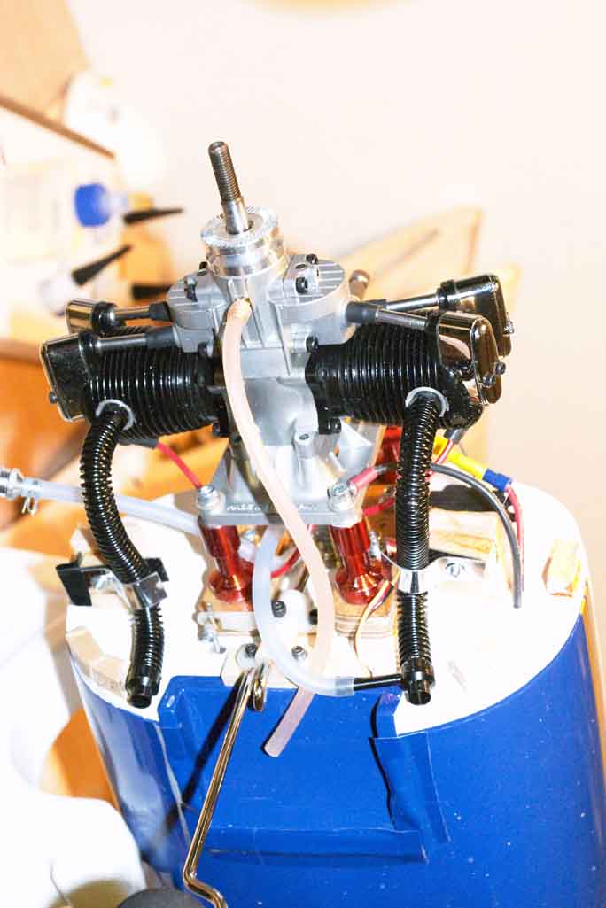

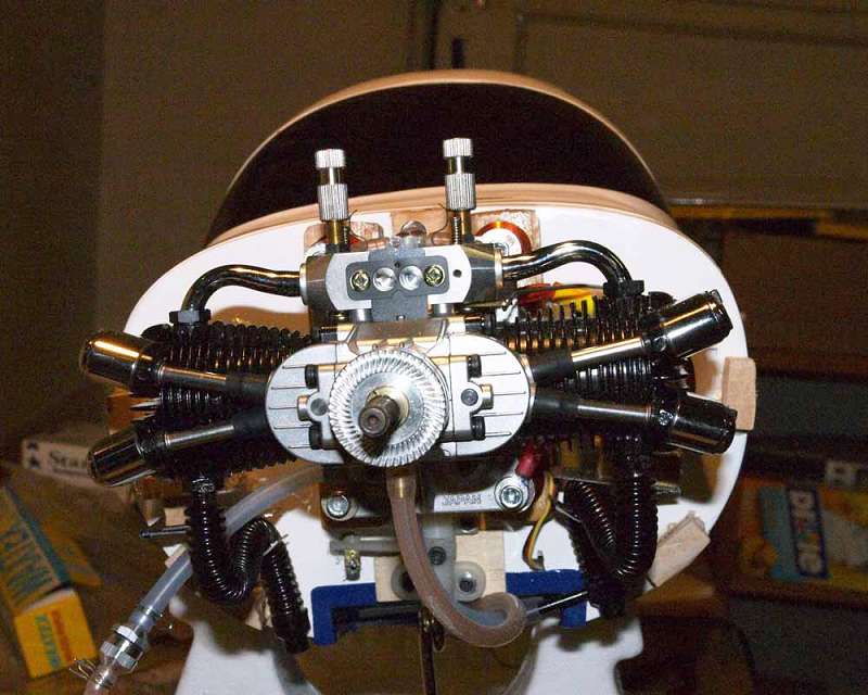

Here's a front view of the uncowled engine. Note that the needle valves stick up well above the cowl line. As it turns out, the intake manifold rubbed the top of the cowl as well so I had to cut reliefs for them as well. The exaust pipes just barely clear below. I'll have to post a picture of the installed cowl, later, since I'm setting up to bench run the engine, now. I suppose I should really buy/build a test stand to break it in but I'm too lazy. In any event I'm moving and have to start packing up my shop. The good news is that my new shop will be much larger.

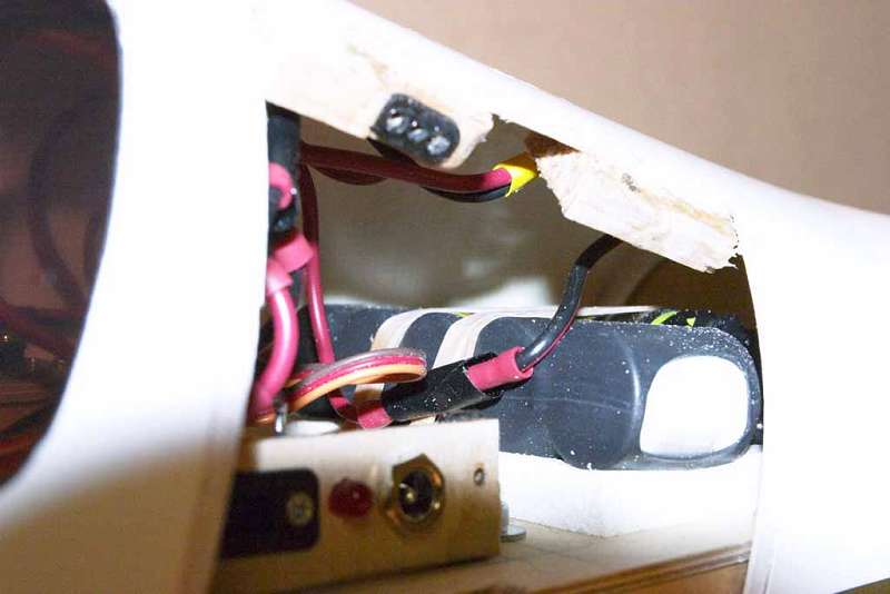

As I mentioned earlier, the final balance required only about 1/3 ounce. Here is a picture the battery compartment. The small jack and LED are for charging the on-board glow driver. The glow battery is aft of the reciver battery. All of this is mounted on the plywood tray you see here. The tray is mounted by clamps to two side rails that run from just behind the wing mount back to the first former. I have a toggle switch installed in the left door and a DuBro switch thingy for the receiver mounted on the right door. I elected to use a toggle switch so I'd never get confused as to which switch was which in case of an emergency. Inside the window you might be able to see the buzzer that is supposed to sound when there is power to the glow plugs. Mounted on top of that is an LED for the same purpose. Unfortunately, the Radio Shack piezo buzzer is not reliable.
That's about it for now. I'll post a picture with cowl in place when I reinstall it.

One other thing I did differently. Since the throttle servo is out of the way on the firewall I had room on the servo tray to use a separate servo for steering on an extra channel. My JR 8103 has the option of that channel not being affected by the trim tab so I can trim ground steering without affecting the rudder and vice versa.

Al's installation illustrates why I really want to try to install it "upside-down": with the exhaust up and the needles down. I just can't see having the needles sticking up out of the cowl. Has anyone tried mounting a Saito twin upside-down?

Thanks for the pics Al...nice setup. I see you cut open the hatch

Rick,
Don't you think the exhaust pipes might have to stick through the cowl somewhat?

I thought about mounting the twin upside down but the exhaust pipes won't clear. I flexed them as much as I dared on this installation. Given what Horizon Hobby charges for replacements I didn't want to press my luck. I have mixed feelings about the needle valves. Yeah, they sure stick up. But on the other hand, they are accessible unlike some of my prior projects with other engines.
I'm hoping that I can scrape up the $$$ to build a "Mark II" with the same hardware, replacing only the fuse and cowl. I think I can clean things up a bit. I learned a lot about working fiberglass with this project. I also discovered I could move the engine about 1/8 inch back and maybe 1/16 down. I think I won't have to relieve the intake manifold area if I make those changes. Also, I want to try to fiberglass the door opening as was suggested here earlier.
As near as I can tell, the only way to have a really clean cowl is to use a OS61. As much as I like that engine, I'm sooo tired of that two stroke sound.

Bob, seems to me I saw someone selling close clearance variable angle headers someplace... that's what I had in mind, thought from a quick eyeballing it looked like it might fit. I will check on the details and report back.
My question was prompted less by the clearance issues, and more about operational issues. Is there any functional reason that this engine wouldn't work as well the other way around?
