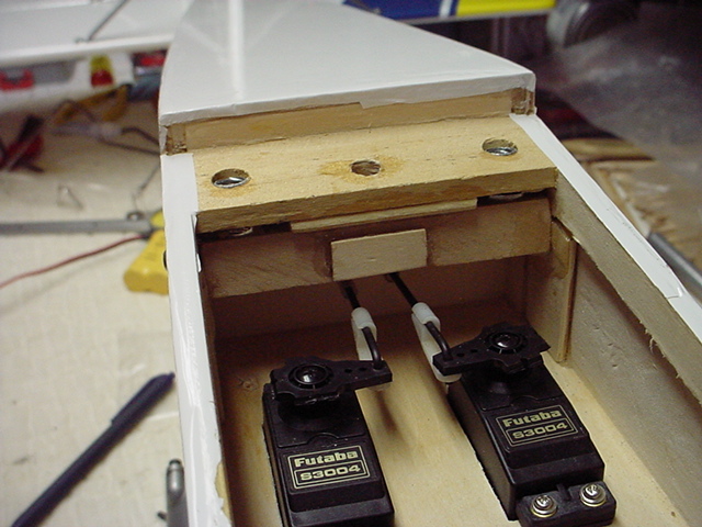

I just looked at the fuse on my son's Ultrastick. Not much room back there to mount the servos. Might can do it. Just make sure you have the room. I happen to like O.S. products, but hey, thats why we have different brands. Go for it. This really is a nice fun airplane. I really enjoyed windy days with mine. I would put the nose into the wind and just float on the wind. Then again, the flaparons are a neat functions to mess around with too. It's amazing what this thing can do. Enjoy.

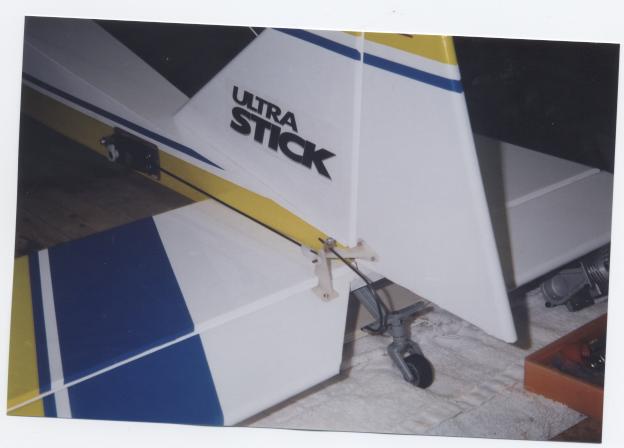

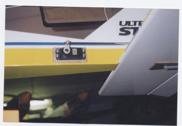

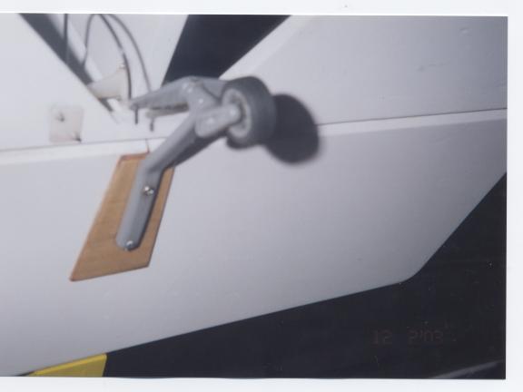

I've an Ultra Stick .40 with a four servo wing, elevator and rudder servo mounted aft, klett tail well asy. and a K&B .61 twister for an engine. It has great vertical, flies well in gusty wind conditions and a pure blast to fly. I put in a light weight Dave Brown engine mount, a 12 oz. tank and 3" wheels. It's an awesome flyer and rock solid on landing...in any wind conditions. We have been known to get some gusty winds here at our Pu'unana flying field...and the trade winds can be quite humbling to even experienced flyers. The Ulta Stick .40 handles the conditions very very well. If you use standard servo's and a 600 ma. to 1200 ma. nicad...even with a .61 bolted up front, the model will easily handle the weight. The model will build nose heavy...so toss out the engine mount given to you in the kit...and bolt what ever engine you use close as you can to the fire wall. This is not a trainer...it goes where you point it. With flap and spoiler (crow) action...you can land slow enough for the average sunday driver to handle. The model has no surprises, and is a sweet heart to fly. Your going to have a real blast with this model.

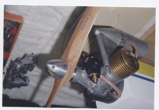

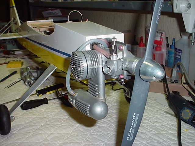

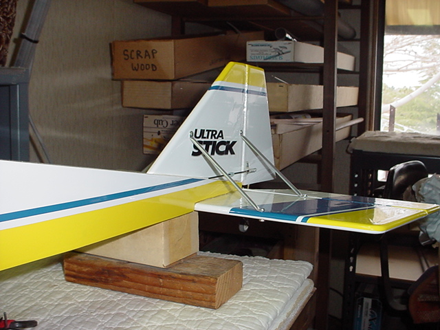

This is my second US 40....the wing flew off the first one. [X(]
I have a K&B .61 on a fibre mount, as close to the firewall as possible.
The K&B is light, and makes great power. The complete radio system
is mounted as conventional....1100 ma batt....balance is perfect, no
weight needed.
The rear wing hold down is beefed with a big hardwood block, and 3
1/2-20 nylon bolts....the wood is tapped.
The tail feathers are braced, because the stab glues on to the fuse
without a slot to fit into....very weak design.
The wing saddle is doubled up, and wing saddle tape is used. The wing
has to be tight, and not allowed to vibrate, or it will burn the front dowels
off....literally. Look closely at the front dowel holes....there is a doubler of
ply in behind the stock plate....with metal washers glued on as well
Dave.

Well, that proves there is room to mount the servos in the tail. See Dart, RCU gives you all the info and examples you could hope for. Do you guys share ifo like this on the racing circuit? Flyboy Dave and Bob, nice pictures. Flyboy did sometihing I didn't do and thats reinforce the dowl plate. Nice work to both.

I just finished my 40 ultra stick. I put an irvine 53 on it. I put aluminum tubing over the dowel rods and swaped out the metal mount for a dave brown. I didn't add any tail weight. It balanced 3.5" back. I was a little surprised at how heavy the thing felt though. I haven't weighed it but I'm tempted to ask a grocer or postal worker to weigh it. I have a 1400ma rx battery in it which adds a little extra weight I'm sure. I'm a little dissapointed with the verticle performance on it. I'm coming off an avistar that had an os46 with a tower muffler that had better verticle than my stick - seriously. I'm going to put the tower muffler on the stick and see what happens.
