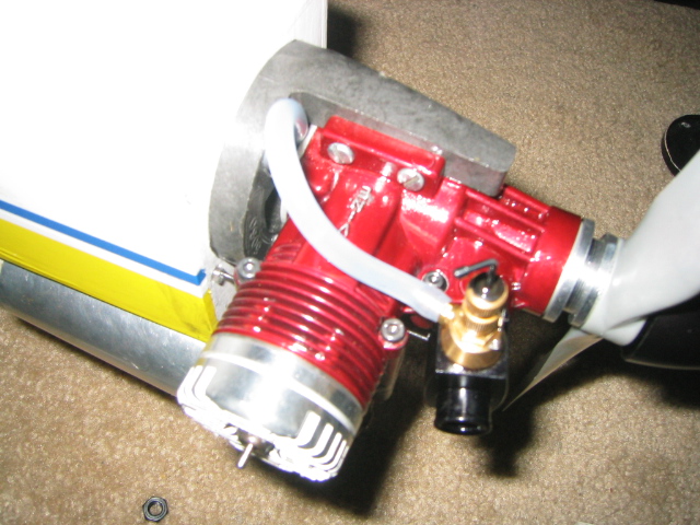

I don't either but It would be nice if it out performed my trainer - disappointing.

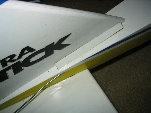

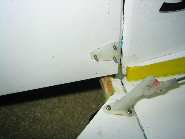

I also had to reinforce the elevator where the tailwheel assembly goes in front of the verticle fin.
Another thing I did was put triangular stock on both sides of the verticle fin. I used plenty of epoxy but the thing felt flimsy. It feels pretty rigid now.

I'm hoping that my engine will get a lot stronger after a few more flights when I can lean it out a little.
I think what I added is less than the difference in weight in the two mounts.

I'm not that familiar with the Irvine 53 so I thought I would check it out to see how it compares to the 46FX. Doesn't look like much more engine when you consider the weight. This may explain why you aren't seeing a noticeable difference in the performance. Maybe it just needs to be run for a while and you might want to look at different props.
Irvine 18.2 oz. W/M, 1.7 BHP, 8.59 cc
46 FX 16.45 oz. W/M, 1.62 BHP, 7.45 cc
BTW, I think it was wise to reinforce the verticle stab. I notice on my son's Ultrastick that the epoxy had given way towards the front so it slips up and down just a bit. Not good. We will have to do this over before the next flight. Not much wood back there to bite into.

Yes I knew the HP increase was marginal, but from what I've read here, the 53 is supposed to have much more torque. It does have a much longer stroke. It's my understanding that a longer stroke gives more torque. It's obvious from just looking at the irvine that it looks "taller". I guess the plane is just too darn heavy. I tried it again this evening with a tower muffler and still it doesn't perform as my avistar with a 46fx and tower muffler vertically.

Thr Irvine spins an APC 12-6 or 13-4 prop. That's more than a 46fx (12-4 if you're lucky). The Irvine has more torque, maybe you justdon't have it tuned right since it's new. I have one on a Magic Extra 300 and it pulls it vertical with ease. It's a little lighter than the US40 but still, you should see more than the 46fx. Also the Irvine is not any heavier than the 46fx. Irvine claims 400 grams which is 14.28 ounces. I assume no muffler. The 46FX is 16 ounces with the muffler. So it's equal in weight. A longer stroke gives more torque, especially at lower rpms. BTW I have the US40 with a 46FX and I use an APC 11.5-4 prop.
What prop are you running on the Irvine?

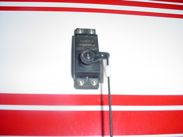

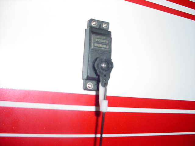

You don't need a reversing "Y'. What it does is when two servo's are
hooked together....(y-ed)....one servo works in one direction, and the
other one in the other direction.
That's what it says in the directions, if you want the servos mounted
with the arms sticking out to the sides, like pictured in the instructions,
you will need to use the reversing "Y".
However you can mount the servo arms this way, and save the expence
of the reversing "Y" wire connecter. Mount the flap linkage straigt, like this....
instead of to the side. I have done this on 3 Ultras....it works fine.
You will still need a regular "Y" connector to hook the flap servos
together.
Dave.

Where on the plane is that photo? I am a lil confused. Sorry guys.
