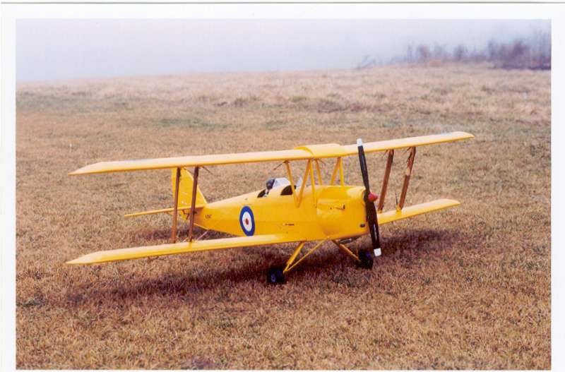

Here's a picture of mine.
Old 01-29-2004 | 09:40 PM
Joined: Feb 2003
Posts: 522
From: Rockwall, TX
Default RE: GP Tiger Moth and Spins.
Man that looks great. I'm not crazy about the GP trim, and I only hav about 6 flights on mine. The maiden on mine was real harry, more because of my skills than the airplane. I have a post on here about my maiden flight.

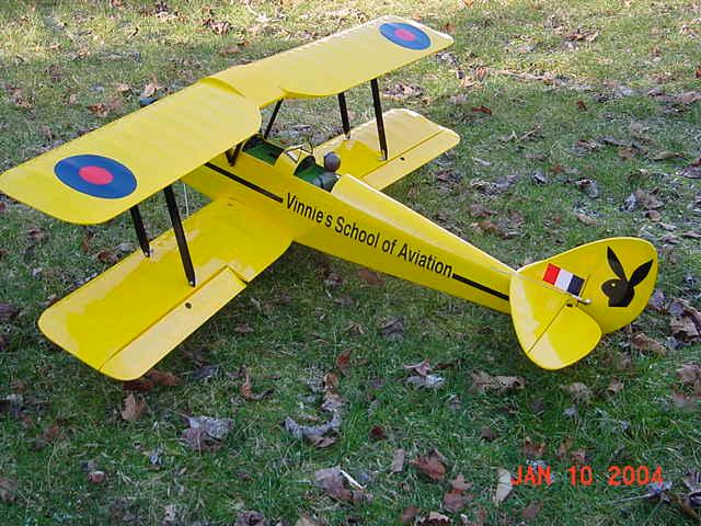

Waiting for Spring.
Old 01-30-2004 | 10:27 AM
Joined: Feb 2003
Posts: 522
From: Rockwall, TX
Looks good vinnie, I left mine real plain becase it is my third airplane, first biplane and the second for me to maiden. You can read about it here:
