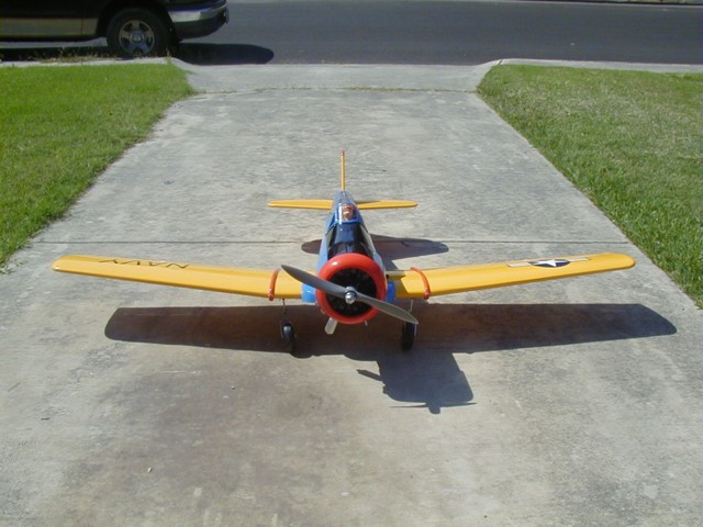

ChopperDude, I have mine the other way, leaning toward the left with the muffler pointing straight down. I'll look for some pics to post.
Old 10-07-2004 | 08:06 PM
My Feedback: (17)
Posts: 2,106
From: San Antonio, TX
Default RE: H9 AT-6 Texan Engine Mounting
Here you go. Notice the muffler pointing almost straight down.
