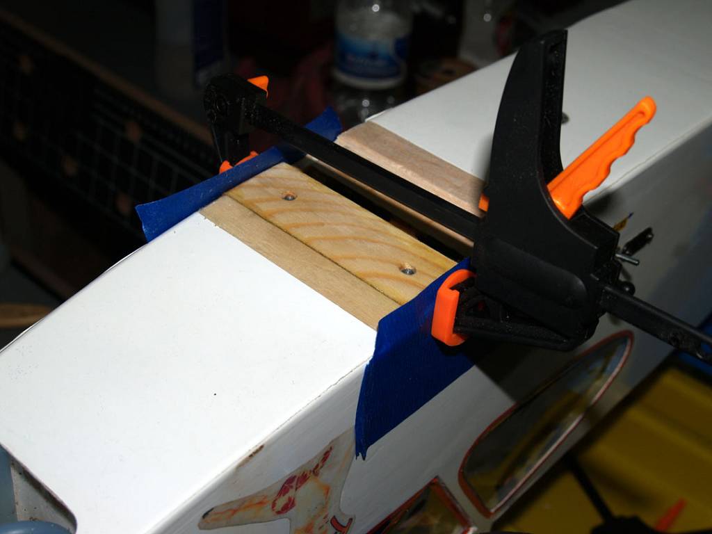

Re the landing gear reinforcement: I got caught by the 20+ MPH winds at Rabbit Lake, CA and it took my Rascal sideways for 100 yards it seemed, slamming the landing gear hard enough to actually bend it inwards but it did not pull out of the fuselage at all. I did get damaged wingtips and had to clip the wings.
Re the landing gear again: A couple years ago I had an off runway engine out dead stick landing at takeoff, and the plowed dirt field I made a superb landing on, ripped the landing gear clean out of the fuselage.
But it is repaired and still a good flying airplane.

I did exactly the same repair on the landing gear. My original Rascal 40 I gave to my son. I missed flying it so much I bought a new one powered by an OS 52 4 stroke. I really love the RascaL 40. The only other modification I made was to replace the aluminum motor mounts with steel.
