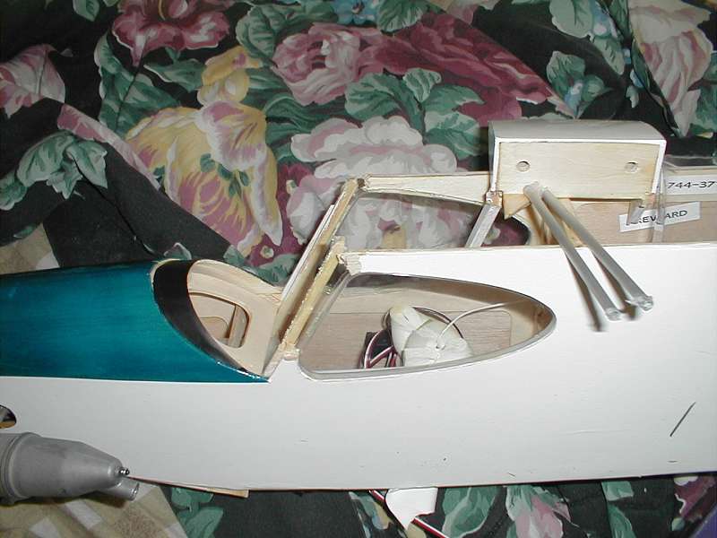

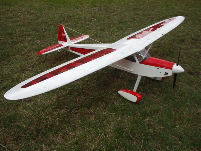

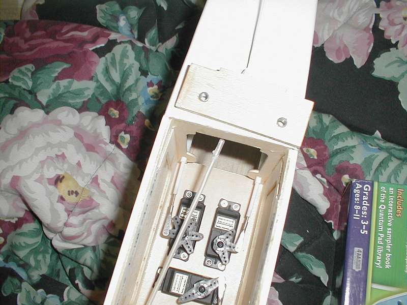

Have inverted mag 52 4 strk in mine, throttle was fun made up with a bellcrank arrangement bending a U in the throttle rod would have been quicker. I mounted a ply plate inside
the fus aft of the landing gear and have an aluminium brace going to it it forms about a
45 degree angle between the gear and fus no wheel pants larger wheels for grass strip
Just for hoots I put in an FMA co pilot it sits on a pylon just back of the wing sort of looks
like a little radar dome it is aligned with all flight surfaces . the whole thing bolts on for
easy removal and no wires hanging on the wing. Fred marks at FMA thought it was a pretty
neat installation When removed a little ply plate overs it
Also tail feathers attached to a ply plate and are removable

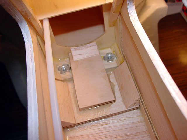

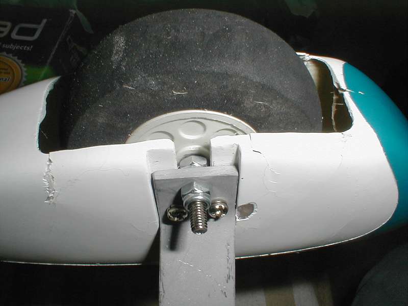

Hey guys, after a month of doing another project I finally took the Rascal out of the box and laid the parts on my table. The covering had some wrinkles (expected) and so I spent some quality time massaging the covering with my iron and heat gun. Covering came out perfect! I only screwed up one itty bitty spot on the vertical fin where the trim pulled away slightly (the white over blue part) but I will be able to touch it up.
I was thinking about the landing gear reinforcement that has been talked about. I looked at the existing setup and it has some triangulation pieces already glued in place. Is this something that is an update over the earlier models or is this still the weak spot that needs to be beefed up even more?

KMOT - reinforcing is your option . if you do a hard landing the gear may pop out . if this happins then you glue it back in with reinfoecment . do it now or doit later . to do it now just push out the blind nuts and install a 3/16" ply over what is in there . drill holes for blind nuts . don't install blind nuts yet . this is what i did . on the bottom outside i added a 1/8" ply 5 1/2" X 3 1/4" with one side covered . ( care is needed to get the courve on the bottom you will need to adj. clamps .to hold in place for the epoxie tp o set . after the glue is set from the top drill down throu 1/8 ply . then reinstall blind nuts . GOOD LUCK BILL WRC-FLYER

wrcflyer: thanks for the reply! I have an understanding of how to reinforce it if needed. I was just wondering if the picture of mine shows any difference in the factory assembly compared to the guys whos gear ripped out.

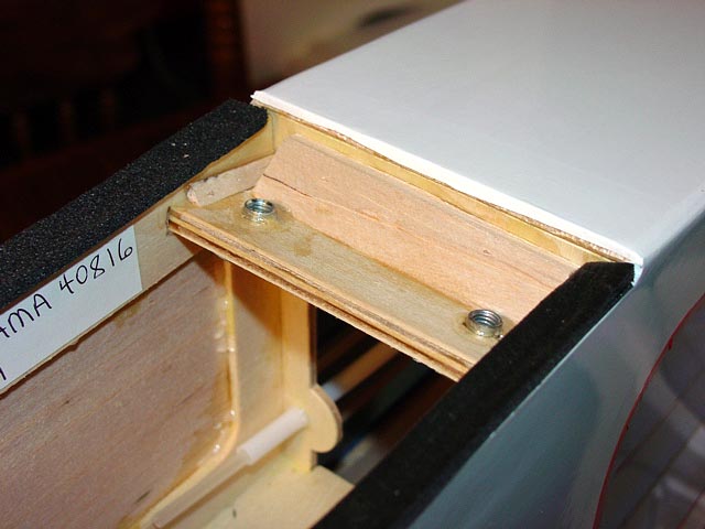

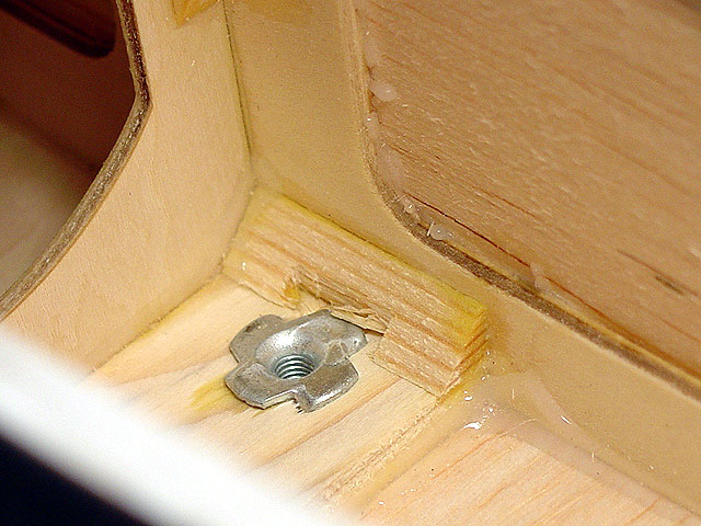

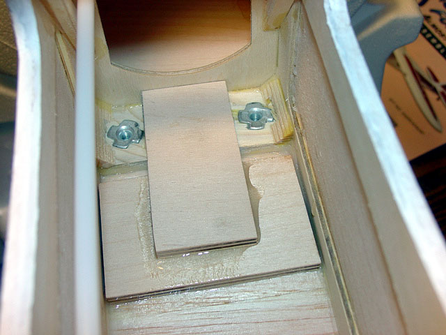

Alright, I have reinforced the landing gear block. I cut a piece of 1/4" Sig plywood and epoxied it on the floor directly behind the factory block. Could not butt it up due to the hot glue squeezed out of the original pieces so just got it as close as I could and have it fully flat on the floor. Oh, I did try cutting the hot glue first and only succeeded in cutting the balsa... I then epoxied another piece of plywood across the two floor pieces which results in tying the factory block to the secondary block and the fuselage former. Then I added 1/2" tri-stock in three places so it should be plenty solid. But wait! There's more!
When I install the gear I will use long bolts and then use a metal plate across the two bolts and locknuts to hold it down on the plywood doubler and then it will definitley not be going anywhere, lol.

KMOT . looks good what you have there . it will help a lot . i also added a 1/8 ply 5 1/2" 3 14" to outside under the belly of the plane covering the landing aera . the ply extends 3 "ahead of the bolt holes . this gives you even more beef. put covering on one side be-for you epoxie it on .you need clamps to hold the ply . it has to bend to conform to the bottem. PS throw that sig tail wheel . replace it with a sullivan tail wheel . those springs for stearing arn't to good . with the sig wheel the plane is real squirrely on take-off un till you get the tial up off the ground. GOOD LUCK YOU WILL LIKE THIS PLANE flys fast needs a lot of runway for landing . it's a floater . BILL WRC-FLYER

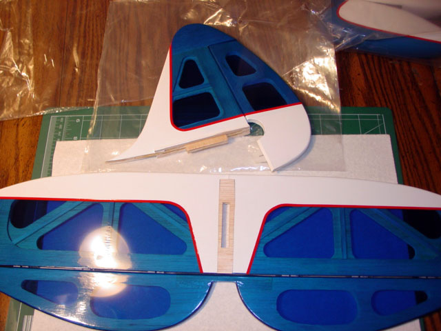

OK, I took care of business. I added tri-stock and epoxied it into place. I trimmed one edge of the tri-stock to make clearance for the top of the fuse and conveniently made mini tri-stock in the process which I used on the sides and glued in with thick CA. This support plate should not be going anywhere now. Thanks for the heads up Skribnod.
