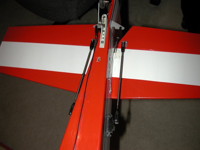

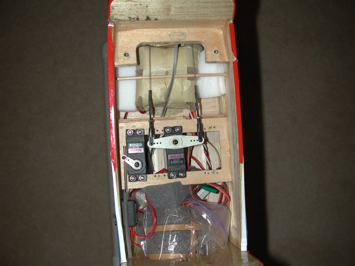

Another thing that bothers me about the current setup is that I hate the "Y" push-rod on the elevators. I don't think they're very accurate and I feel like there can be play between the elevator halves as the push rod wiggles left to right. I've ordered two HiTec HS-85 BB mini servos and I'm going to put them in the rear of the plane, one on each elevator half. They are the smaller servos and only weigh .70 oz. each, but still have 40+ oz. torque (with 6 volt battery) and should easily handle one half of the elevator. By doing this I can assure the elevator halves work together and the "Y" push-rod is not moving side to side. I've already checked the CG with the weight in the tail and it will be fine.
I'm also considering adding a pull-pull control to the elevator because my elevator control does not center very accurately with the lame push-rod that it currently has.

Yea, those push rods suck. I replaced the wood dowel with some salvaged carbon kite rod. It still has a tendancy to move left-to-right though. I tinkered with the wire bend angles until I was satisfied.
Your dual servo set-up will be awesome. You might as well do a pull-pull on the rudder while your at it.

I've heard some folks will mount a guide in the fuselage to keep the Y end of the pushrod from moving around. Might do the trick with less work.

That certainly would help and may do the trick, but will still require me to cut open the fuse and there's no guarantee that the geometry of the "Y" push-rods will be accurate. With two servos I can use my radio to fine tune the throws and have precise control over them. It's probably overkill, but what the heck
BTW, I saw on another thread last night a gadget that is supposedly used by pattern guys to keep the split elevator throw accurate. Looks cool, but since the plane is already built it would probably be even harder to install than two servos.

Well, I went the whole nine yards and installed both rear elevator servos and a pull-pull system for my rudder.
The improved fine tuning accuracy I have is like night and day over using the "Y" push rod. Using two Great Planes deflection meters, one on each elevator half, I was able to get the elevators working perfectly together both at the end-points and at every point in between. And there is NO play or give in the elevators what so ever!
On the elevators I ended up using two HiTec HS-85 BB mini servos which weigh .70 oz. each and have a torque of 41 oz. with a 4.8 volt battery. This adds only 1.4 oz weight to the tail and gives me 82 oz torque on the elevator (Way Overkill for this plane
I used 5.5" 4-40 titanium push-rods (threaded on both ends) and and 4-40 clevises. This is also way overkill but my LHS didn't have the 2-56 versions. Initially I was going to use very short push-rods and mount the servos under the horizontal stab, but the guy at the hobby shop talked me into using the 5.5" rods to move the servos up the fuse to reduce the amount of weight I would be adding to the tail and it also allowed the servos to fit in the fuse directly across from each other since the fuse is thicker further up. I'm happy that I took this approach. The extra distance between the servos and control horns doesn't hurt the solid control in the least.
BTW, the entire modification only moved my CG back 3/16" to 1/4" from where it was initially.
On the rudder I added a 2-56 pull-pull system. This was my first pull-pull to install and I'm really happy with it. Now my rudder centers right on the money!
Doing this was somewhat a pain, but the truth is that now I can know with full confidence what my control surfaces are doing. By continuing to work out tracking issues without knowing what the surfaces are doing in the air I could have wasted a lot more time.
Flying Results:
I've only had two flights on the plane since the change, but I can say for sure that it definitely tracks better. At this point I don't have enough flight time to be sure if I want to do any further modifications. It still fell off to the left coming over the top a little, but it was controllable with rudder. Honestly I'm not sure yet how much was me, the wind or the natural behavior of the plane. I need some more flight time to decide if I want to play with changing the thrust angle or CG. Also, I want to be careful not to effect the normal straight tracking of the plane if it is normal for this plane to fade left over the top. An IMAC pilot I spoke to this weekend said that he always has to apply some rudder corrections coming over the top to keep his plane perfectly straight. I'm not sure if this is normal or not.
BTW, after trimming and landing the plane all my controls, including rudder and ailerons were almost perfectly centered. I think it's pretty straight now.
Here are some pictures of my modifications, by the way I haven't cleaned up the old push-rod holes yet, didn't have the right shade of white covering
).I used 5.5" 4-40 titanium push-rods (threaded on both ends) and and 4-40 clevises. This is also way overkill but my LHS didn't have the 2-56 versions. Initially I was going to use very short push-rods and mount the servos under the horizontal stab, but the guy at the hobby shop talked me into using the 5.5" rods to move the servos up the fuse to reduce the amount of weight I would be adding to the tail and it also allowed the servos to fit in the fuse directly across from each other since the fuse is thicker further up. I'm happy that I took this approach. The extra distance between the servos and control horns doesn't hurt the solid control in the least.
Flying Results:
