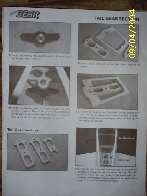

On another note... Can anyone snap a picture of the rear frame assembly for me??? I've been ablle to put most the plane together with literaly no pictures in the instructions, but I just can't figure the rear ply frame assembly out for the life of me!!
#343
Can't figure my scaner out, so I took a pic of the manual. Mabey someone else can do a better job at this. Hope this helps in the mean time.

Thanks for the pic of the instruction manual apsf4u!!! That really helped! Its deffiatly more of a challenge assembling this plane without pictures.....Kinda like a big jigsaw puzzle. Anyhow I've got it all sorted out now. I guess I'm going to use a different motor mount and put the YS 91 inverted....then iit wil be all ready for the 110 when I can get one..
Any reason not to use a hard mount on this plane?? (maybe having to do with it being fiberglass).. I've got several that will work, but no softies...
