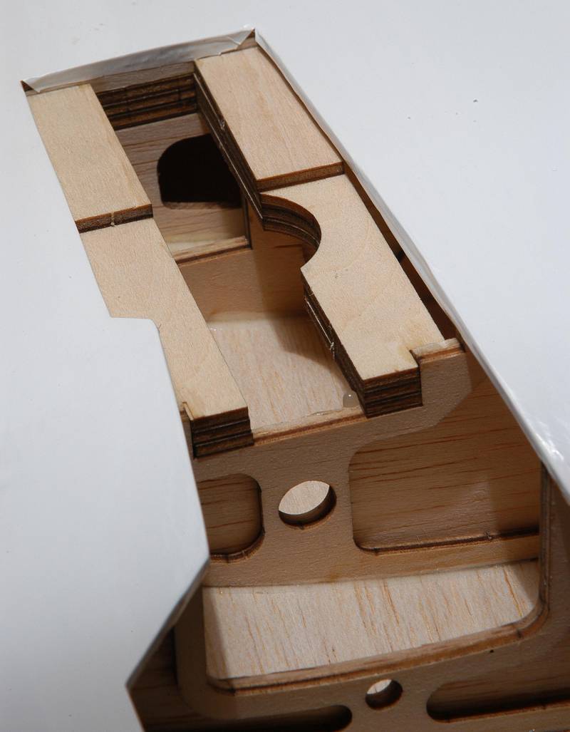

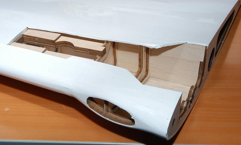

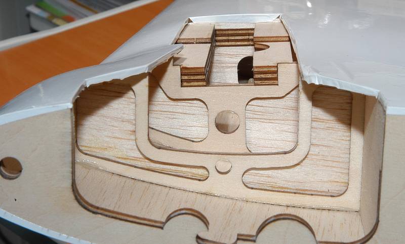

Hi , these are 4 pic from my R.B.
I am going to treat the hole system with medium Cyano, before fit the landing gear.(any place i can)
Do you think that i have to re-enforce it more (with some fiberglass and epoxy) ? It looks strong enough
but i have read some thinga about it.
I have allready fix the the stab ,using longer and thicker CF 8/6 mm.
Best regards
Argiris

Medium CA isn't enough. You need to review the earlier sections of this thread for recommendations on how to reinforce the langing gear mounts. I did the same mods that Vampire recommended and it still wasn't enough for my field. I peeled the gear mounts out of my RB several times and then grounded the plane until I could fabricated proper mounts. Since installing my new gear mounts I've put about 75 flights on it without a single gear mount failure.
[link=http://www.rcuniverse.com/forum/m_1665626/mpage_18/key_/tm.htm#]Vampire's Gear Plate Mod[/link] Go to Post # 439.
[link=http://www.rcuniverse.com/gallery/galleryCat.cfm?memberID=136718]My Gear Plates and Tail Mods[/link]
Rich

Hmmm, this appears to be beefed up considerably since the first version most of us have, anyone know for certain that even this new (look at the triple layers) design still doesn't work out-of-the-box?
Jack

two layers are fine PROVIDED that they are SECURELY attached to the joining ribs with, perhaps, interlocking wood.
but if they are not interlocking, then ya had betta reinforce them to the ribs with glass cloth and epoxy or else, even with 4 layers, they'll rip out. include the wing's leading edge and the ribs all the way back to the spar in the structural strungthening because that is where the tortional forces end up transfering to upon landings.
